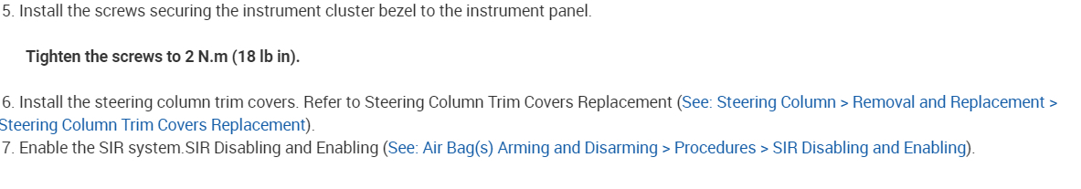

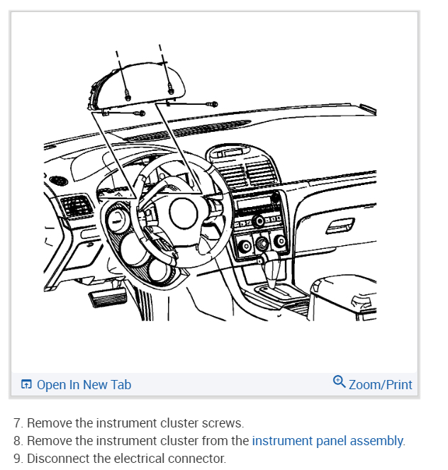

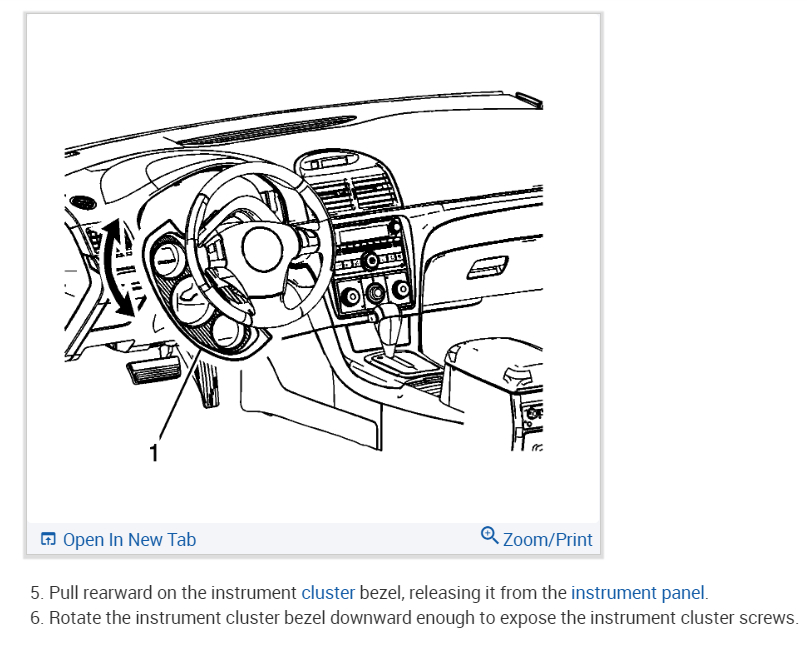

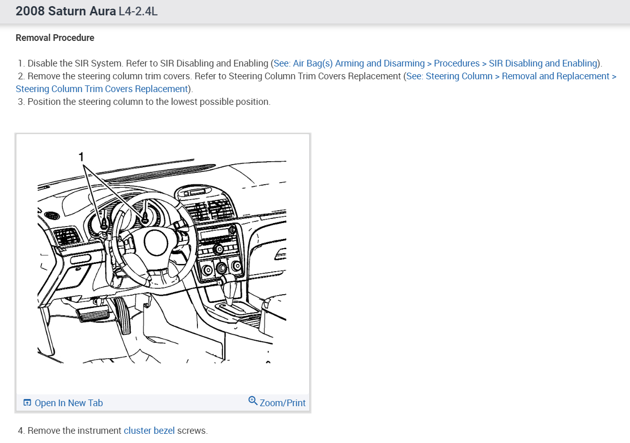

This is common when the cluster goes out. Here is a video of the job being done on the similar car with diagrams below to show you how on your car:
https://youtu.be/_HEC44xENxw
Oct 19, 2019 at 11:33 AM
