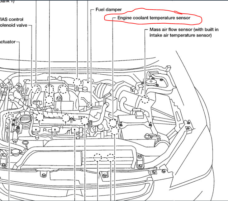

Hello again.
No, that is not normal.They first thing I would have checked or replaced is the coolant temperature sensor.Here are a few tutorials showing what is involved for its function and replacement:
