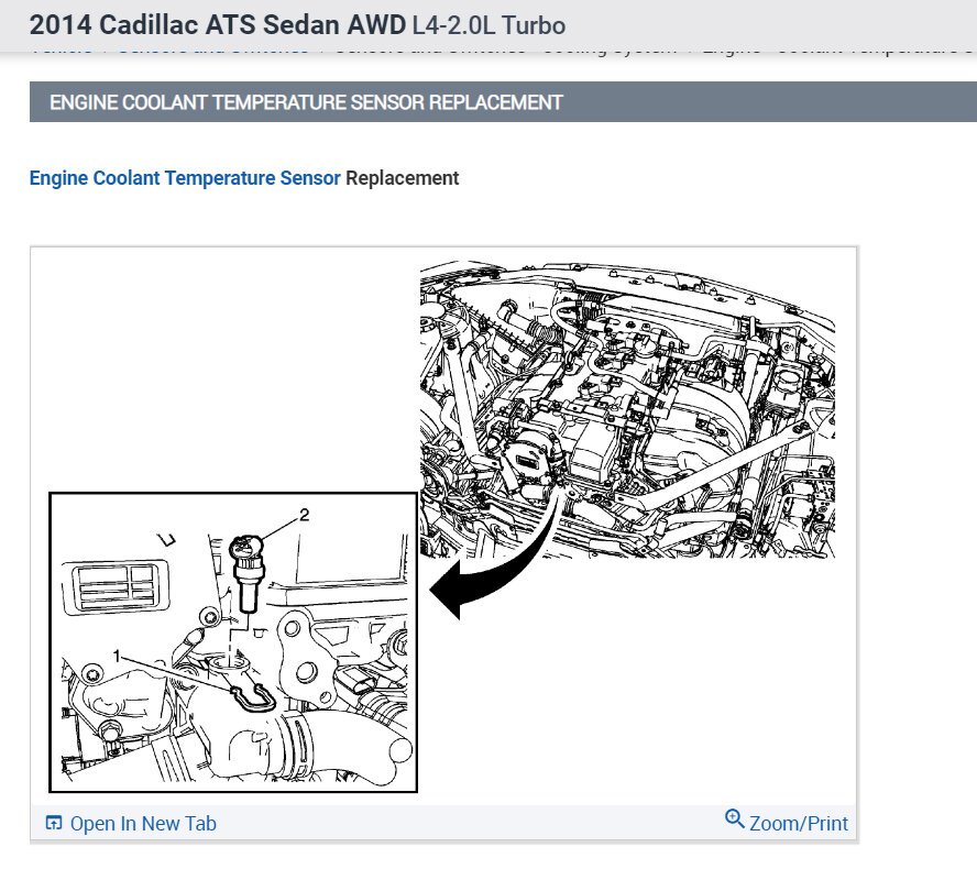

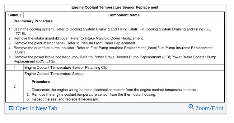

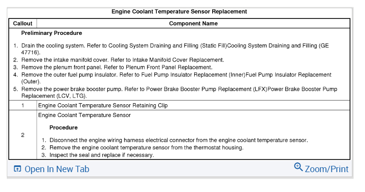

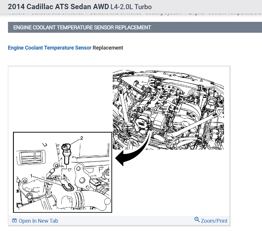

Replacing temperature coolant sensor. Removed wiper assembly, braces, cannot find this! Terribly frustrated. Can you send me a pic of where it is?
May 22, 2023 at 12:21 PM
It looks like the coolant temperature sensor or CTS is located by the thermostat housing, here are instructions and the location of the sensor in the images below. Check out the images (below). Please let us know if you need anything else to get the problem fixed.
