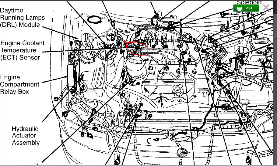

It sounds just like your ECT (Engine Coolant Temperature Sensor) is not working. No need for an additional gauge.Let's fix yours. Here is a tutorial showing what's involved:
I've attached a picture below showing its under hood location and circled it in red.Hope this helps and thanks for using 2CarPros.

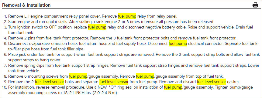

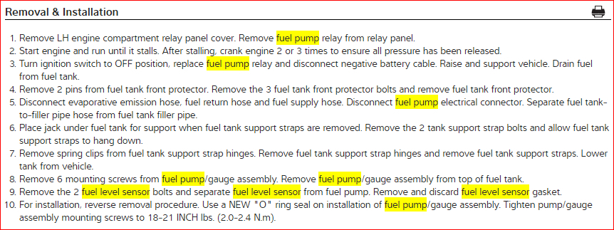

It sounds like the fuel gauge sending unit is giving you a problem.The sending unit and the fuel pump are a complete assembly are are mounted inside the fuel tank.You will have to drop the fuel tank to gain access.Here is a tutorial showing the procedure:
I've also attached below a picture of step-by-step instructions for your vehicle.Hope this helps and feel free to ask any more questions if needed.Thanks again for using 2CarPros.
