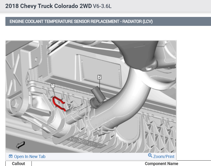

Just replaced the thermostat and battery and worked fine for a couple weeks. Now doing it again, motor does not seem to be getting hot.
Oct 2, 2022 at 8:27 AM
This happens when the radiator coolant temperature gauge sender goes out or is off. Here is the location and replacement instructions so you can change it out. Check out the images (below). Please let us know what happens.
