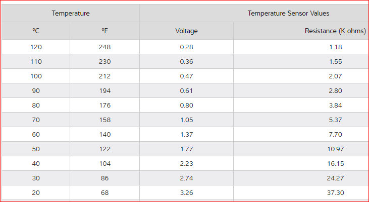

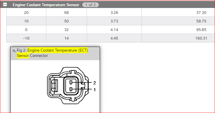

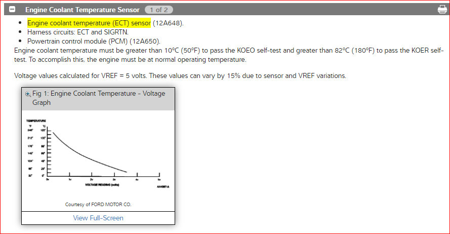

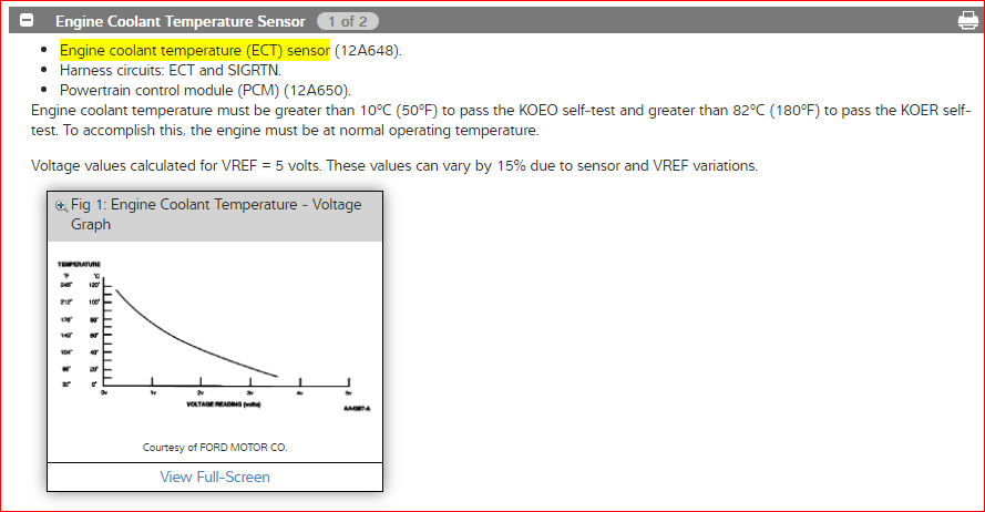

So the coil pack was cracked. New pack, wires and plugs no more rough issues. The temperature gauge still does not work even with a new thermostat. No codes. How do I test the sensor for the gauge?
Sep 19, 2018 at 4:32 PM
DANNY L
  • 5,648 POSTS
Hello again.
I have attached a diagram for you. You can use a volt meter to test the coolant temperature sensor. It is located on the right side of the lower intake manifold. Hope this helps and thanks again for using 2CarPros.

Thanks but unfortunately I am not able to locate the sensor. Would you happen to have a picture or diagram where it would be?
Sep 20, 2018 at 4:16 PM
SMB985
  • 6 POSTS
Our local Library does not have a repair manual for this vehicle.
Sep 21, 2018 at 7:26 AM
Hello, At ECT sensor harness connector. - Component Location: Right side of the lower intake manifold: Here is a guide that will help you step by step to replace it:
