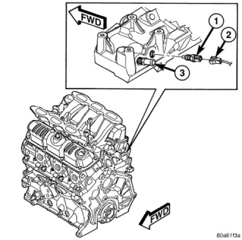

If you feel the sensor is the issue, here are the directions specific to your vehicle for replacement. The attached pics correlate with the directions.
___________________________________
2007 Chrysler Truck Town & Country V6-3.3L VIN R
Removal
Vehicle Sensors and Switches Sensors and Switches - Cooling System Engine - Coolant Temperature Sensor/Switch Service and Repair Removal and Replacement Engine Coolant Temperature Sensor Removal
REMOVAL
3.3/3.8L
pic 1
Figure 1 Engine Coolant Temperature Sensor
pic 2
WARNING: Hot, pressurized coolant can cause injury by scalding. Cooling system must be partially drained before removing the coolant temperature sensor.
1. Drain cooling system below engine coolant temperature sensor level.
2. Remove power steering reservoir and position aside.
3. Remove ignition coil and bracket.
4. Disconnect coolant sensor electrical connector (Figure 1).
5. Remove coolant sensor (Figure 1).

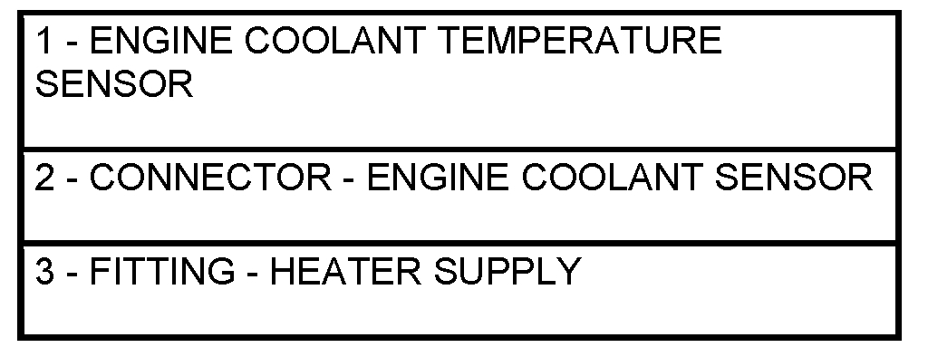

INSTALLATION
3.3/3.8L
pic 3
pic 4
1. Install engine coolant temperature sensor (Figure 2). Tighten sensor to 7 Nm (60 in. lbs.).
2. Connect electrical connector to sensor (Figure 2).
3. Install ignition coil bracket and coil.
4. Install power steering reservoir.
5. Fill cooling system.
