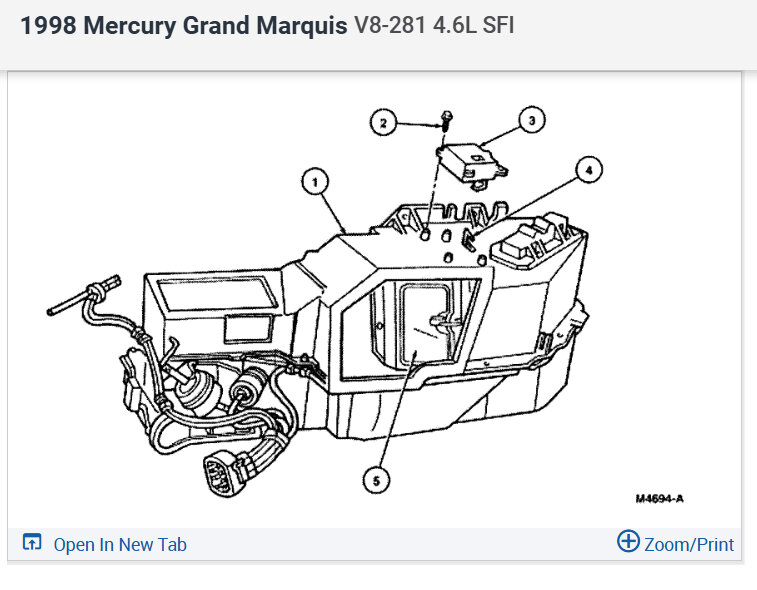

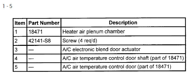

I would remove the temperature blend door actuator to move the pivot by hand to make sure it is not bound up. With the actuator off of the HVAC plenum but still plugged in, move the controls to see if you can get movement. You may have a defective part, here is the location of the unit so we can be on the same page, there is no fuse for this, just for the HVAC system which the rest seems to be working? Also, make sure the little vacuum lines under the hood going to the HVAC system are intact. Check out the images (below). Let us know how it goes.
