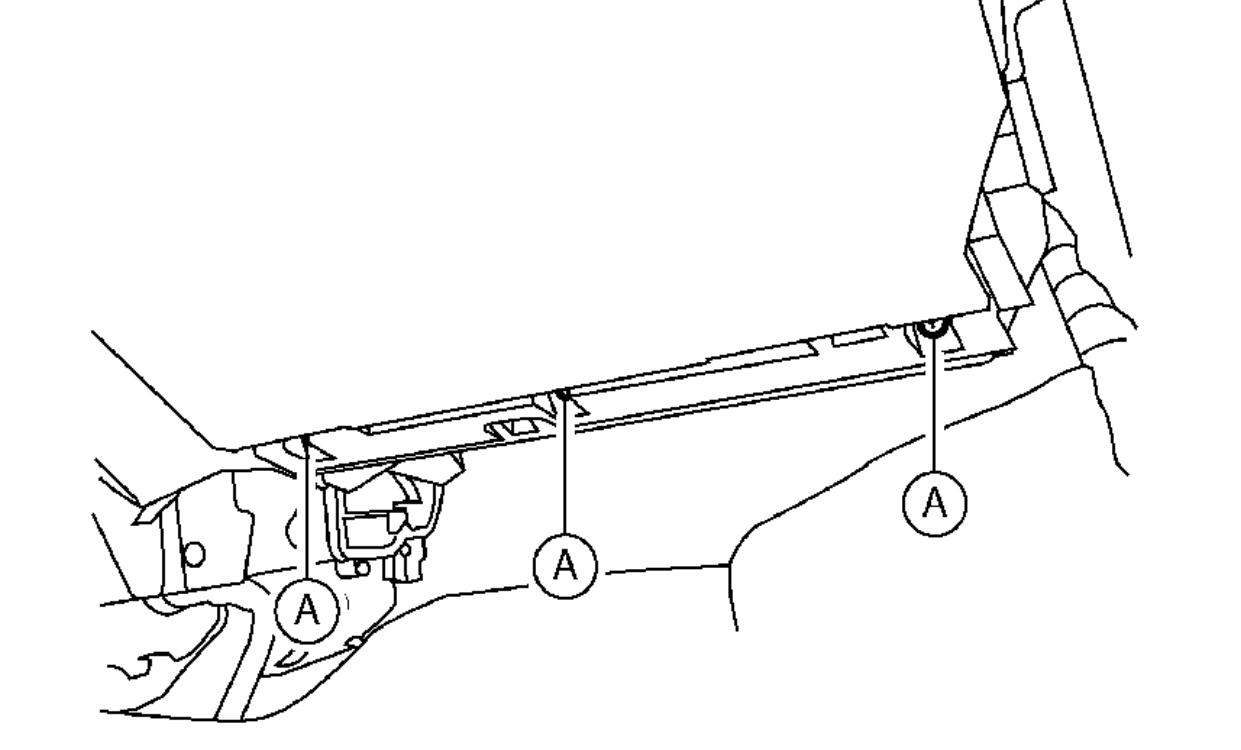

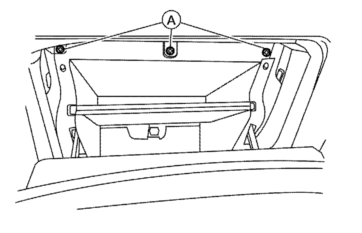

Okay, this should be straight forward then. First you need to remove the glovebox compartment. This can be done by removing the three screws on the top (See image 01) and the three screws on the bottom (See image 02). The motor should be clearly seen after this.
