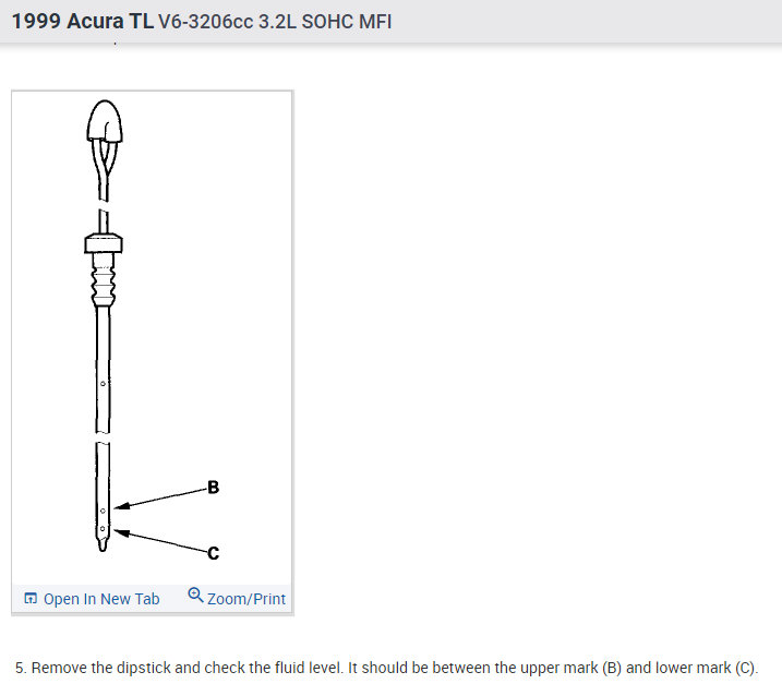

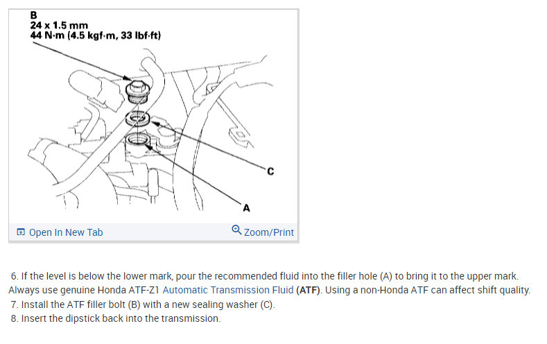

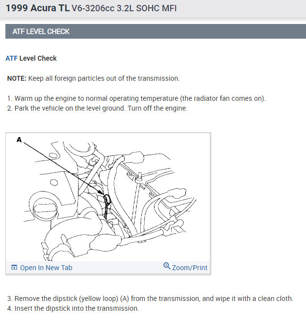

Anytime you have issues of the transmission shifting issue, check the fluid.
If the fluid level is low or dirty/contaminated, it could make the transmission have shifting issues.
Make sure it is a the correct level and in clean/good condition.
When you check the fluid level, make sure that the vehicle is level and the engine is at operating temperature.
https://www.2carpros.com/articles/automatic-transmission-problems

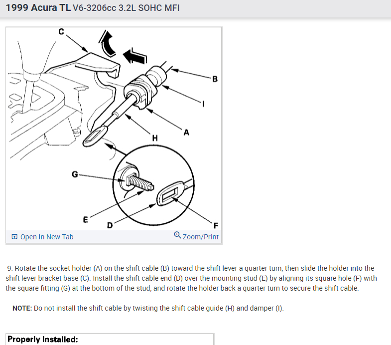

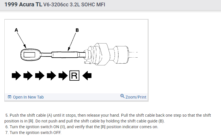

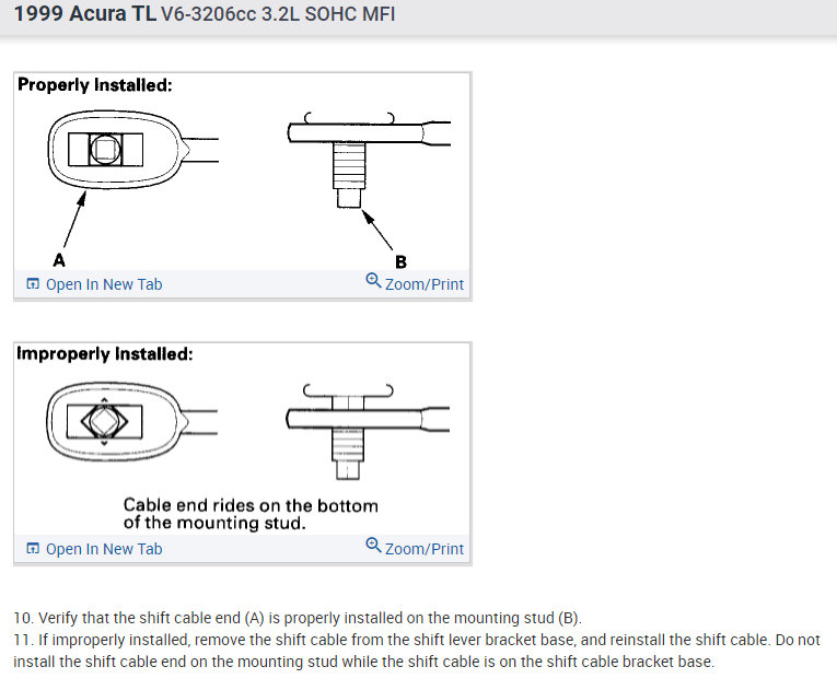

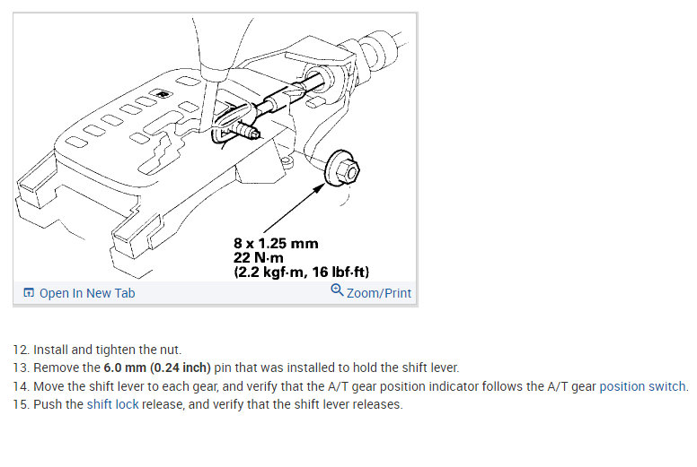

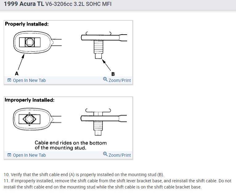

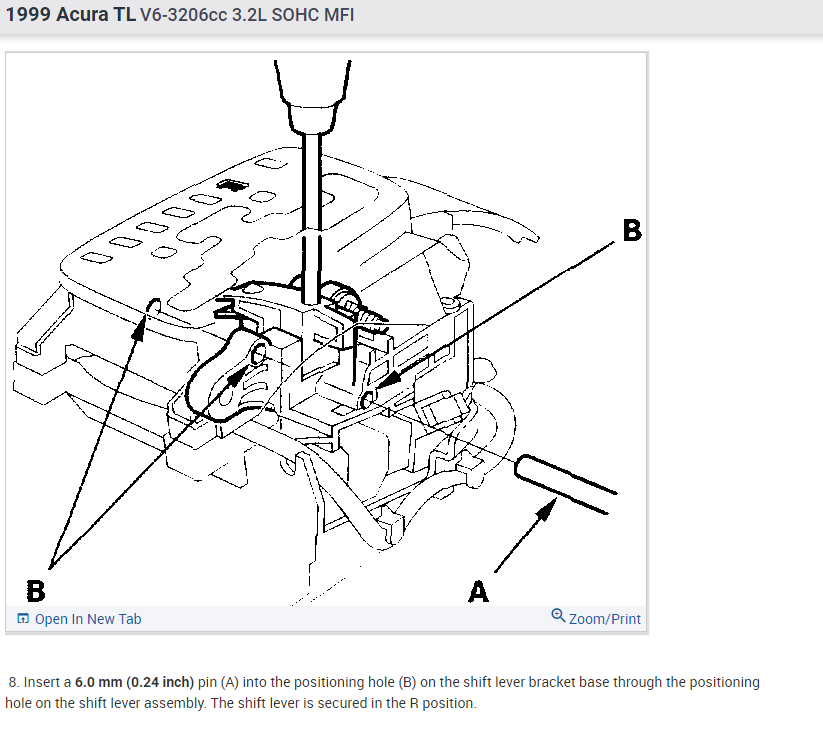

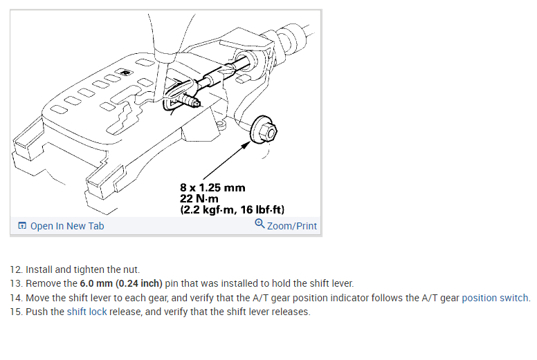

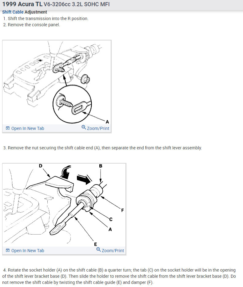

This could also be due to the shifter cable not selecting the reverse when you move the shifter lever to the reverse position. This could be due to a stretched cable and just need to be adjusted.
I have attached the fluid check and the shift cable adjustment procedure for your reference.
