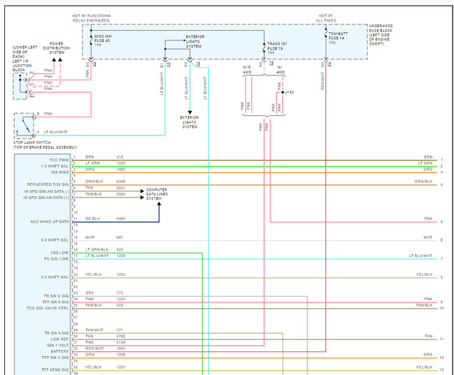

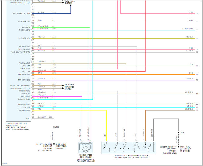

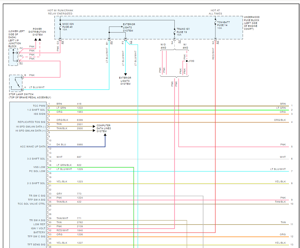

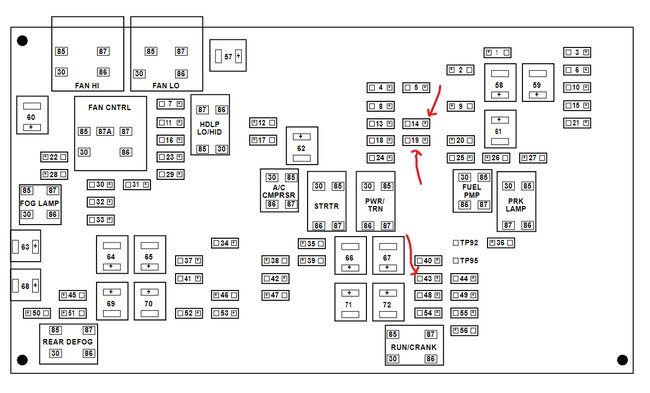

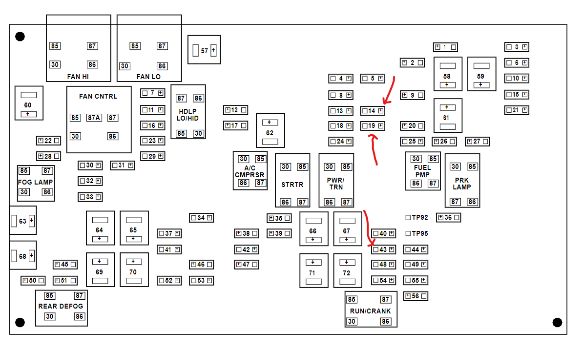

Okay, the first thing we need to do is check the power leads to the TCM. so, please use this guide to check for power and to make sure the fuse is good at the under-hood fuse panel: MISC IGN fuse # 43, TRANS IG1 fuse # 19 and TCM BATT fuse # 14.

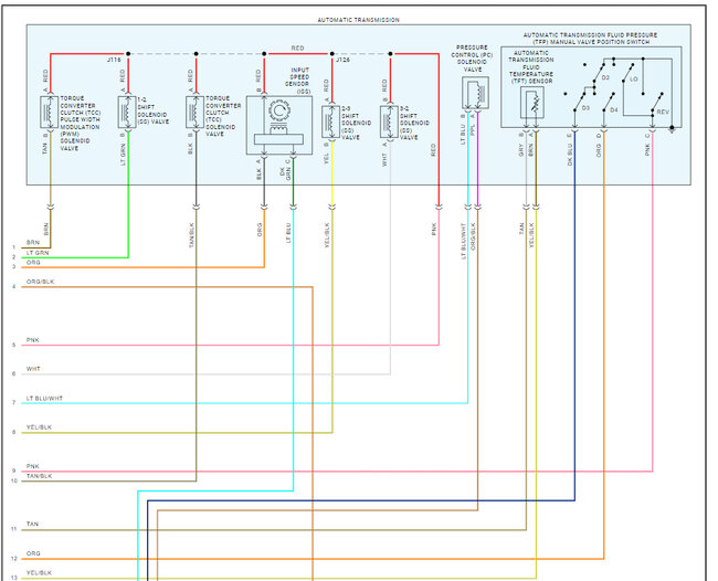

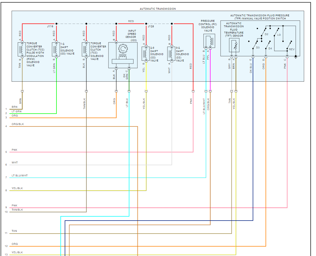

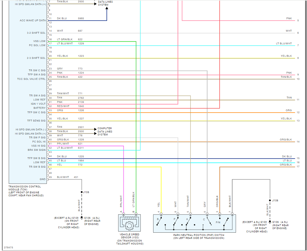

Please test with the key on, if the fuses are good let's test the TCM ground G103 which is on the right rear of the cylinder head. Here is a wiring diagram for the TCM so you can see how the system works and the fuse locations below. Check out the images (below). Please upload pictures or videos in your response for the problem so we can see what's going on.
