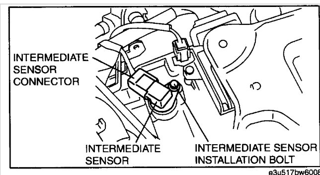

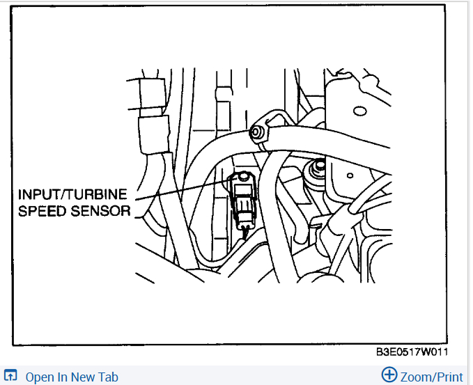

The P0715 code indicates an issue with the Input/Turbine Speed Sensor Circuit. The resistance seems too low for the pulse generator, it should be 500 to 1,500 ohms. You must a defective part. I would get another one and try it, also clear the codes once the job is complete. Please start new questions for the other issues the car has, here is the locations of the input shaft sensor (two wire) so we can be on the same page. You may have a weak intermediate sensor as well. Here is that location as well. Check out the images (below). Please let us know what happens.
