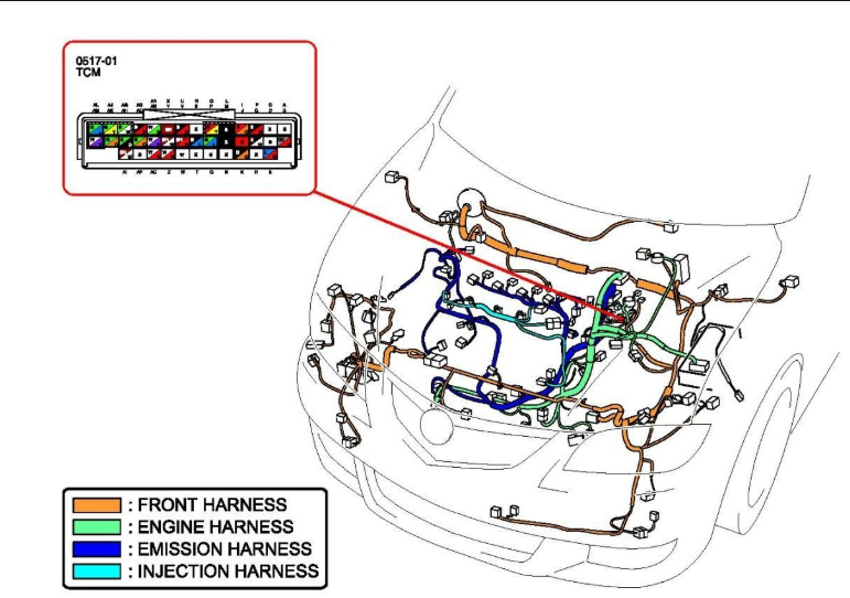

Vehicle listed above is a sedan. I have been having transmission issues, very delayed shifts and hard shifting when placed in reverse. I have drained the transmission fluid and was very little flakes on the magnet. It has displayed different codes, once for solenoid A, then solenoid c. I was looking for the TCM to replace, but after in-depth searching, I didn't not find it. If there is one I would love to know where it is, or is it integrated with the PCM located on the battery box. If so will changing the PCM do me any good?

Yes, your vehicle does have a TCM- transmission control module. I've attached a picture below of its location for your Mazda 3.Hope this helps and thanks for using 2CarPros.
