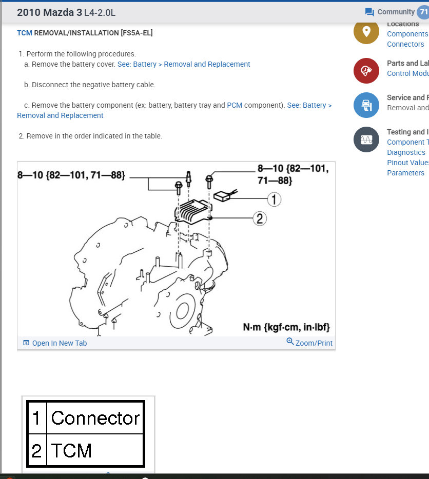

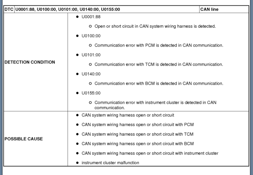

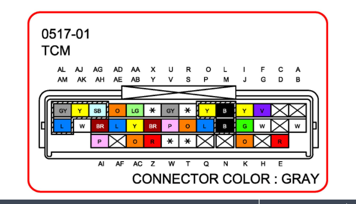

This code is just pointing you to a TCM due to it not communicating on the bus network.

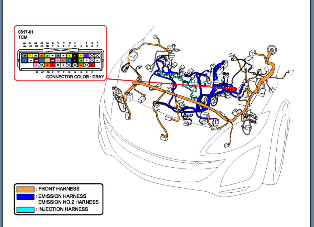

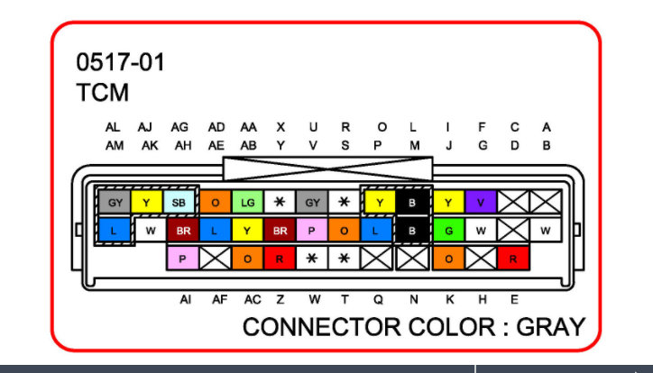

So that could be a module or a wiring issue, so I am attaching the info about this code and system.
The TCM is located on the driver side of the engine compartment.

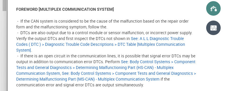

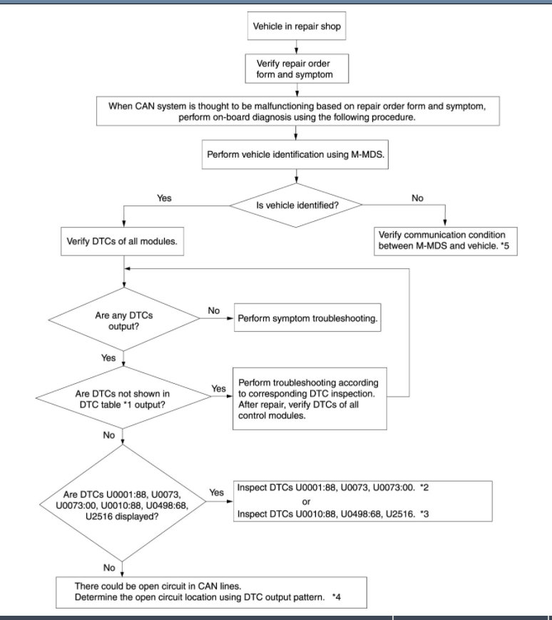

Here is a guide that will talk about this type of communication network:
https://www.2carpros.com/articles/can-scan-controller-area-network-easy
Please see all the info attached and let us know what questions you have.
