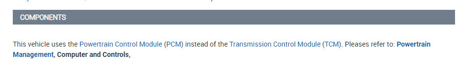

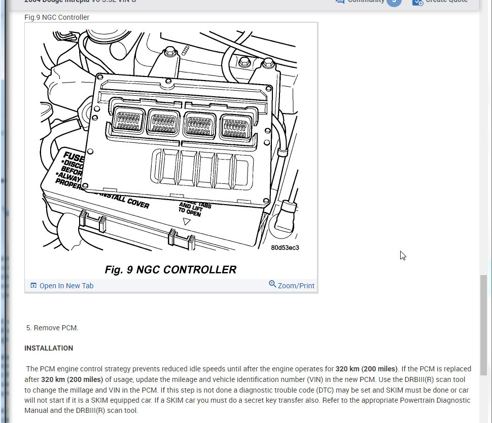

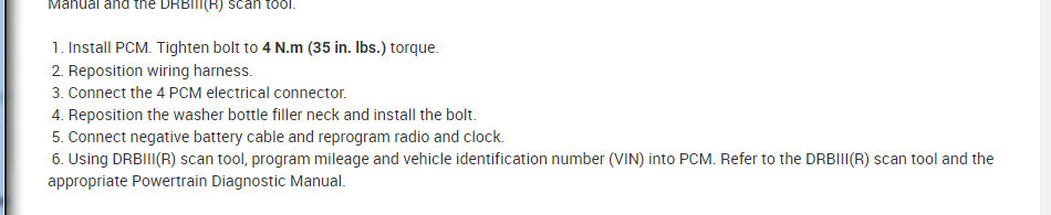

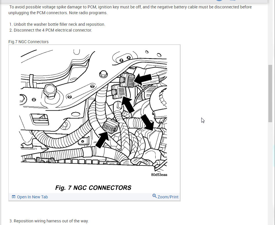

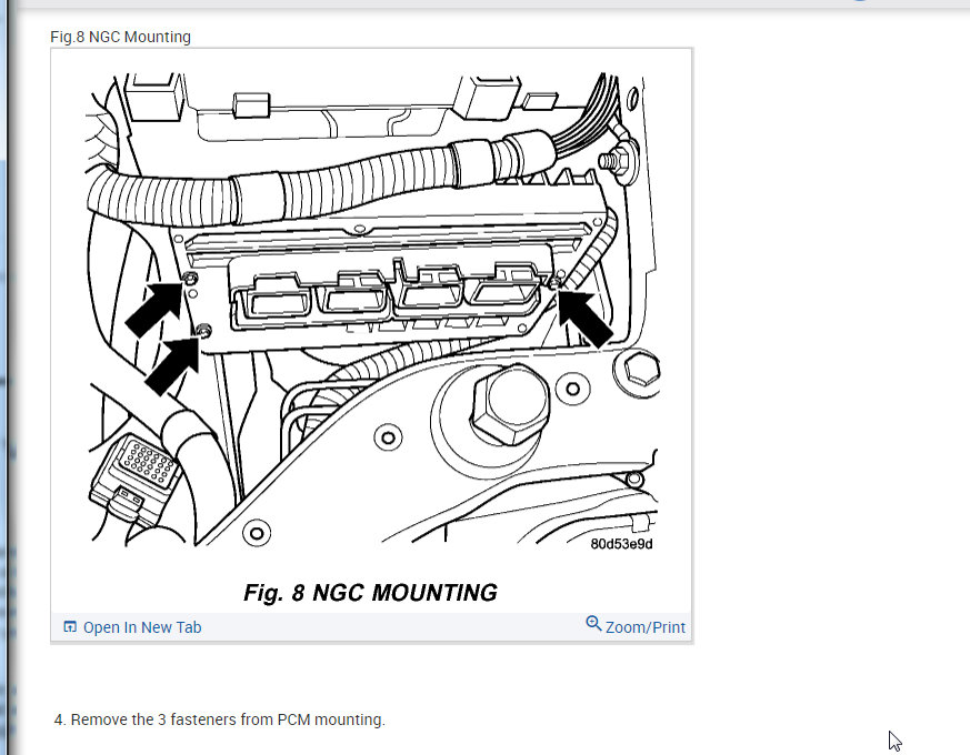

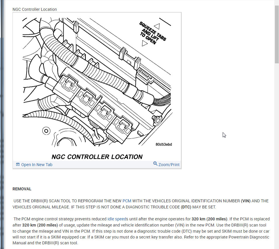

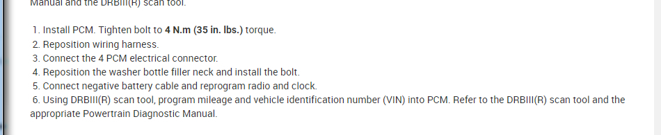

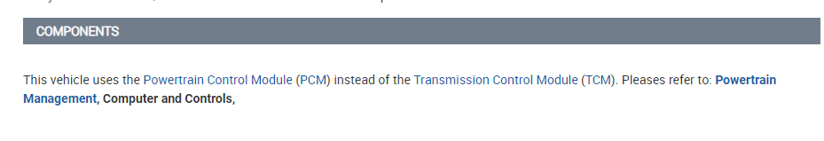

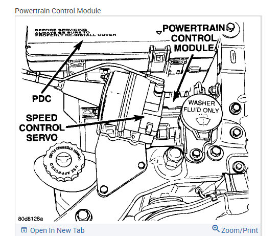

I can understand this frustration. You will not find it because this is a vehicle that uses what is called an NGC controller. So the PCM and TCM are the same component. Basically the PCM does the job for both.
Please see the info below on this and let us know if you have any other questions. Thanks
