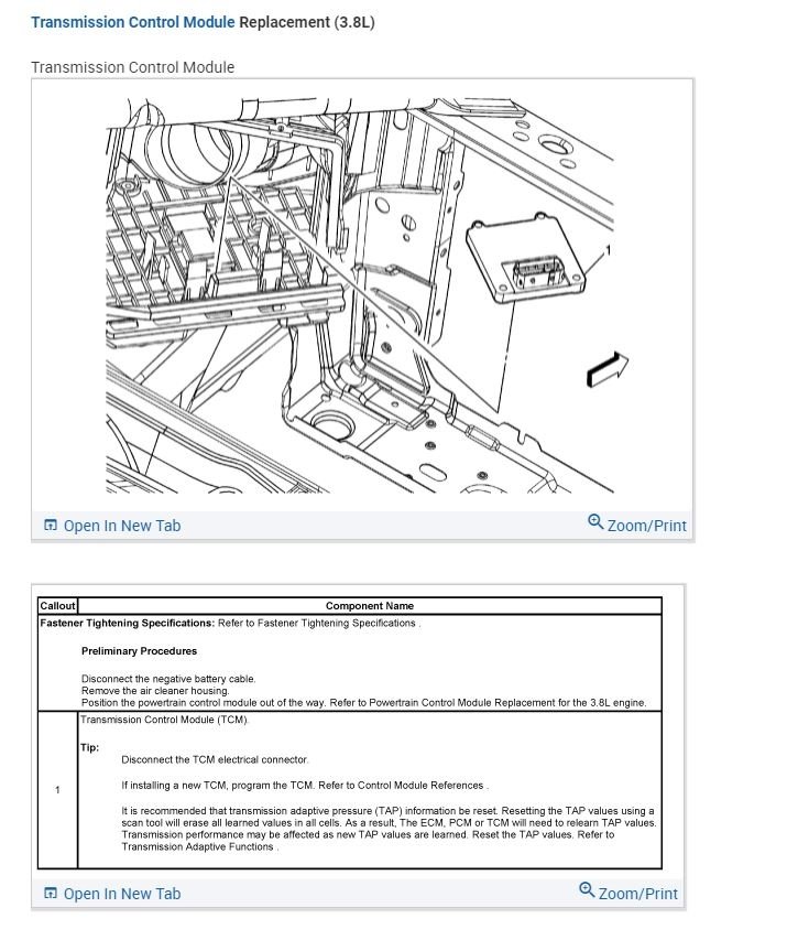

Good morning,
I attached the procedure for replacing it for you.

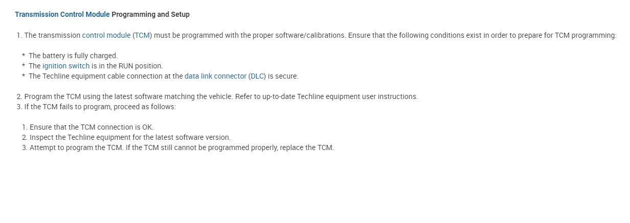

You also must have it programmed to your VIN with a factory scan tool.
The black connector is the only connector for the module. Make sure the number on your replacement is exact with the old unit.
