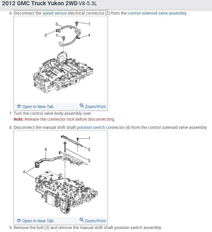

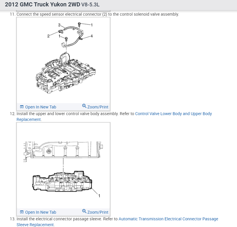

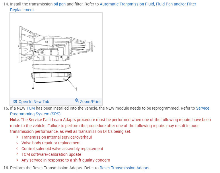

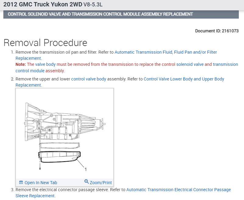

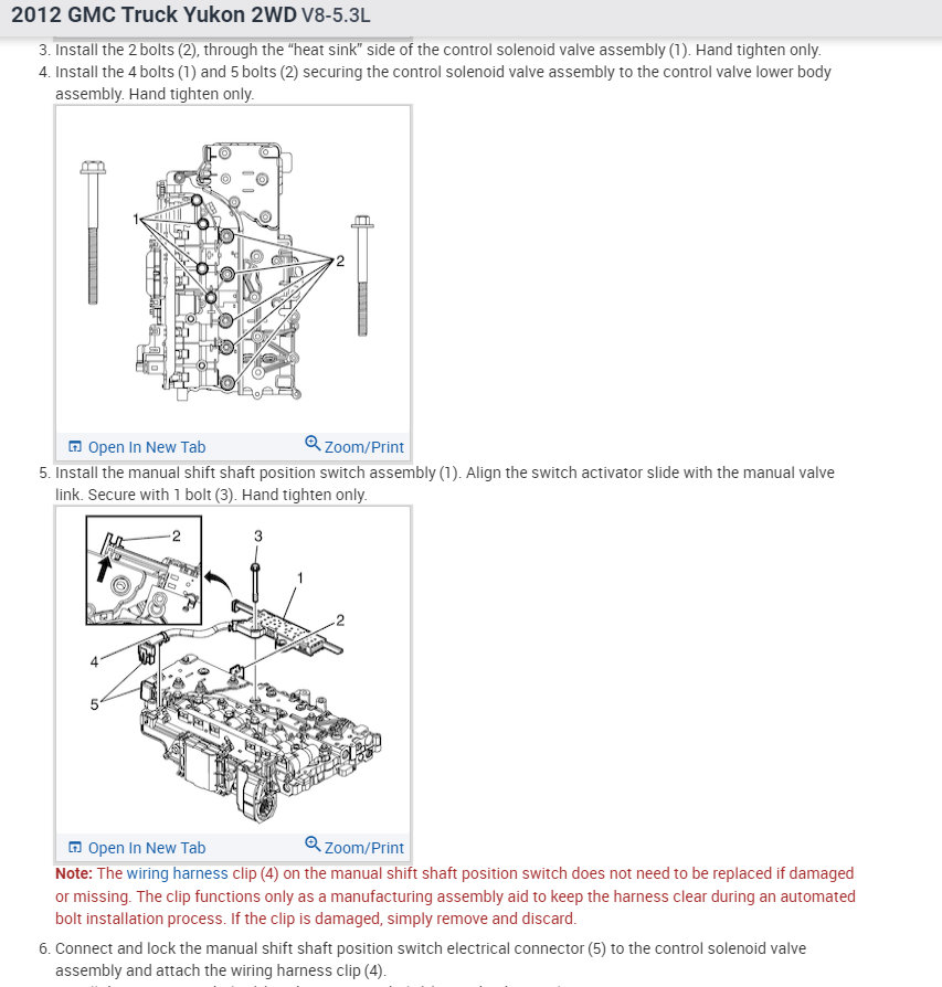

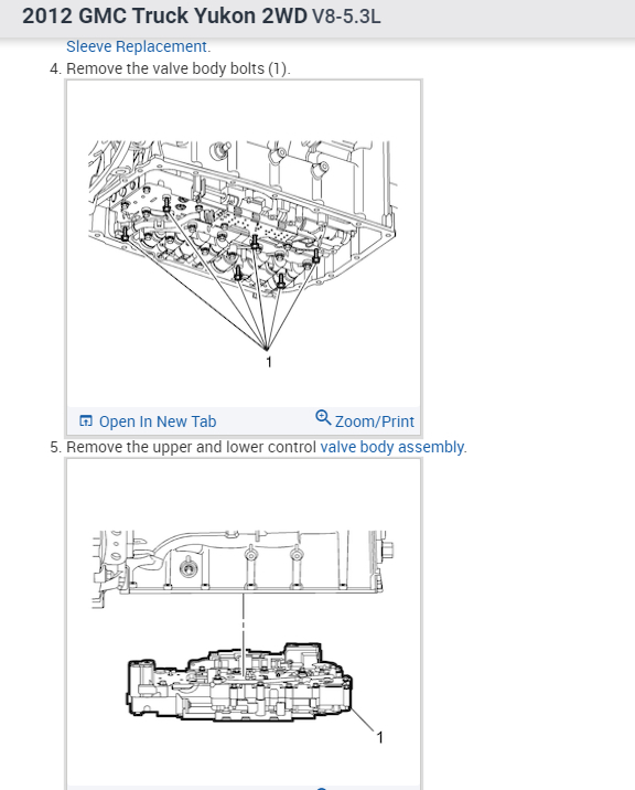

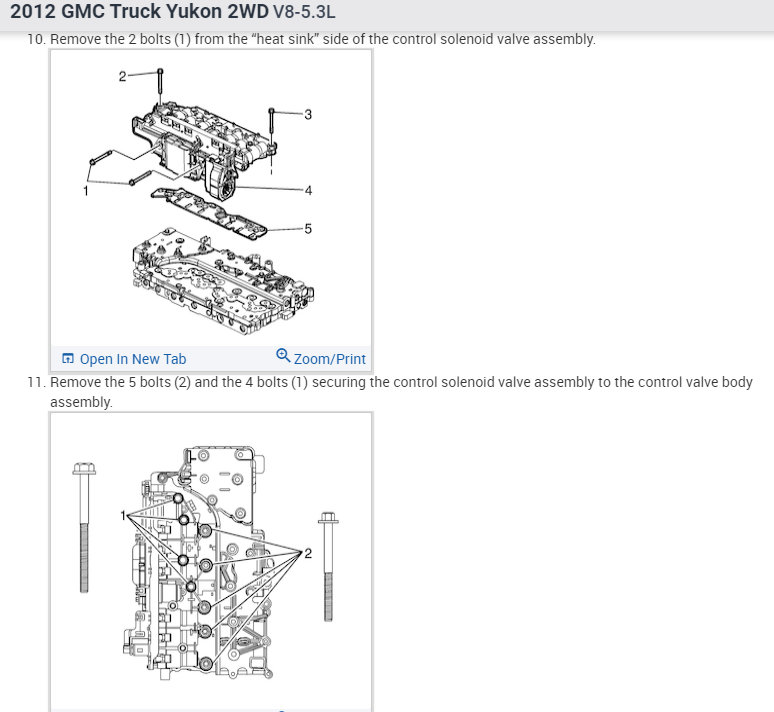

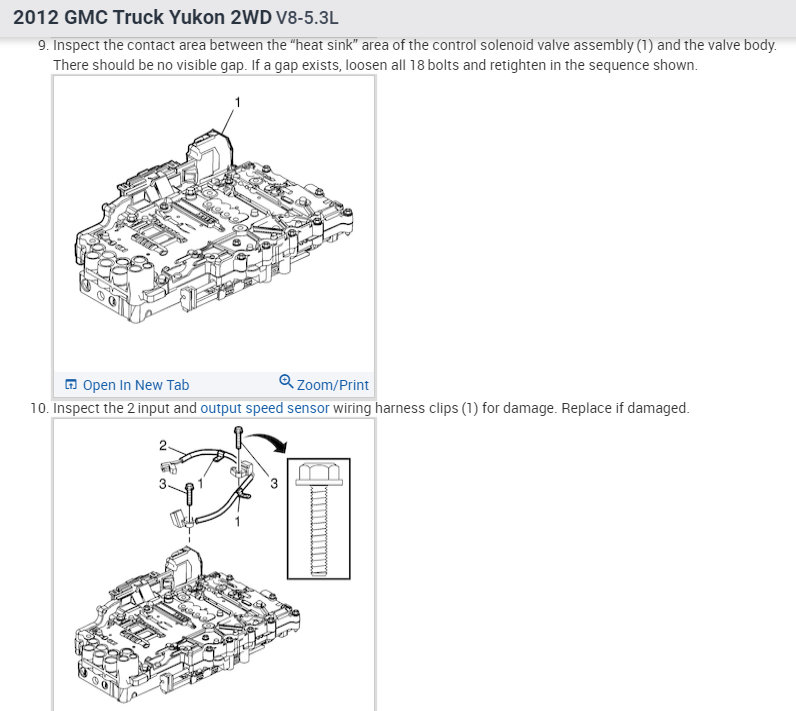

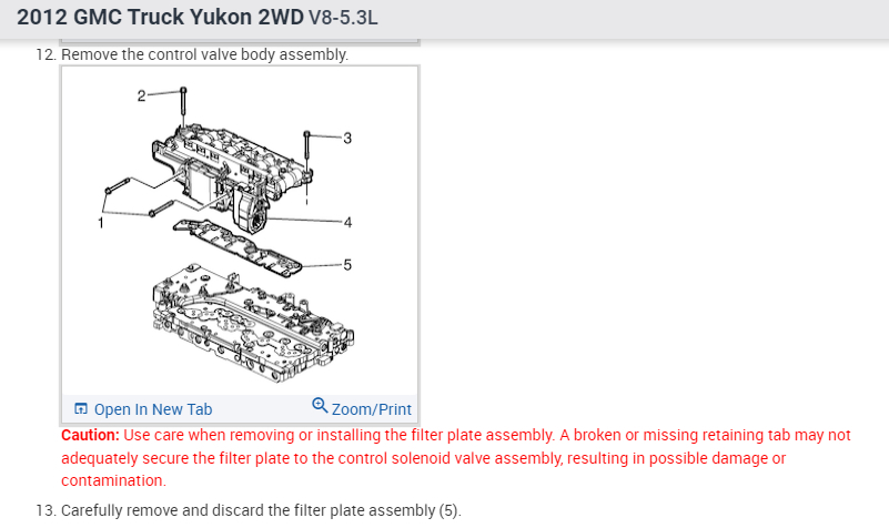

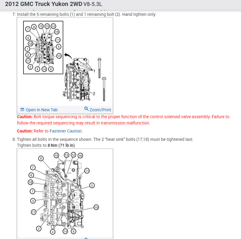

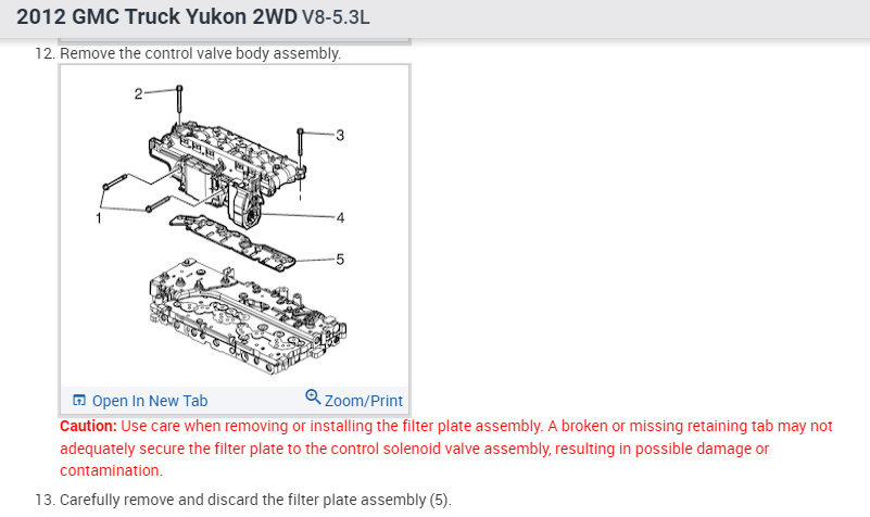

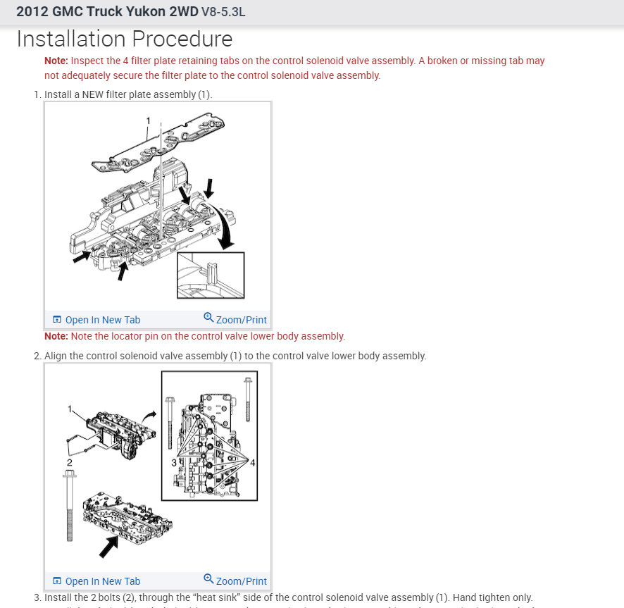

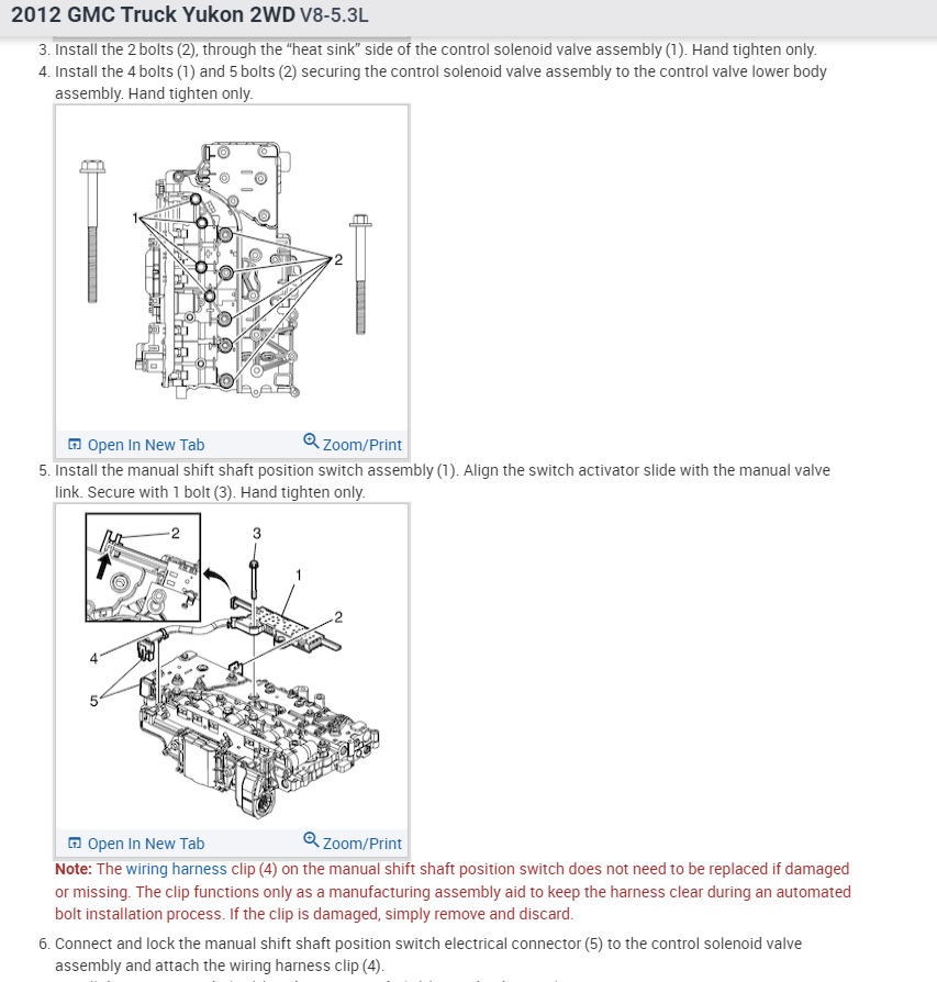

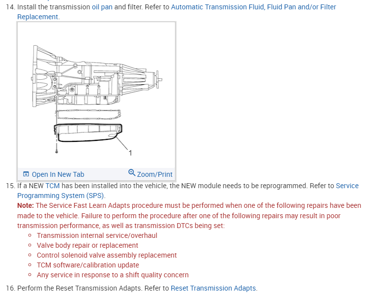

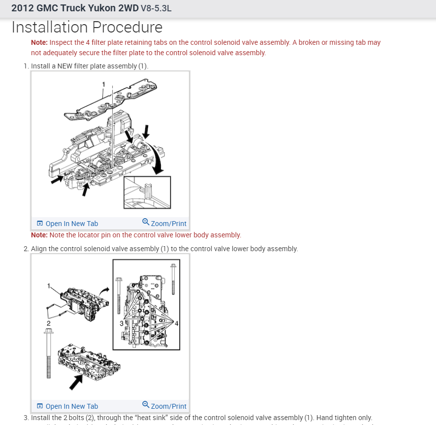

Yes, the TCM is located in the transmission and the transmission pan needs to be removed in order to access the TCM.
