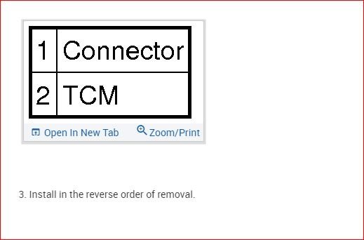

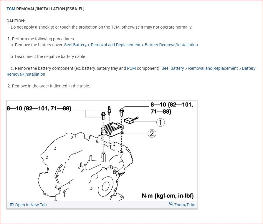

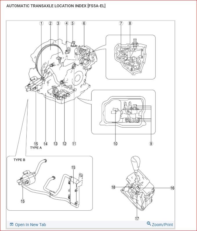

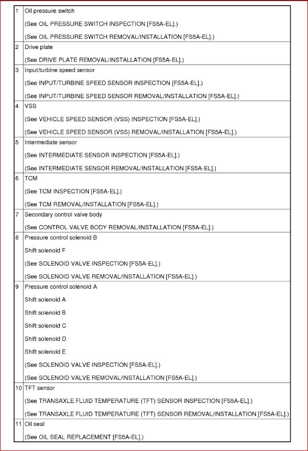

Hi Mayra,
Please see the attached documents. #6 is the TCM.
I also included the removal procedure. Please let me know if you have any other questions. Thanks
