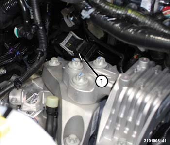

pic 1
8. Disengage the lock (1) holding the wire connector to the TCM.
9. Separate the wire connector from the TCM.
10. Remove the bolts holding the top of the TCM to the trans-axle.
11. Separate the TCM from the vehicle.

See pic 1
4. Engage the lock to hold the wire connector to the TCM.
