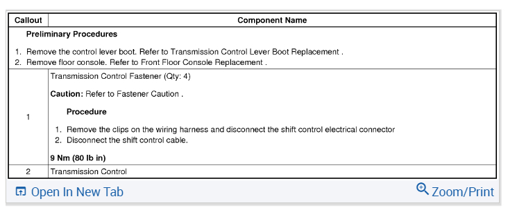

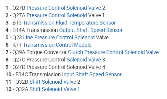

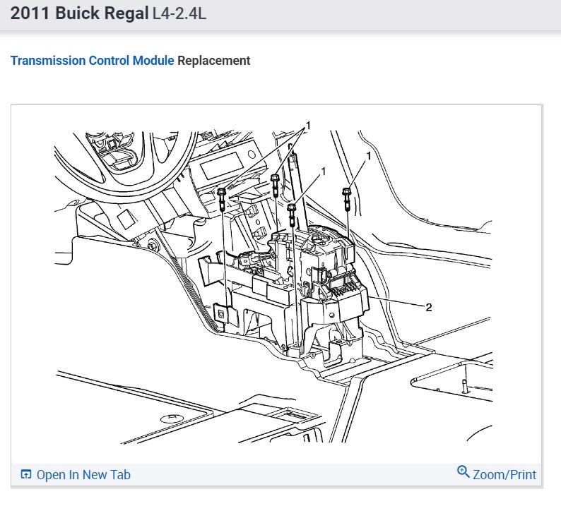

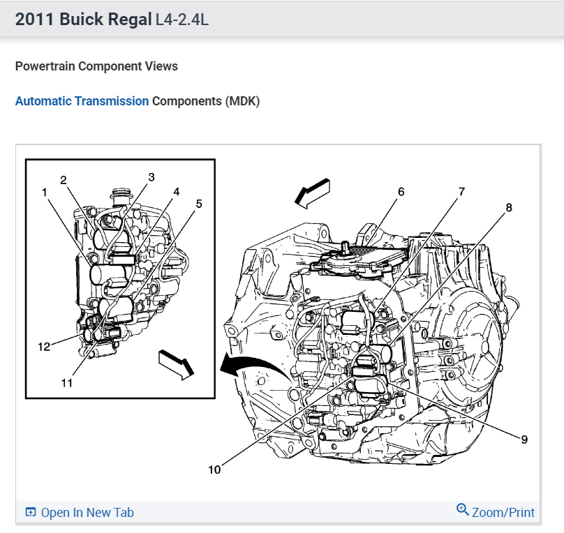

It looks like there are two they talk about, one is on top of the transmission at the shift control lever and the other is the shifter assembly, they both contain electronics. Check out the images (below). Please let us know if you need anything else to get the problem fixed.
