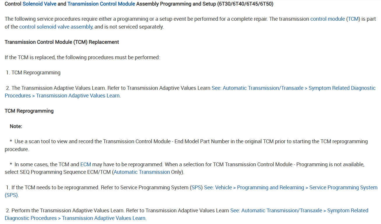

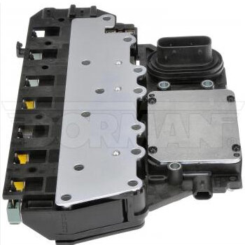

I have checked the power and ground going to the TCM. It's good. Everything I have found online says, the TCM is under the left side of the dash. I found nothing. I tested the plug I found on the front side of the transmission.
