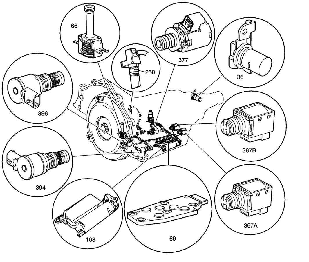

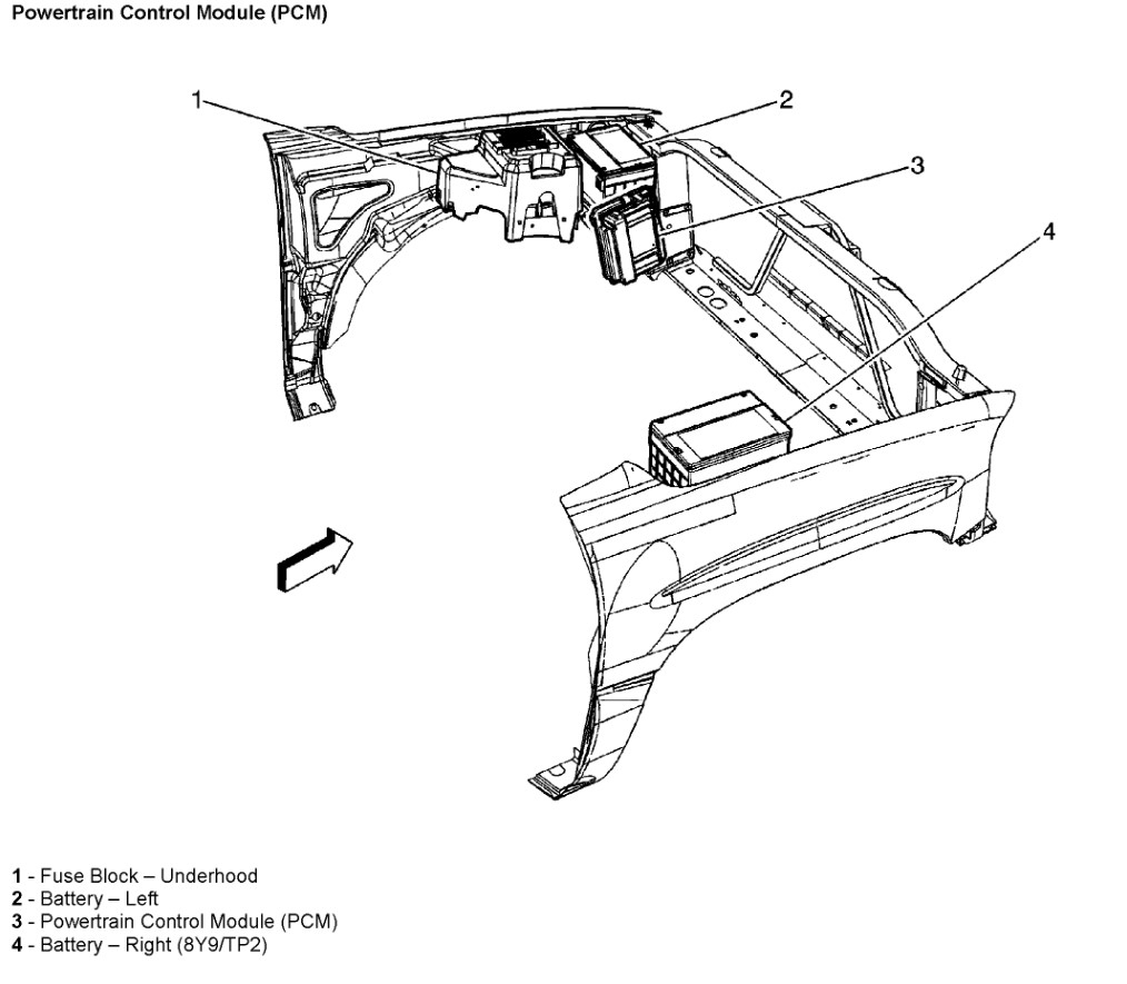

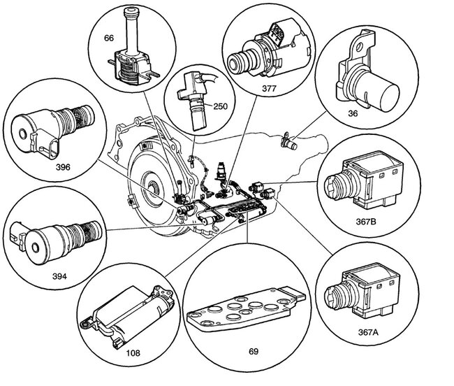

The TCM is a part of the powertrain control module aka engine computer located in the front of the truck under the left battery box. All of the shift control solenoids are inside the transmission, you need to drain the fluid, remove the pan, then the transmission valve body and then you have access to them all. What is the issue you are having; it may be possible to give a better answer if we know the problem.
