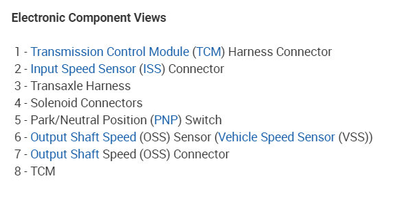

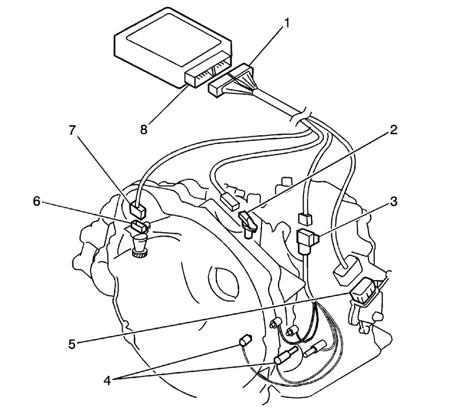

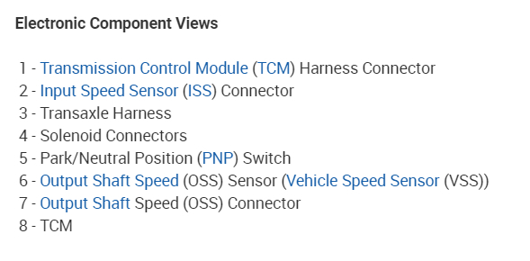

Started going through 'cheap' fixes to try to find the issue. I replaced the TPS and that was not it. We also replaced the MAP sensor and that did not solve the issue. The only other thought I had was the TCC solenoid but I am not sure if the solenoid can even cause this symptom. I would think the only way this stuttering would happen is if the solenoid is 'leaky', but to me it seems like it should be an on or off situation for the valve. Maybe there's buildup inside the TCC solenoid valve? Is that even possible? Thanks in advance!
