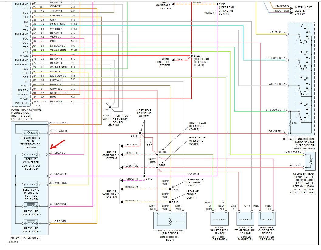

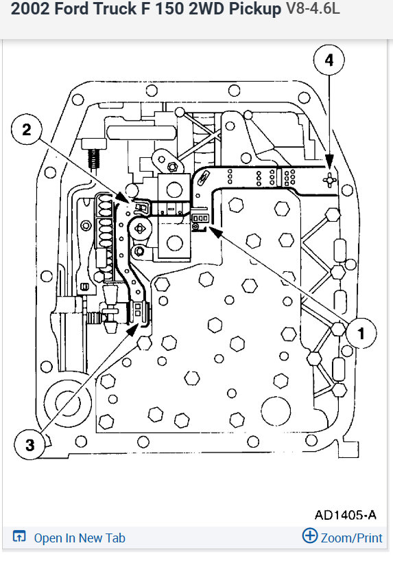

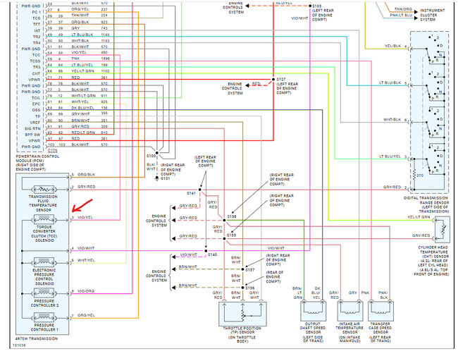

The torque converter control solenoid is on the valve body with the vio/yel wire. You should remove the pan and trace the wire to the solenoid in question. Check out the images (below). Let us know if you need anything else.
