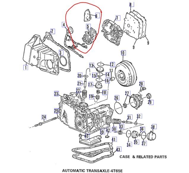

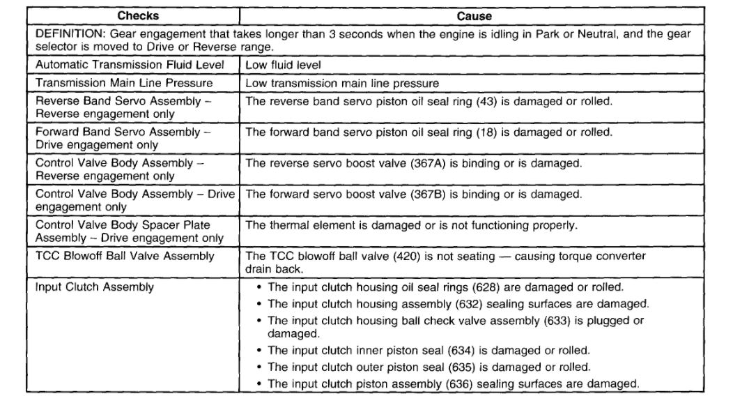

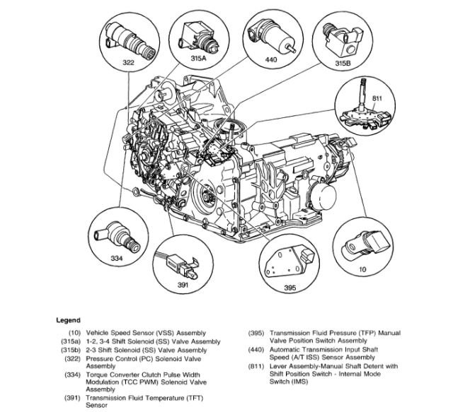

I posted a flow chart below with possibilities of the issue.

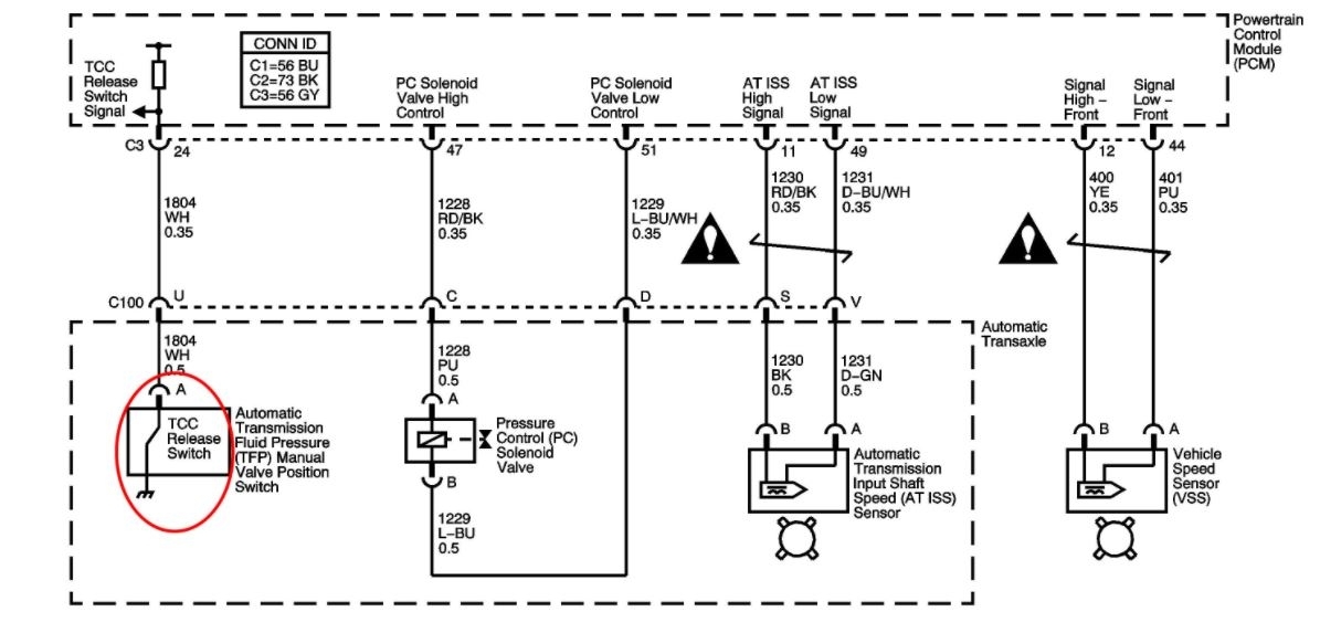

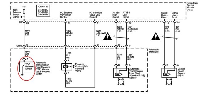

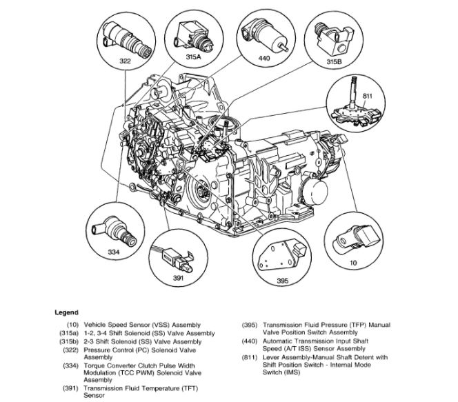

I attached the code description and some checks below. This code will not prevent it from going into gear.
You most likely have an issue with the front pump not producing enough pressure.

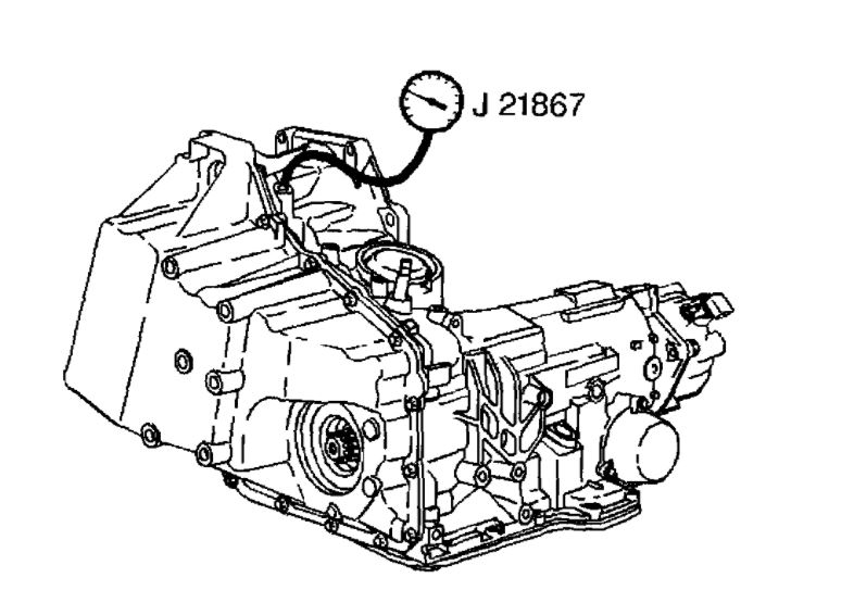

I attached the procedure for testing the line pressure to be sure it is the front pump.

Pressure test
Line Pressure Check Procedure
Tools Required
- J21867 Pressure Gage
Important:
- Before performing a line pressure check, verify that the pressure control (PC) solenoid valve is receiving the correct electrical signal from the PCM.
- Some conditions may be intermittent, therefore this test should be performed at least 3 times.
1. Install a scan tool.
Caution: Keep the brakes applied at all times in order to prevent unexpected vehicle motion. Personal injury may result if the vehicle moves unexpectedly.
2. Start the engine and set the parking brake.
3. Check for a stored Diagnostic Trouble Code (DTC).
4. Repair the vehicle, if necessary.
5. Check the fluid level.
6. Check the manual linkage for proper adjustment.
7. Turn the engine Off. Remove the oil pressure test hole plug and install the J21867.
8. Put the gear selector in PARK range and set the parking brake.
9. Start the engine and allow the engine to warm up at idle.
Notice: The total test running time should not be longer than 2 minutes. Running the test longer than 2 minutes may damage the transaxle.
10. Access the PC solenoid valve control test on the scan tool.
11. Increase the PC solenoid actual current from 0 to 1 amps in 0.1 amp increments. Allow the pressure to stabilize for five seconds after each pressure change. Read the corresponding line pressure on the J21867.
12. Refer to the Line Pressure specification table. Compare the data to the table.
13. If pressure readings differ greatly from the table, refer to Incorrect Line Pressure.
14. Shut the engine OFF. Remove the J21867.
15. Apply sealant GM P/N 12345382 (Canadian P/N 1095348) to the oil pressure test hole plug.
Notice: Refer to Fastener Notice in Service Precautions.
16. Install the oil pressure test hole plug.
Tighten the plug to 12 Nm (106 inch lbs.).
