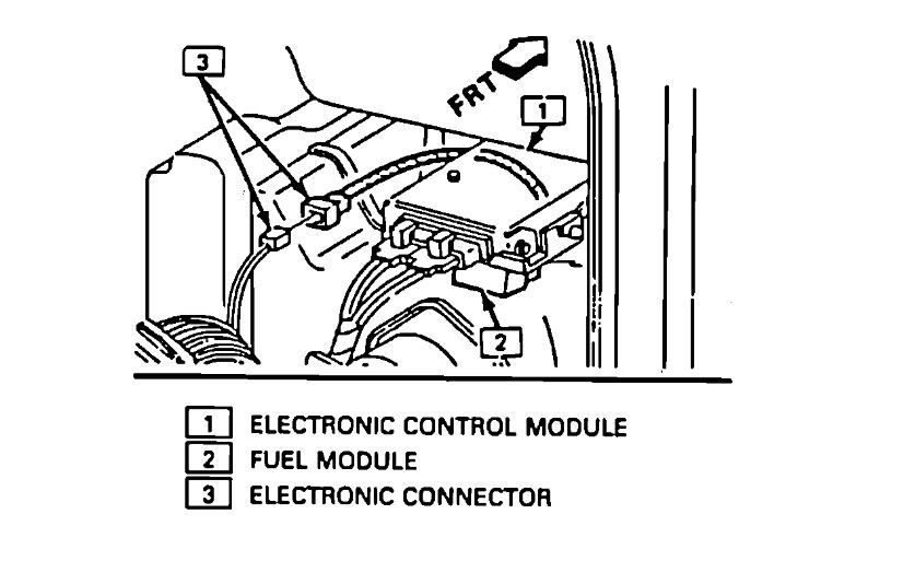

Good morning,
You did the testing for this already.
When you disconnected the injectors and the fuel did not flood, that means the injectors are good.
The erratic operation indicates the ECM is the issue.

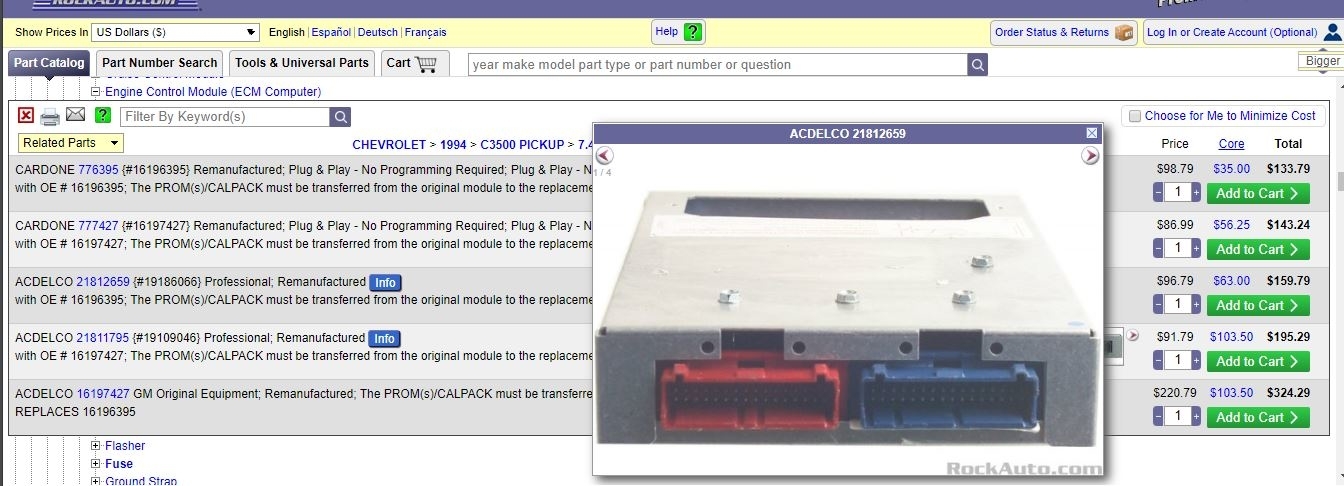

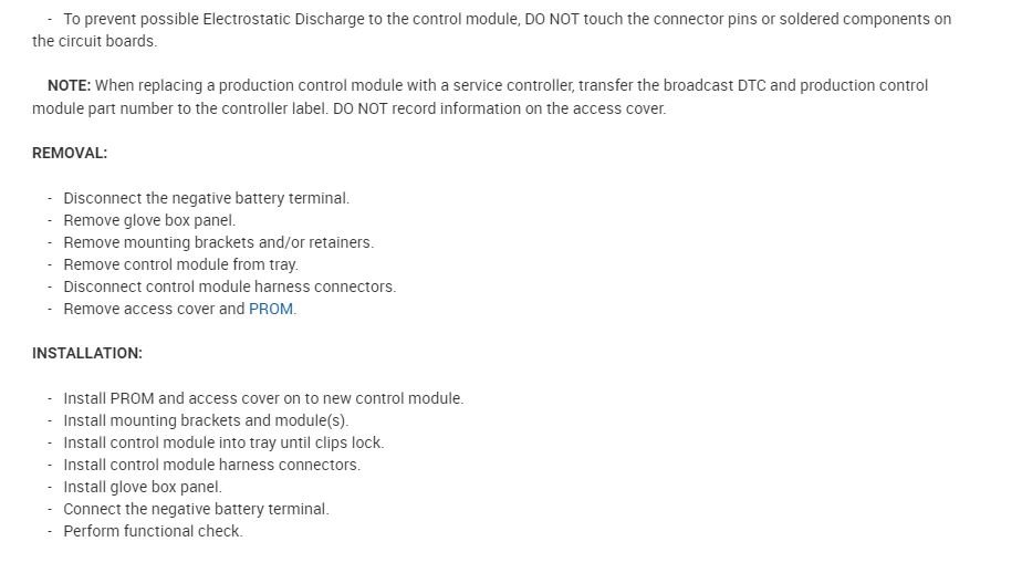

I would replace the ECM. I attached the part from Rock Auto. You need to match the numbers on the ECM. This is a plug and play module.
