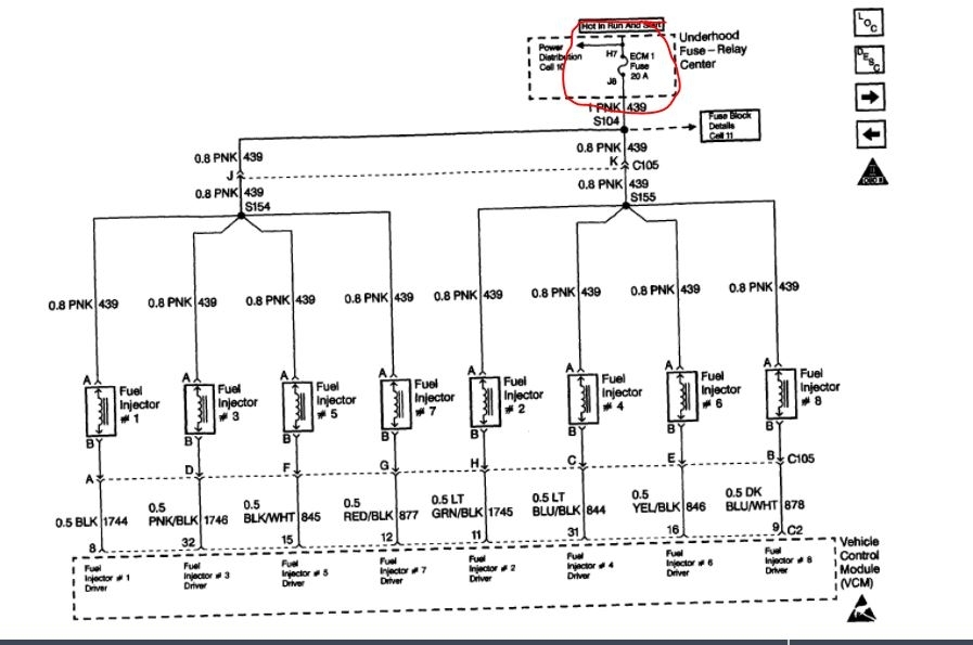

Truck runs fine then drops a bank because one injector not spraying, then runs fine again for a while. Injector working okay because when I change plugs over that side starts to fuel okay. Have changed plug on top of injector with cable but no difference, suspect broken wire further in or been suggested pick up in distributor. Is there one pick up for each injector in the distributor?
