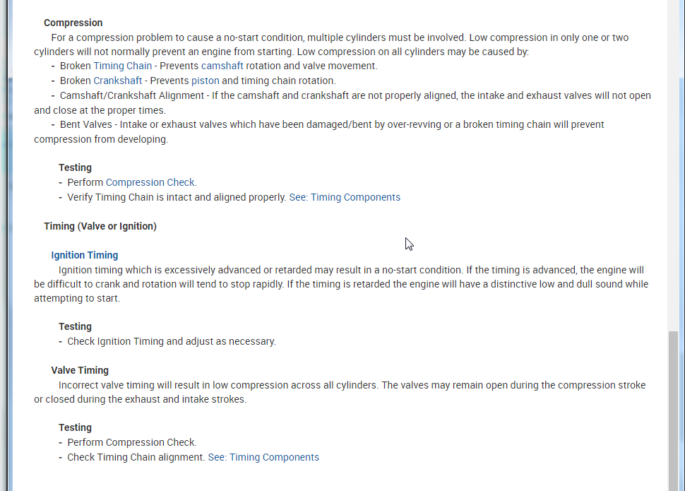

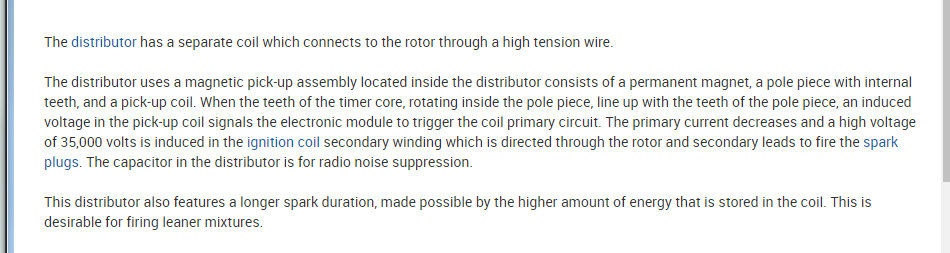

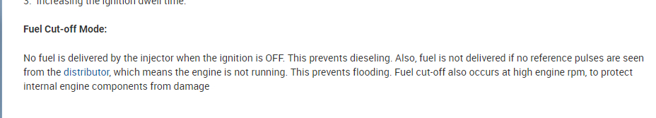

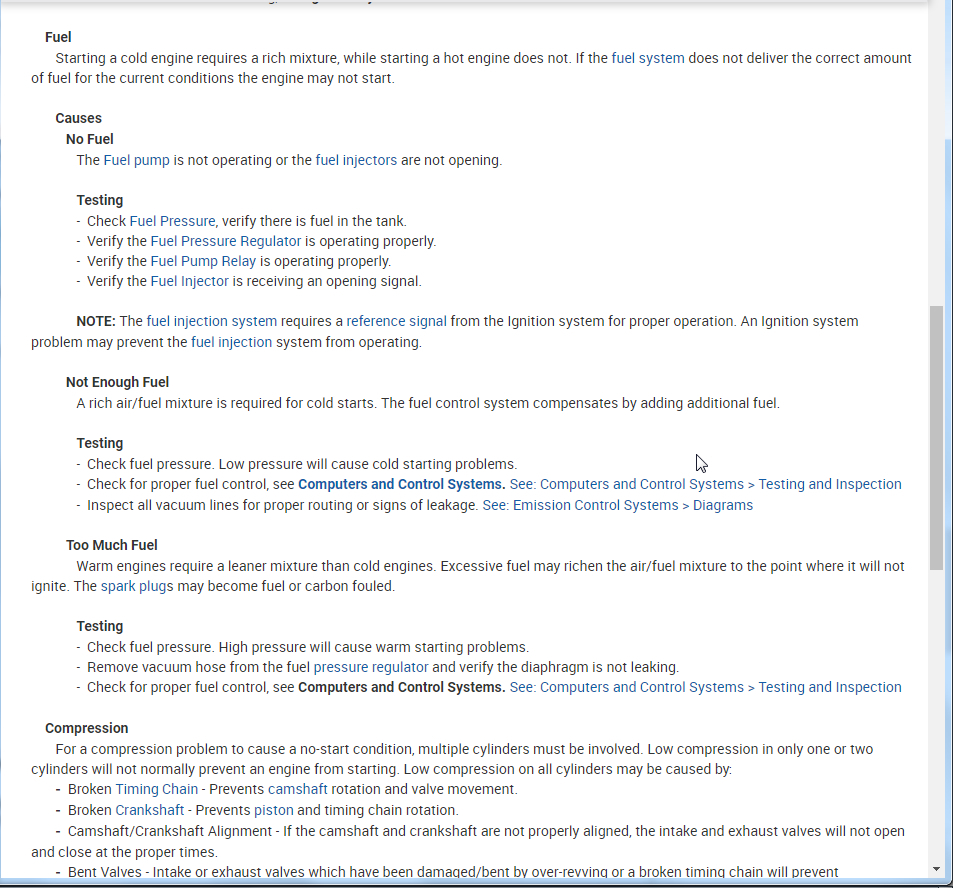

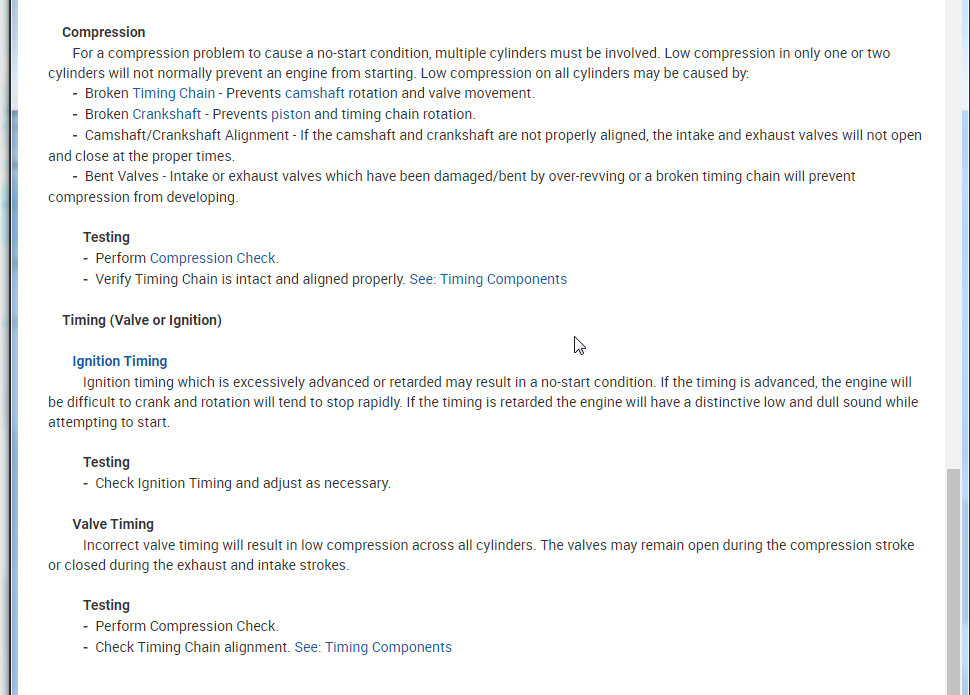

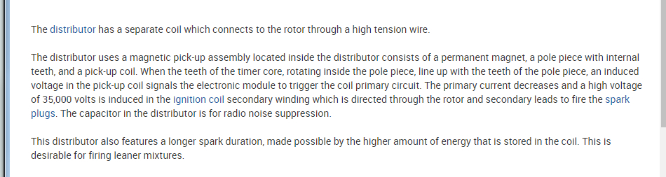

You are correct that the ECM controls the fuel pulse and when it is not pulsing the injectors, it is in what is called fuel cut off mode. I attached the specifics about this but basically it is not seeing the reference pulse from the distributor.

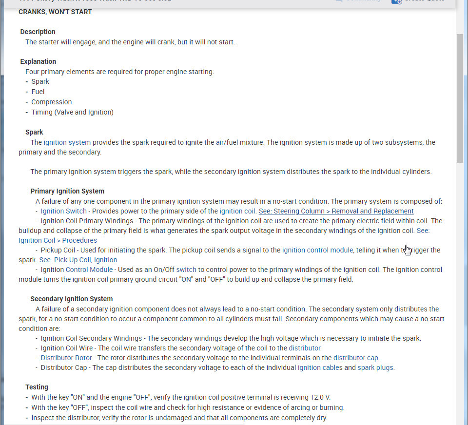

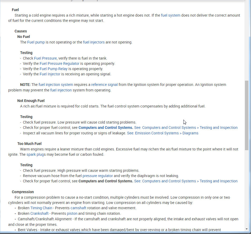

Take a look at this material and let's go through the testing that I attached for a crank no start.
Once we run through this, I am sure something will turn up that we need to address or even figure out what the issue is.

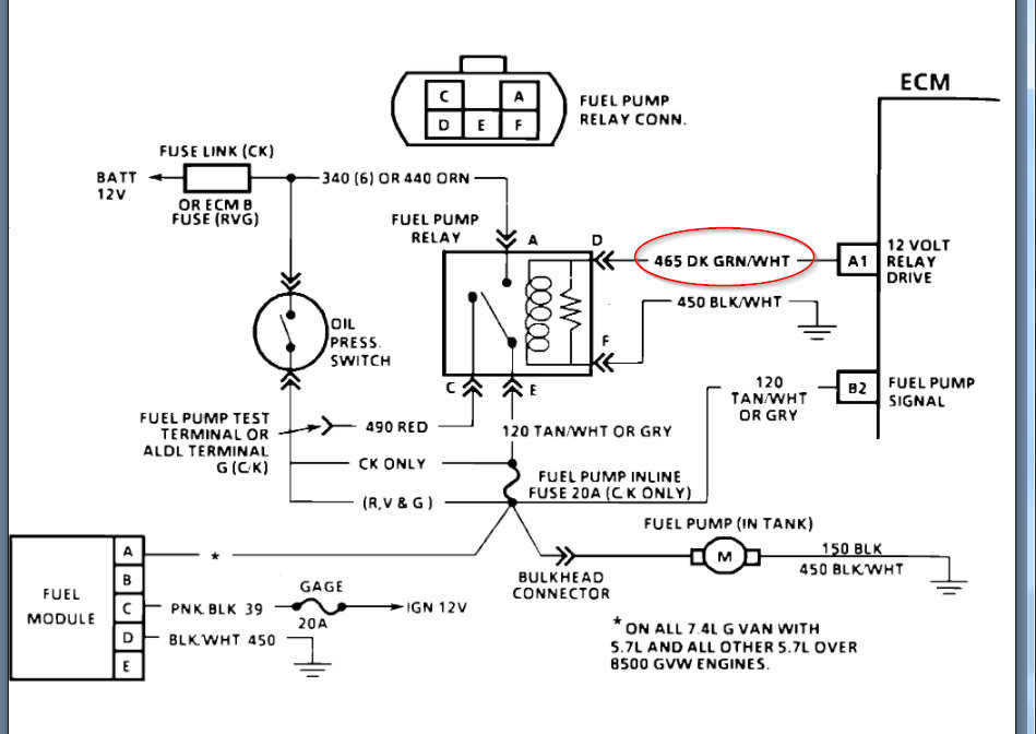

Okay, I have traced it a little further and figured out the fuel pump relay isn’t getting a signal through the green wire.
Dec 16, 2020 at 5:44 PM
I am attaching the wiring diagram. You mean the wire from the ECM that signals to close the relay from the ECM? If so, that is either an ECM issue if you have proper ignition signal or the ECM is not getting the ignition signal. I think this would be an ECM issue because I don't think the ECM de-energizes this relay if there is no ignition signal. The way I understand it is the ECM will not energize the injectors if there is no ignition pulse.
Did you find that the ECM is getting an ignition pulse? If so, it needs an ECM.
