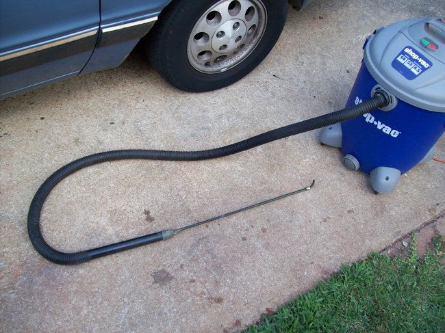

This might be an easy way.
Be sure to remove the vac's filter.
Use a piece of fuel line or vacuum line (instead of the steel brake line in my picture).
Duct tape/etc., the smaller line inside the hose, seal it off good.
Let us know how it goes.
The Medic
