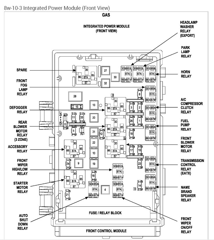

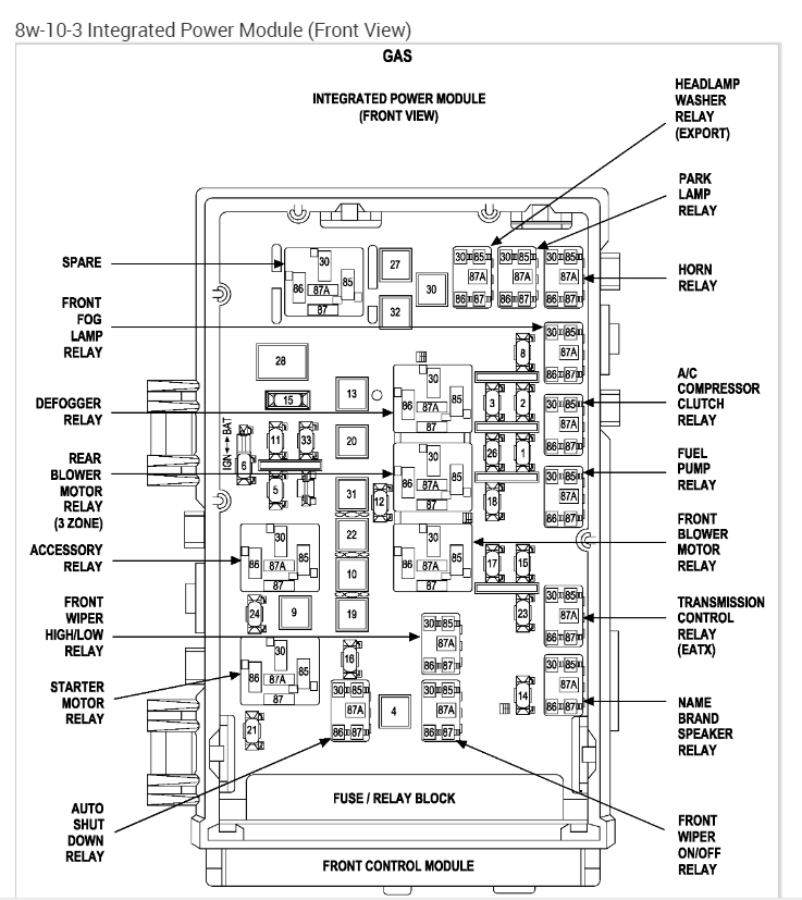

But brake lights and turn signals are working. Please help.
Aug 12, 2022 at 5:16 AM
CERTIFIED EXPERT
53,854 POSTS
I would check the fuses # 2 and #3 in the under-hood fuse panel and if they are okay replace the park lamp relay. here is a guide to help you check the fuses and the fuse and relay locations in the diagrams below:
