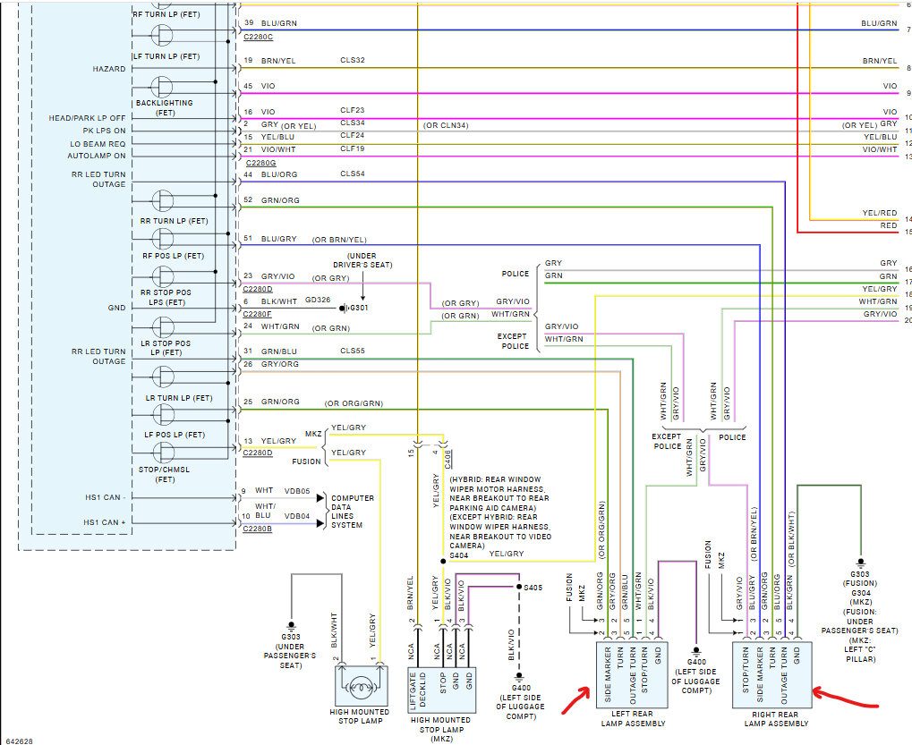

I want to make tuning for Taillight and install running lights. So, I need learning wiring diagram and pin placement. I hope for your support.

I'm trying to put the running turn signals on the rear lights.

Gotcha, here are the wiring diagrams for the tail lights. Check out the images (below). Please upload pictures or videos in your response
