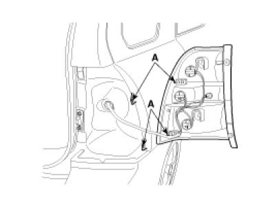

Here are directions for replacing a light. I'm adding them so you can see how the assembly is removed. The attached picture correlates with these directions.

REMOVAL AND REPLACEMENT
REPLACEMENT
1. Disconnect the negative (-) battery terminal.
2. Loose the screws holding the rear combination lamp then disconnect the 6P connector.
NOTE:
Take care that holding clip (A) is not to be damaged.
Picture 1
3. Remove the rear combination lamp and replace the bulbs; stop & tail lamp, turn signal lamp, back up lamp.
4. Installation is the reverse of removal.
