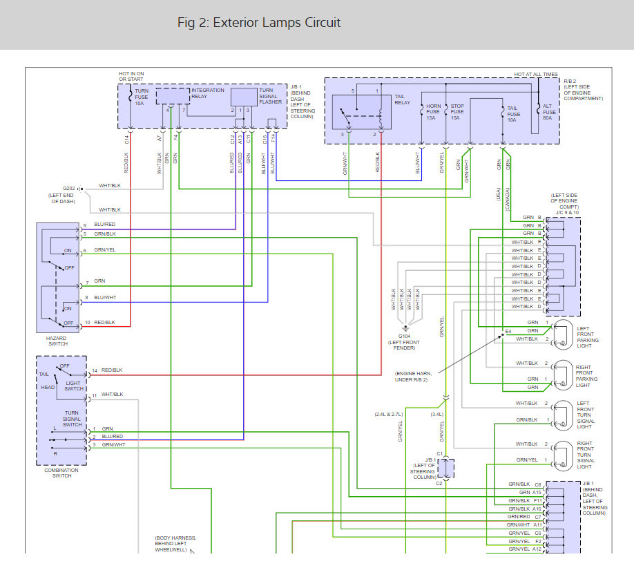

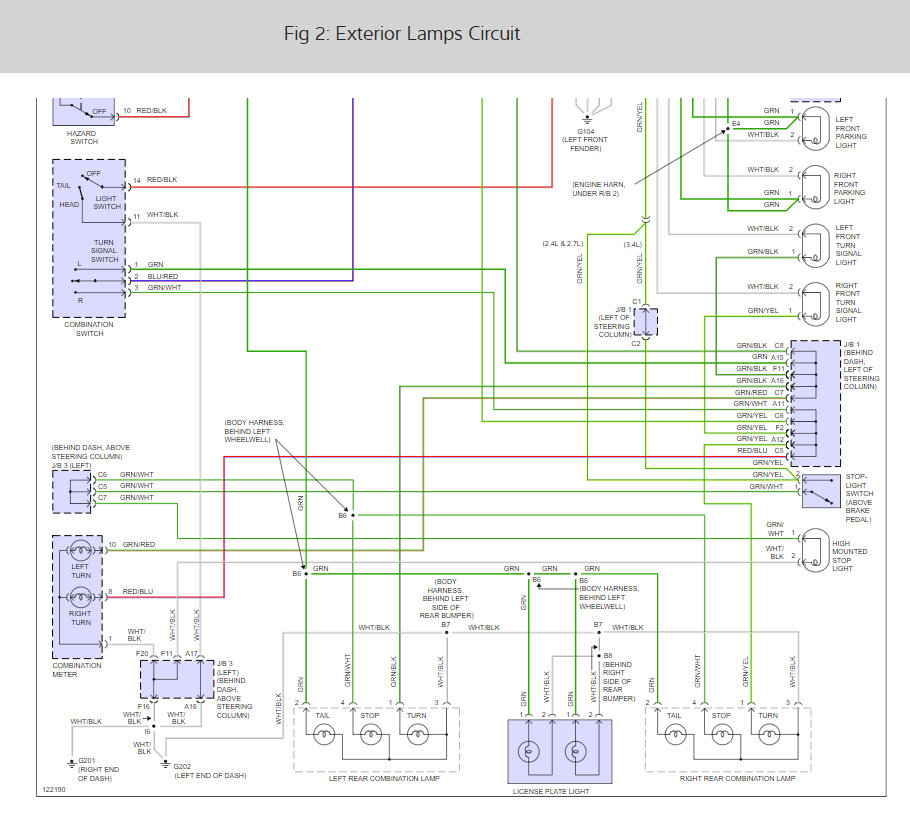

Ice or water got in a connection some place I think? Fuses are good? Short or connection problem? What is best place to start trouble shooting?
Feb 28, 2019 at 3:08 PM
I would start with the tail light relay or combination switch. Here is a guide to help you get started with the tail light wiring diagrams so you can see how the system works:
and
https://www.2carpros.com/articles/no-tail-lights-exterior-running-lights-tail-lights-out
