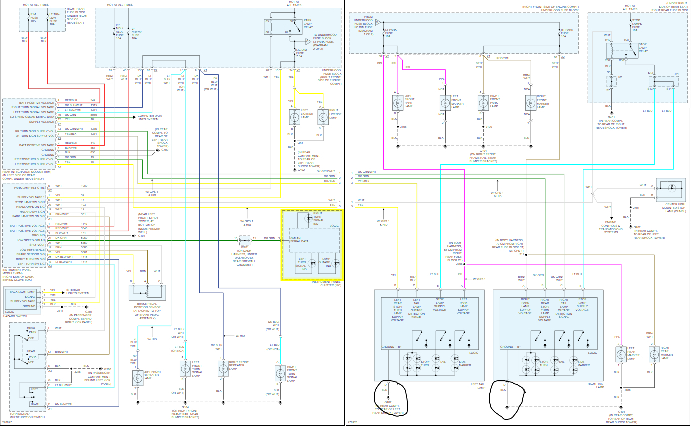

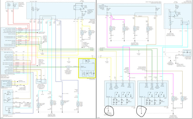

Hi Marty S., my name is Alex and I will be helping you with your problem today. I suspect that the ground wire to the taillights might be to blame here. I am including a link on how to test taillight assemblies, as well as a wiring diagram for you I have also circled where the grounds are for the taillight assemblies are on the wiring diagram for you. I hope this helps.

Hi Alex. Thanks for the quick response and the schematic! I'll investigate further when I get home tonight and let you know what I find. From the schematic, it seems that a faulty taillight assembly ground would also prevent the stop/turn function from operating, but those are working correctly.

Hi Steve. Thanks for the response! The plate lamps and markers also do not work. Thanks to the schematic you guys provided, I was able to determine that power is not going to the tail lights. Power is going to the stop/turn lights when brakes or turn signals are activated. The only constant power at the light plug is apparently for the tail lamp outage detection signal. I haven't found any fuses or relays that don't work. But the park lamp relay doesn't seem to be pulling in. It doesn't click when the lights are turned on but by swapping it with the fog lamp relay I verified that is an issue with the circuit and not the relay. Both worked (and clicked) in the fog lamp relay socket, neither worked in the park lamp socket. There is power to the socket corresponding to terminal 85 of the park lamp relay but there seems to be an open circuit in the line to the socket corresponding to terminal 86. I'm guessing, but don't know, that there's a relay, switch, or something that's supposed to ground terminal 86 of the relay which then pulls in to connect terminals 30 and 87. Both the "LT PRK" and "RT PRK" fuses in the under-hood fuse block are okay.
