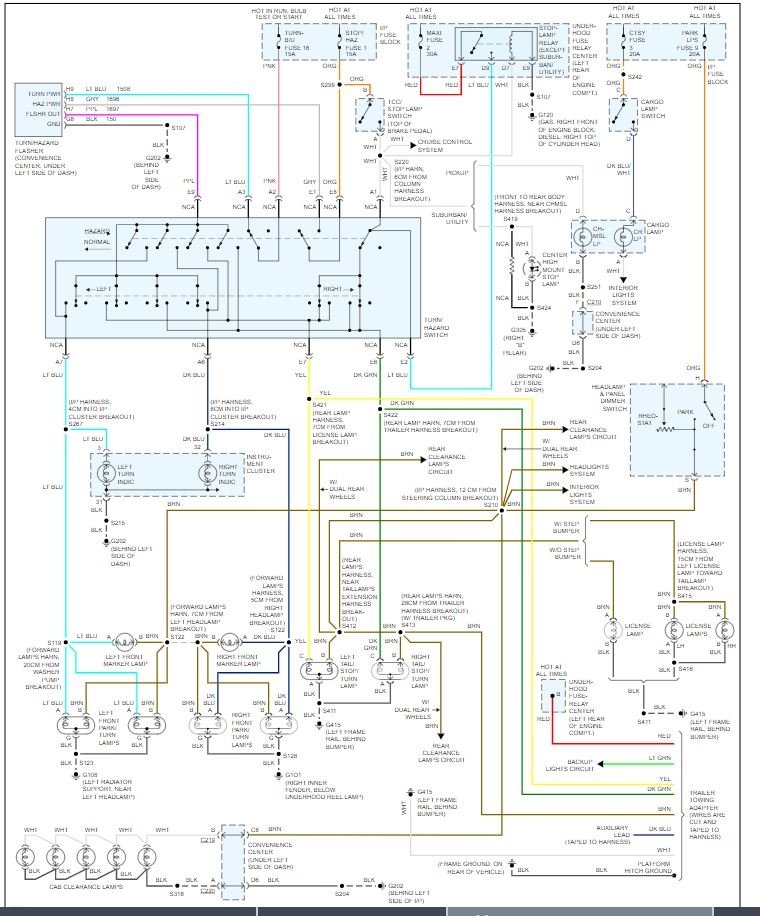

Do the license plate bulbs light up? The reason I ask is because they are on the same circuit. If the turn signal/brake lights work, then the ground circuit is okay.
Do the front marker lamps work okay?
Sometimes the taillights in trucks can be something as simple as corrosion in the taillight bulb sockets, or an incorrect light bulb being installed.
I've attached a wiring diagram for you to reference for your truck. Let me know what you find.
Jul 21, 2021 at 11:43 AM

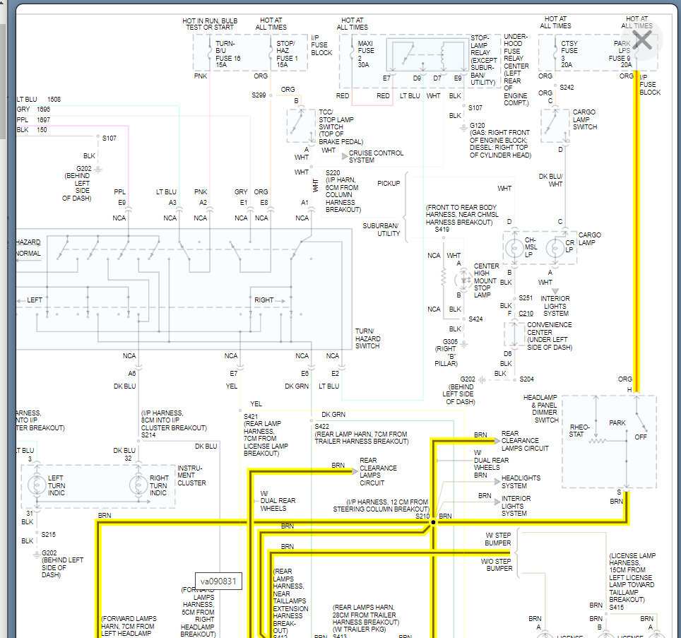

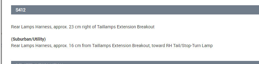

Take a look at the wiring diagram below and you will see a circuit that comes from the park lamp fuse to the switch, to the lamps in the rear and the front. If the front park lamps are working then everything is working from the fuse to splice S412. However, if the front are not working then that brings all this back into play.
So we need to check power at the fuse and make sure you have voltage on both sides. Since the switch is working then we need to jump to the rear bulb and if you have no voltage then we need to trace it backwards through the system until we find voltage on that circuit.

Please see the wiring diagram below and the location of this splice. However, another test that you can do that would confirm a wiring issue is run a wire directly from the switch power to the bulb and if that one works then you know you have a wiring issue between the two points.

Thanks for all the help. I pulled voltage on the 4 bank plug under the brake booster and it had power but I was not getting power at the end of that run to the tail lights so I put a test wire in the connection and plugged that into the rear harness and lights started to work. So I have a decision do I look for the bad area are do just replace that wire. But it does power 2 pins in the rear harness. Thanks for the pictures above they helped a lot.
