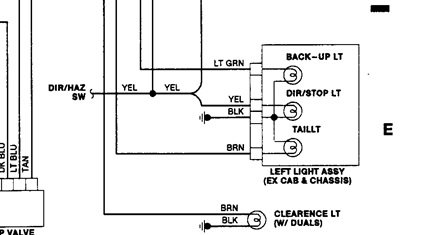

Possible issue with multifunction switch or wiring in the steering column. Give me a sec to find wiring diagram.
Apr 15, 2013 at 10:40 AM
JDL
  • 16,098 POSTS
Your lower brake lites and turn signal use the same bulb filament, just not at the same time. Yellow wire is voltage.
