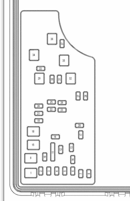

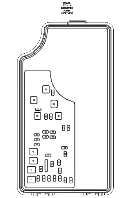

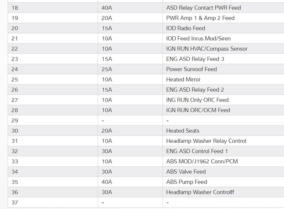

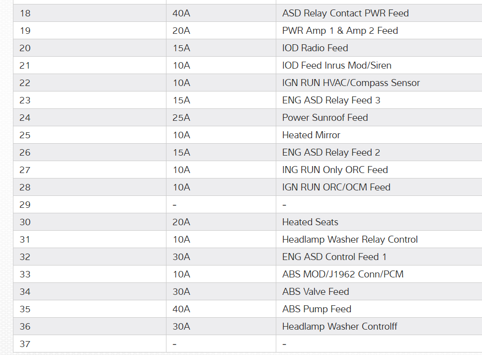

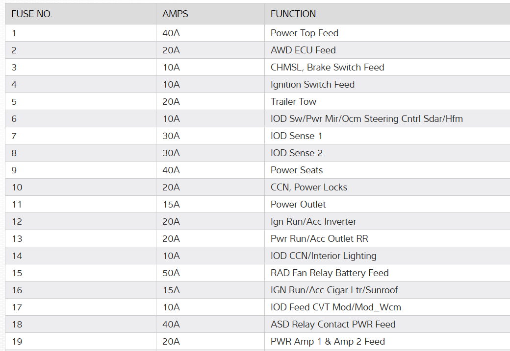

There are three fuses to check in the TIPM, #3, 33 and 17 here is a guide to help test and the fuse locations as well in the diagrams below.

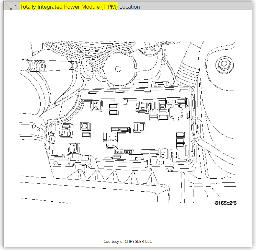

Do the license plate lamps work? What about the front running lights? If the license lamps do not work too. start by checking the fuses in the "TIPM", Totally Integrated Power Module. That is the under-hood fuse box. The listings under the cover can be confusing and the fuse that affects the tail lights might be involved with other circuits, so it is possible it is not labeled as the tail light fuse.
The fastest way to check the fuses is to turn on the ignition switch and the head light switch, then take voltage readings on the two test points on top of the fuses. If you find zero volts on both test points, that circuit is turned off and is not related to this problem. If you find twelve volts on both sides of a fuse, that one is good. You are looking for a fuse that has twelve volts on one test point and zero volts on the other one.

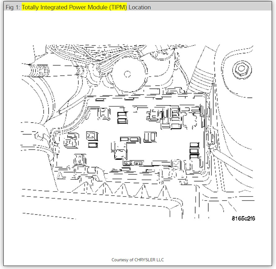

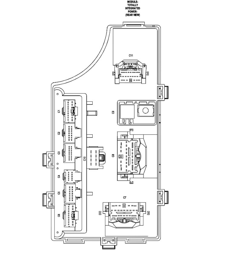

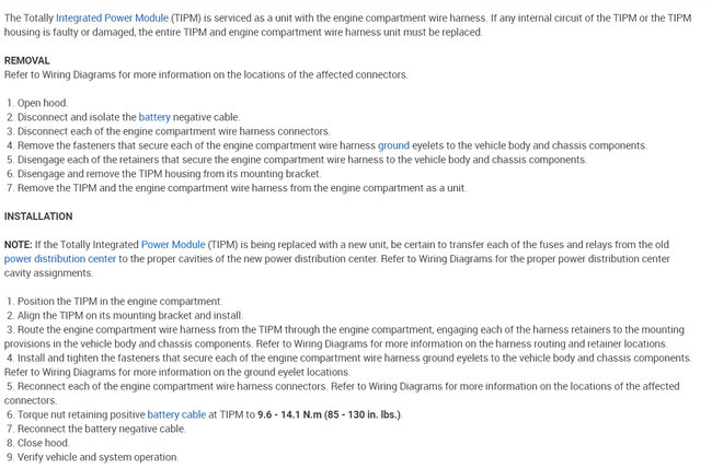

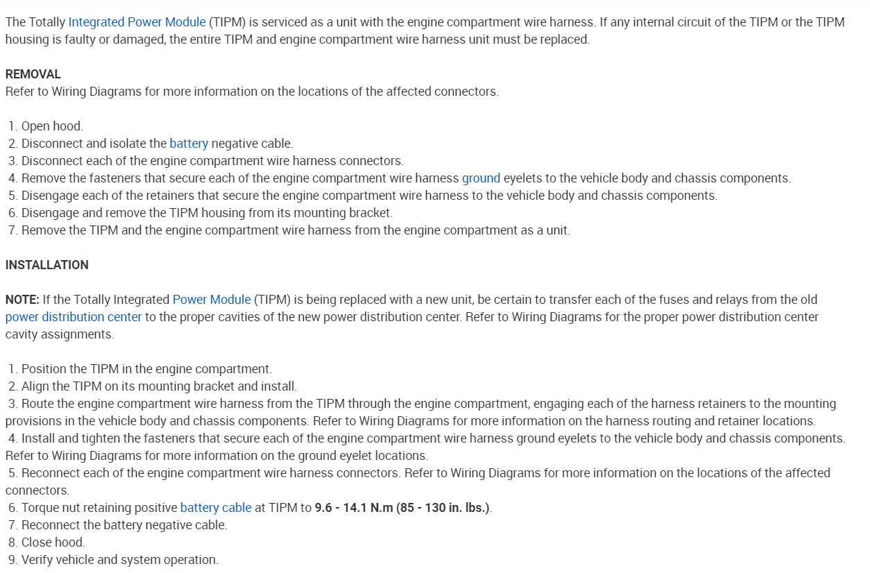

If the fuses are good chances are the TIPM is out but easy to replace because it self initializes. Here is how to replace it as well.
Check out the diagrams (Below). Please let us know what you find.

I got a used TIPM from the junkyard for $100.00 worked perfect. The fuses were good in my car BTW.
