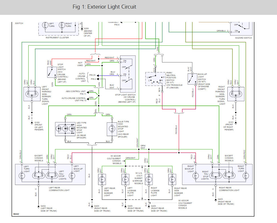

No taillights brake lights or running lights, need relay location
1994 MITSUBISHI MIRAGE
233,000 MILES
APRIL SPARKS
Bulbs are good fuses good. can't find relay to test?
Dec 8, 2019 at 7:08 AM

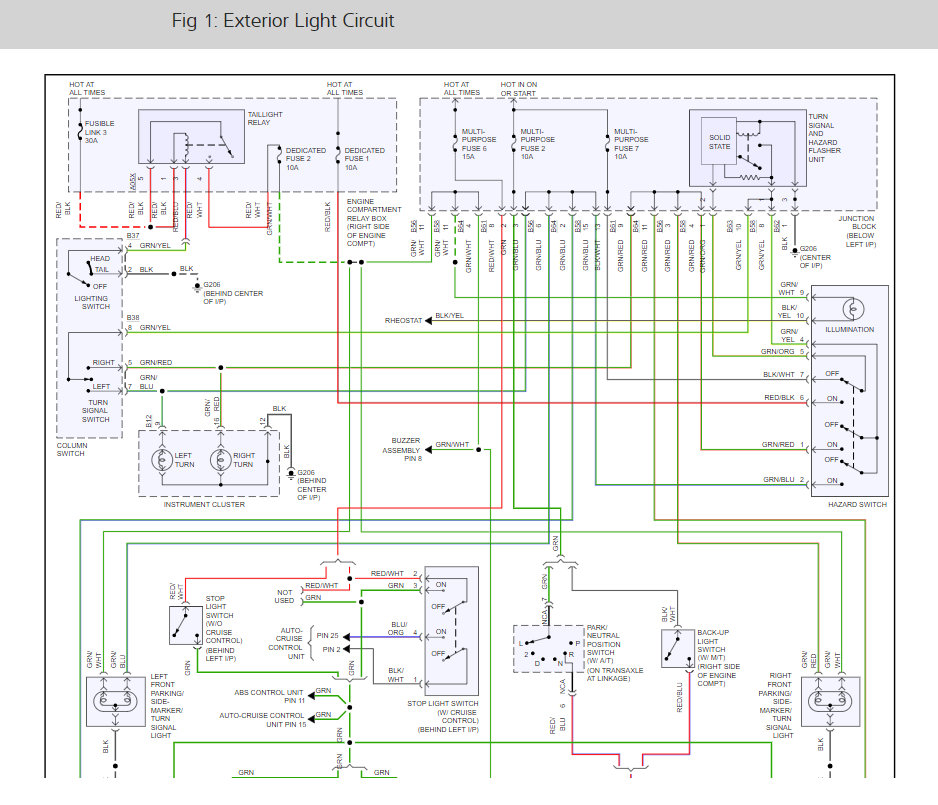

It looks like everything runs through the hazard switch. can you please cycle it back of forth many times to clean the contracts to see if the system works? Here is a guide to help you test for power and the blinker and brake light wiring diagrams to help you see how the system works and which wires to test for power:
