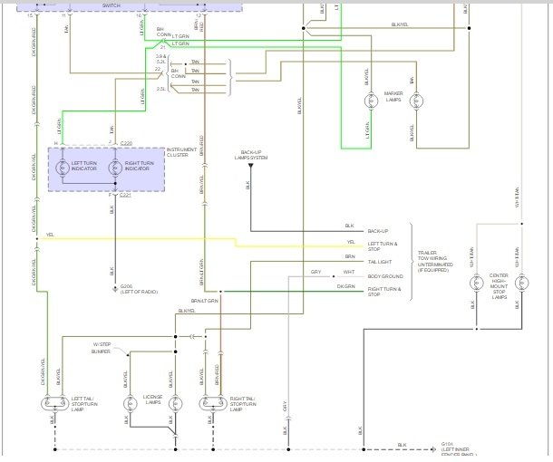

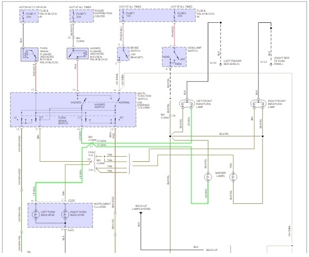

Here are two screenshots of your "exterior lights" from "Prodemand"
They overlap (it is all there!)
See the diagrams below.
Let me know if it helps.
Looks to me like a new light switch would be easier?
