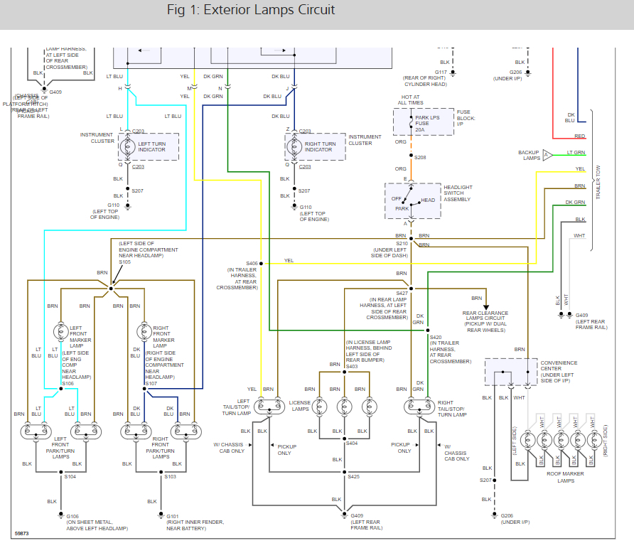

Only right turn signal works. fuse is good. Re-ran the wires and only shows 6 volts on volt meter.

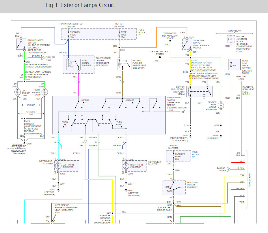

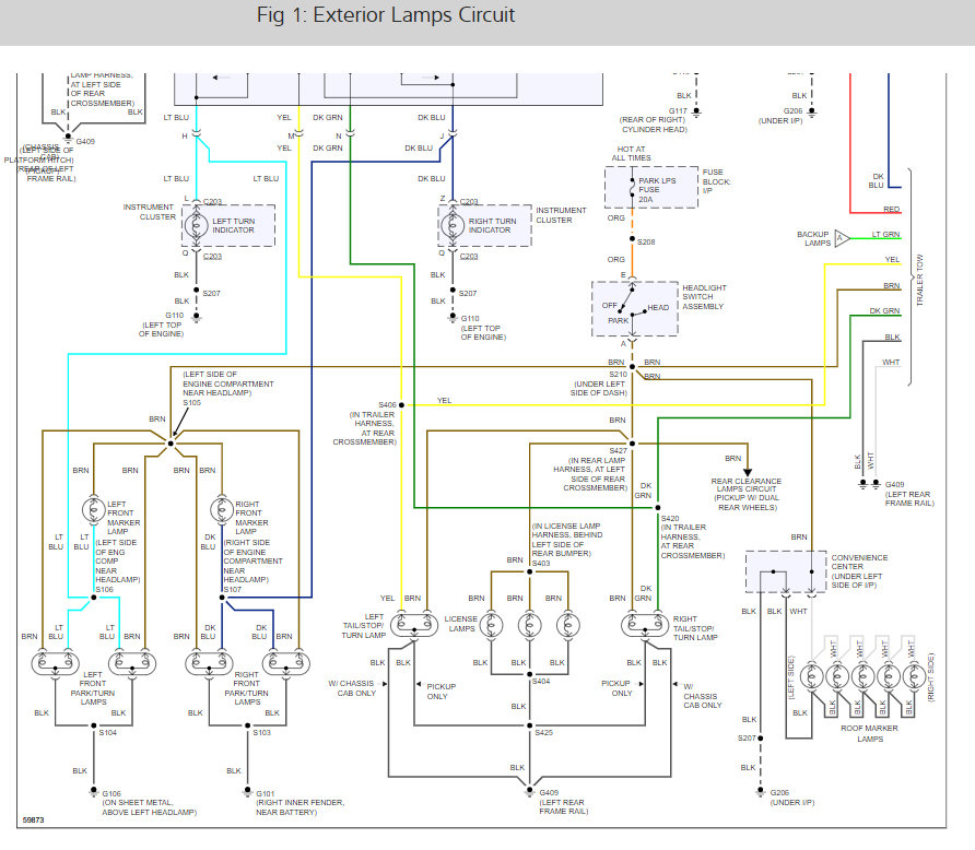

Here is a guide to help you with the issue with the tail light wiring diagrams below to show you what to test and how the system works:
