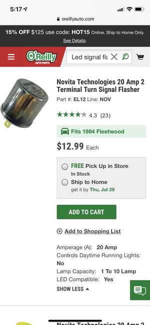

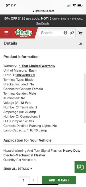

So I swapped out the signal flasher that you mentioned and nothing has changed. I only have the tail lights on LEDs. Do I need the front LED as well to make it work? They’re still incandescent up front. I attached a picture of what I bought.

I didn't realize the fronts were original. I can't guarantee it, but I know that mixing LEDs and standard lights doesn't work well. If you have the bulbs, I would try that to see if it makes a difference. Although the lights are in different places, they work off the same circuit. There is a good chance that is the cause.
As far as the flasher, that should work with LED lights, so keep it.
