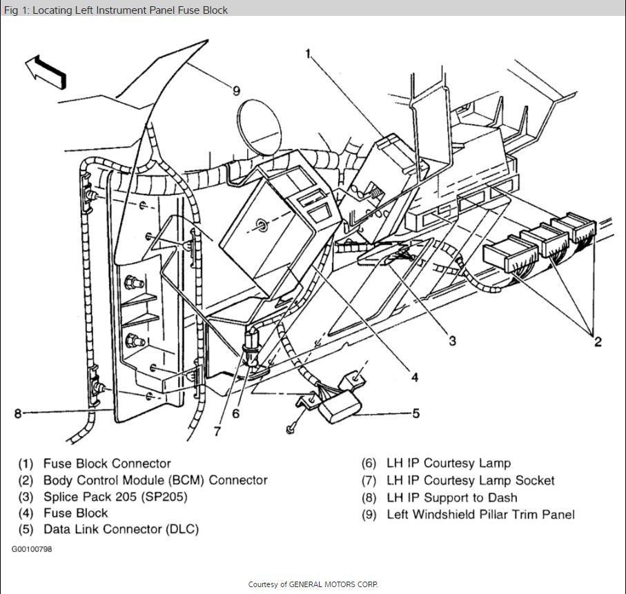

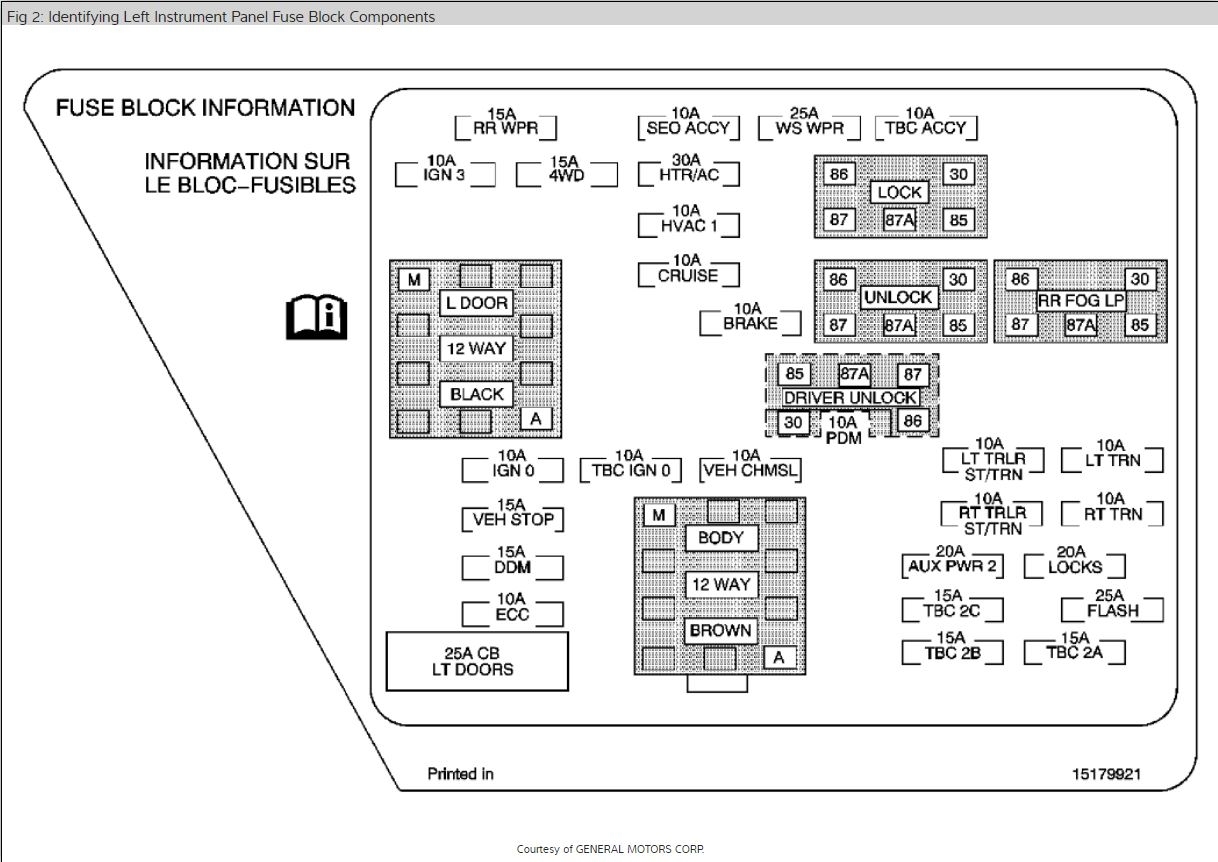

Check the "VEH CHMSL" fuse in the left I/P fuse block, located behind lower left side of dash. That is for the third brake light.

you are welcome. if you have a test light verify power to the third light socket. if no power, check the fuse.

VEH CHMSL in the fuse box. use a test light and make sure it has power on both sides with the brakes applied.

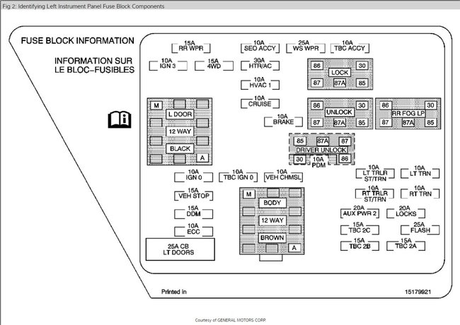

In the I/p fuse block shown and the fuse shown in the center shown as VEH CHMSL.
