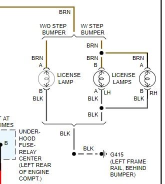

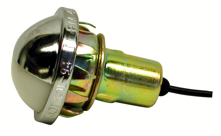

i have a 1996 K-1500 Chevrolet with the aftermarket bumper that has the two round push in tag light. The ones that if you live on dirt roads the get dirt and mud on them and they loose ground or the bulb shorts out. Well a very kind police officer informed me the other night that mine were not working. Luckily he has a similar truck and knows that they tend to do that so all I got was a warning. I was on the way to some friends and once there turned out they had one they bought for someone else's truck but ended up not using it. So I wired it up took some sandpaper to the hole and stuck it in but no go. On the way home i decided to see if I could eliminate the problem, So I soldered a wire to each of the sockets on the outside. I checked from the end of the wire to the socket and got 0 ohms resistance so I know the solder took hold. I put a bulb in each one and stopped under my hood and touched it to the battery. Both lights worked. Wired them in turned on the lights. No tag lights. I pulled out both bulbs and read 12 volts between the center contact and the socket on both put the bulb back in still no lights. Anybody got any ideas here because I am baffled. I tested them before I put them in and they worked. I have the right voltage but they do not work.
