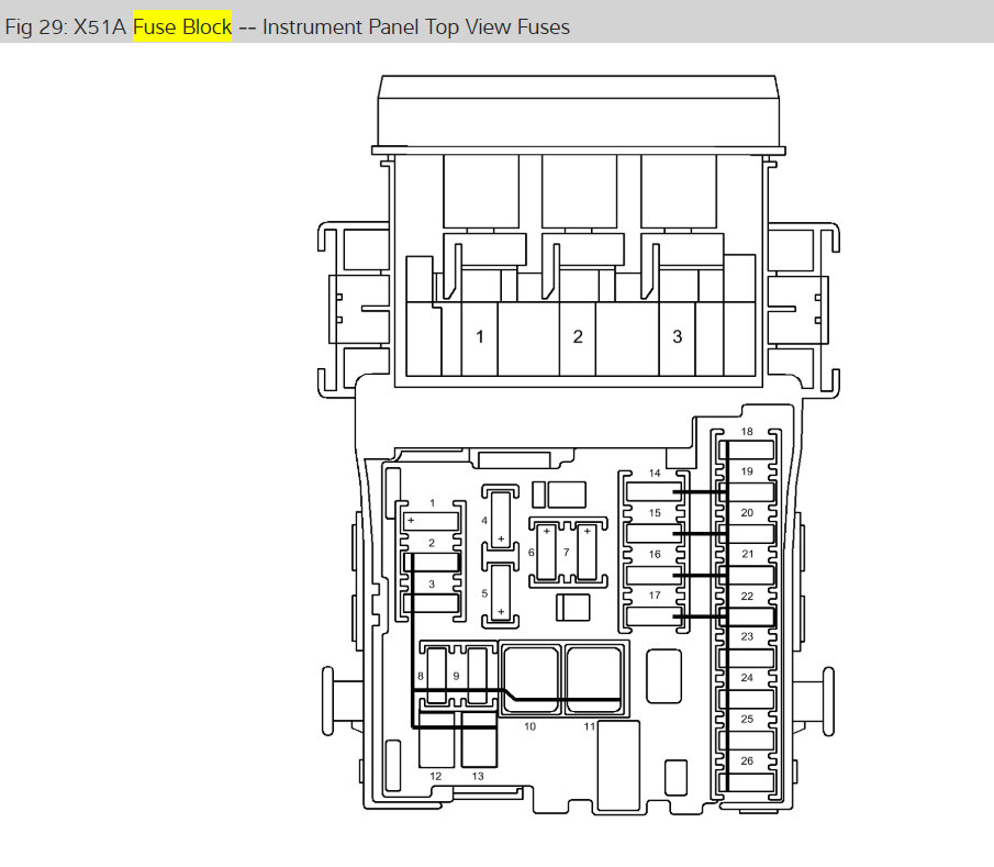

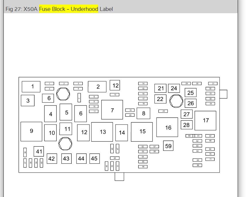

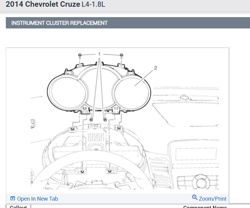

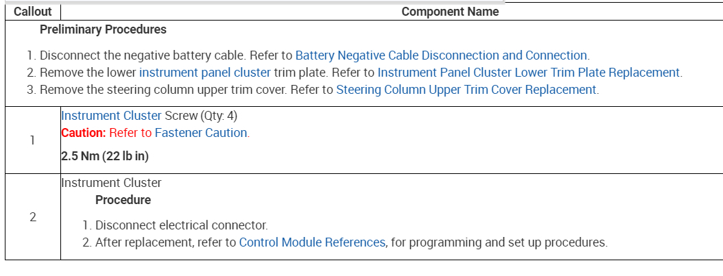

The instrument cluster has 3 fuses #21, #23 and #52 I would check those first, but chances are the cluster is going bad. Here is how you can check the fuses to make sure there is power and the fuse locations as well. Also, I have included how to change out the cluster to fix the problem.
Jun 1, 2022 at 12:04 PM
