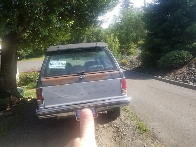

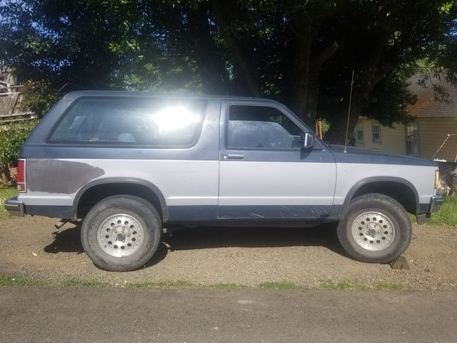

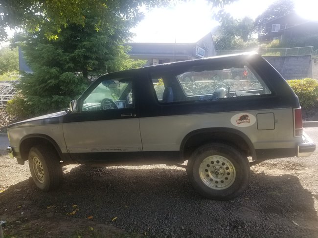

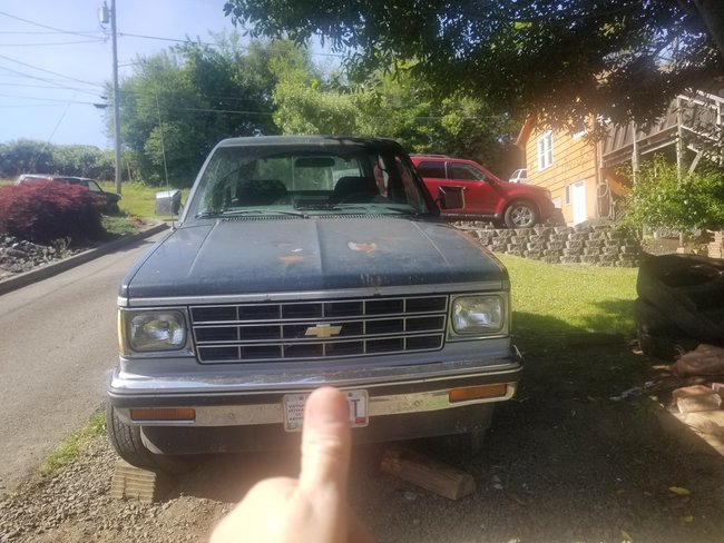

My vehicle is a 1983 . I'm thinking the wiring diagram is for a basic 1983 Chevrolet S10 Blazer 4x4/2.8L 6cyl Chevrolet S10 Blazer Tahoe Edition 2.8 liter 6 cyl 4x4 The owners Manual just says S10 on the front. I have found applications that say 1983 Chev S10 Blazer Tahoe Edition. The glove box says Tahoe on it. Can you recommend an effective surface rust treatment/remover or stabilizer to use so the surface rust doesn't continue getting worse. Thank you for you time, You are much appreciated 2carpros.com
