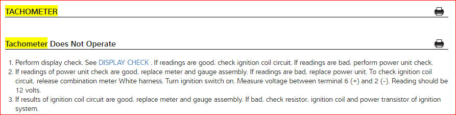

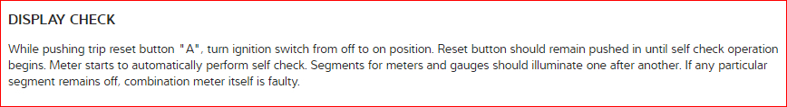

I am not sure how to fix it. Can someone please help me?

Hello, I'm Danny.
I've attached two pictures below showing what to check for. Here also is a tutorial showing how to check wiring:
Hope this helps and thanks for using 2CarPros.
