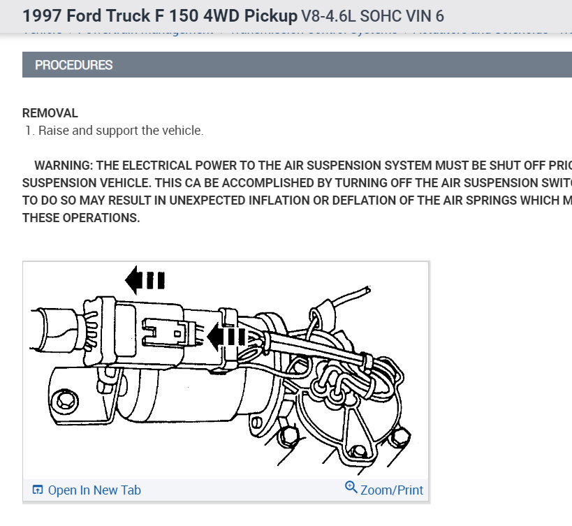

Is there a way to disengage the 4 Low manually?
Feb 21, 2023 at 2:13 PM

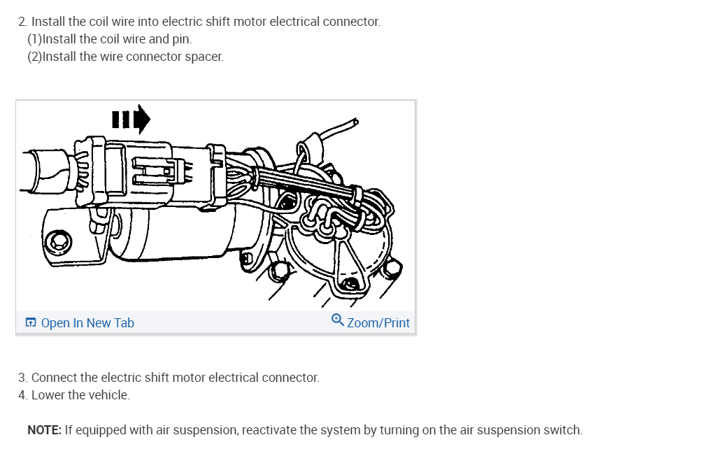

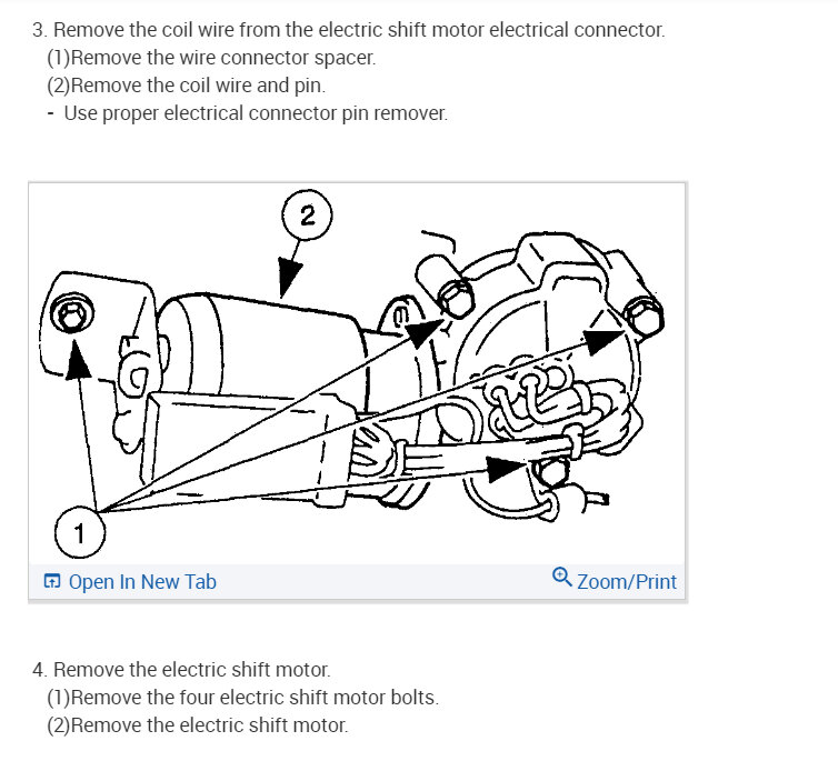

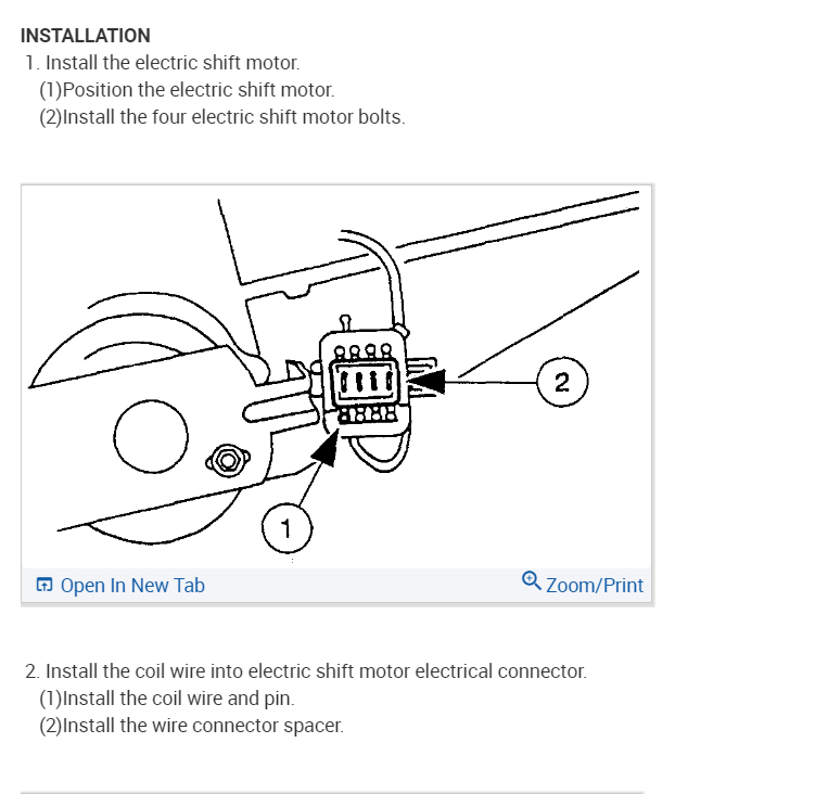

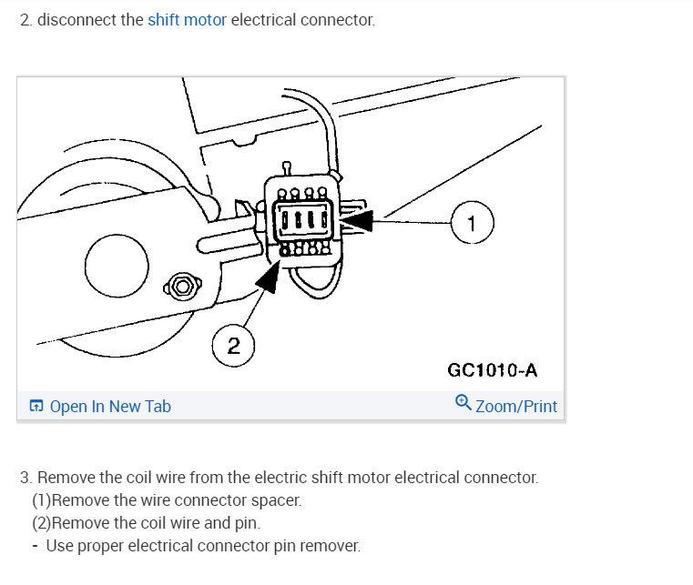

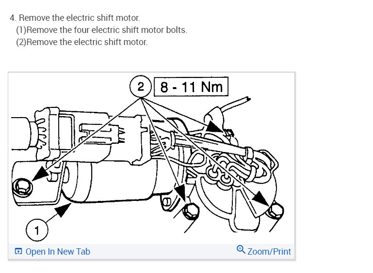

Yes, you can remove the transfer case shift actuator and move the shift shaft into position by using a flat blade screwdriver. Here is the location of the actuator so you can remove it. Here are instructions for the replacement in the images below. Please let me know how it goes.
