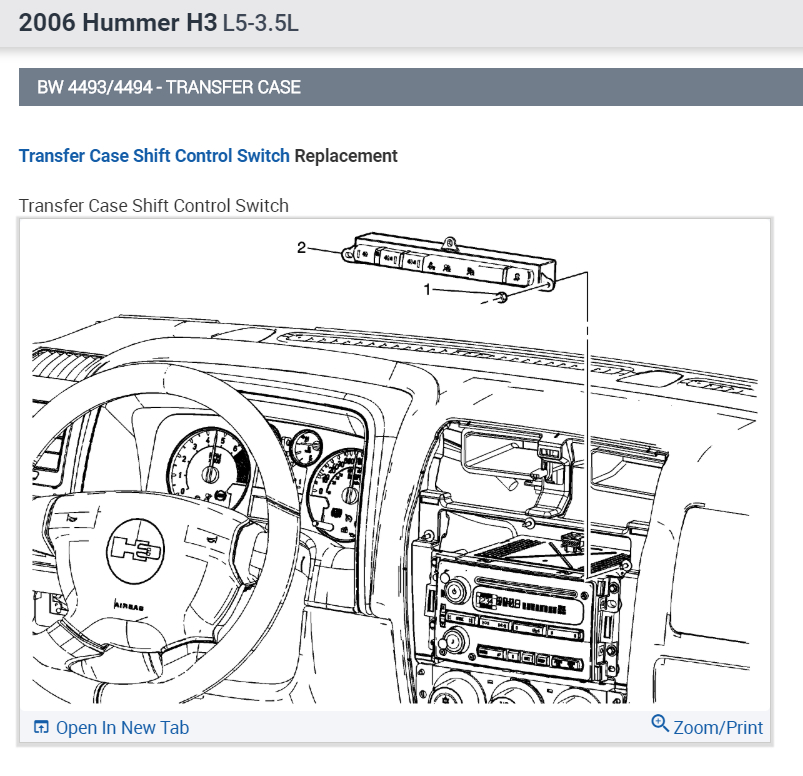

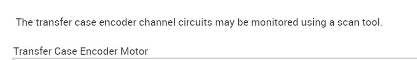

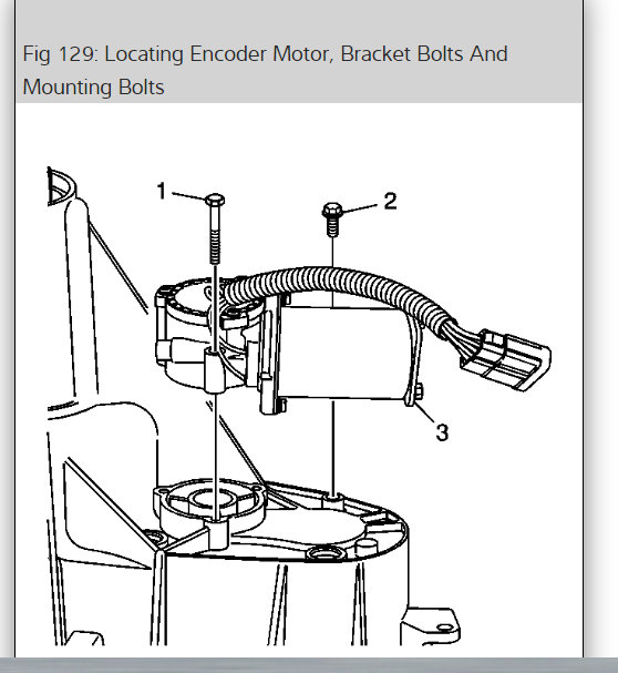

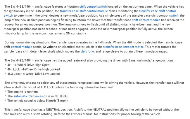

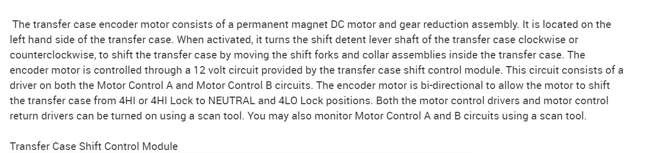

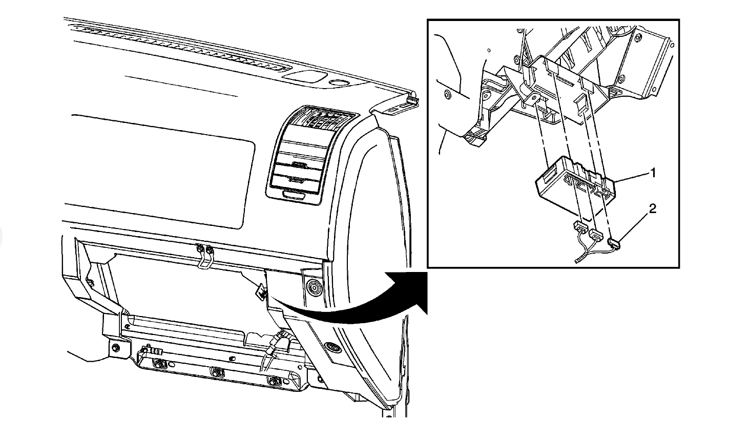

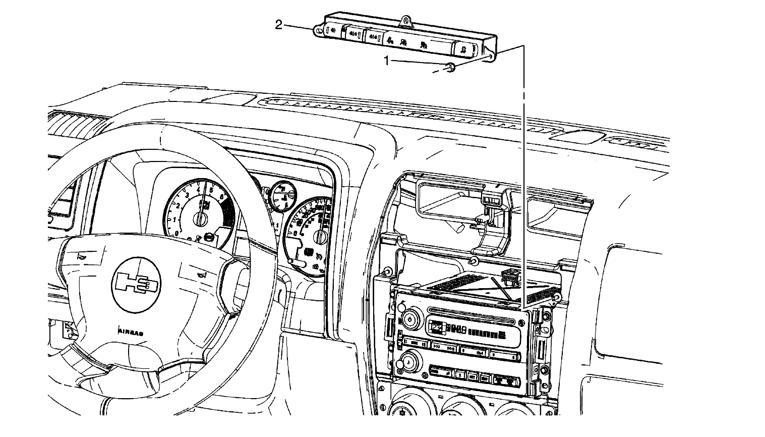

If the switch goes bad it will self activate. I would replace it first, the encoder will not operate unless the switch activates. Check out the diagrams (below). Please let us know what you find. We are interested to see what it is.
Jun 12, 2019 at 4:54 PM

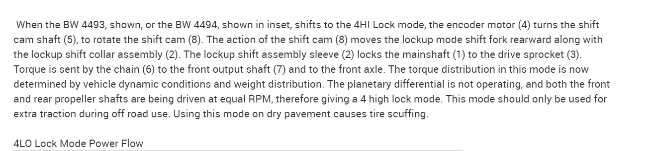

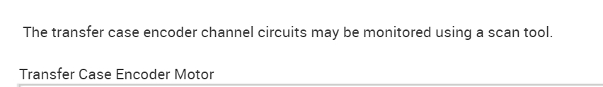

Jun 12, 2019 at 5:57 PM

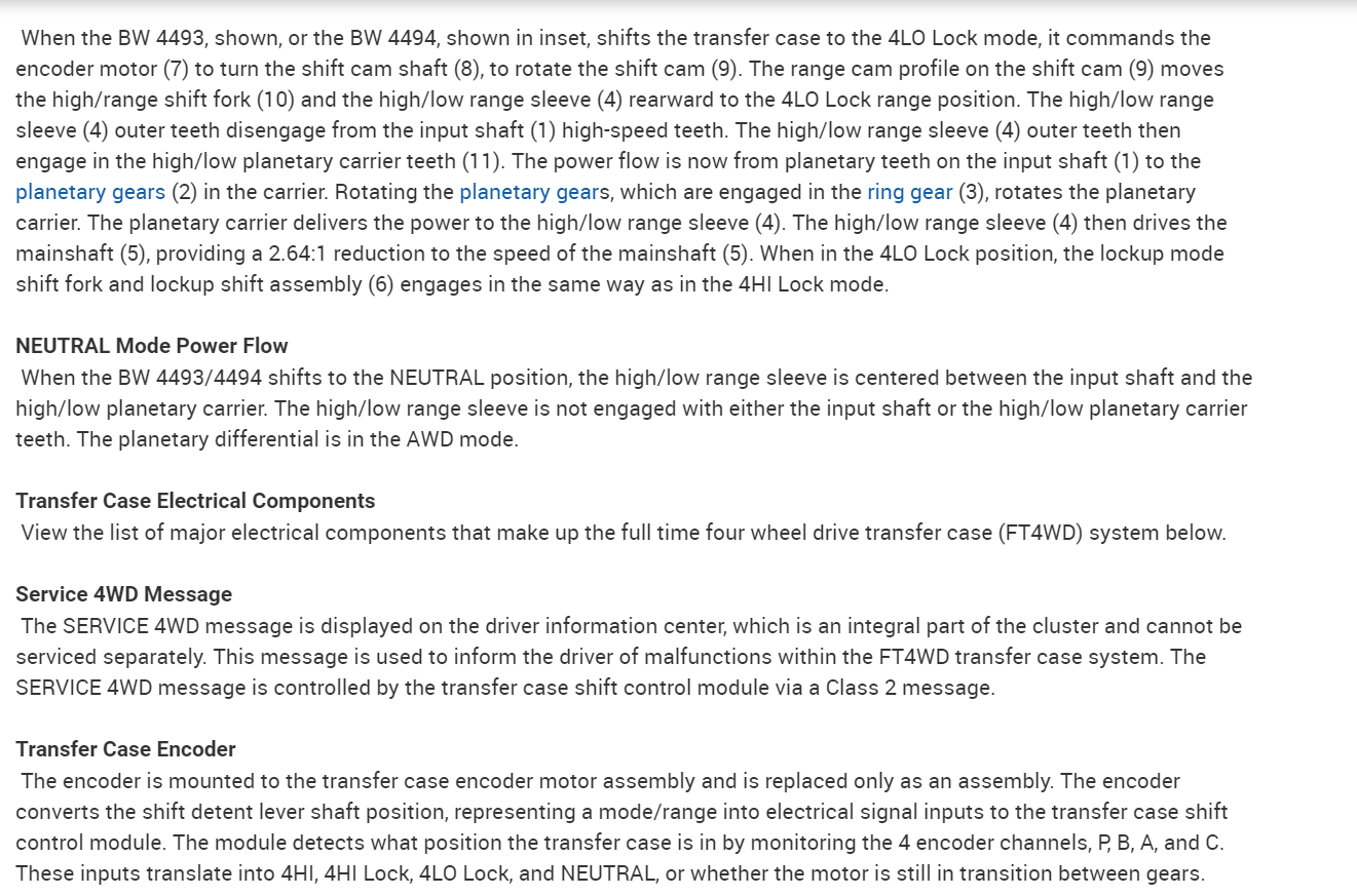

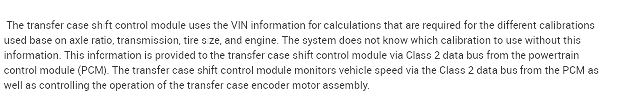

SCGRANTURISMO
  • 4,897 POSTS

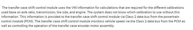

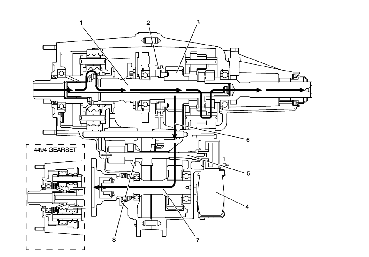

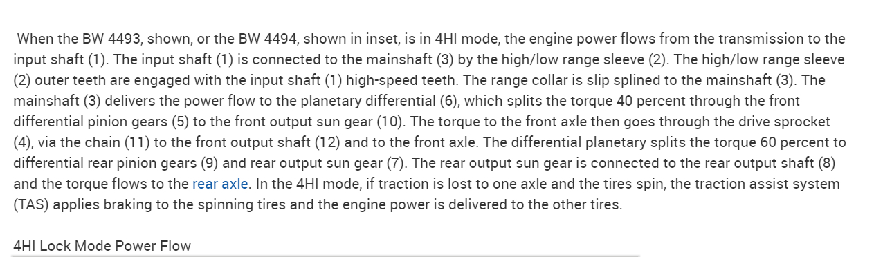

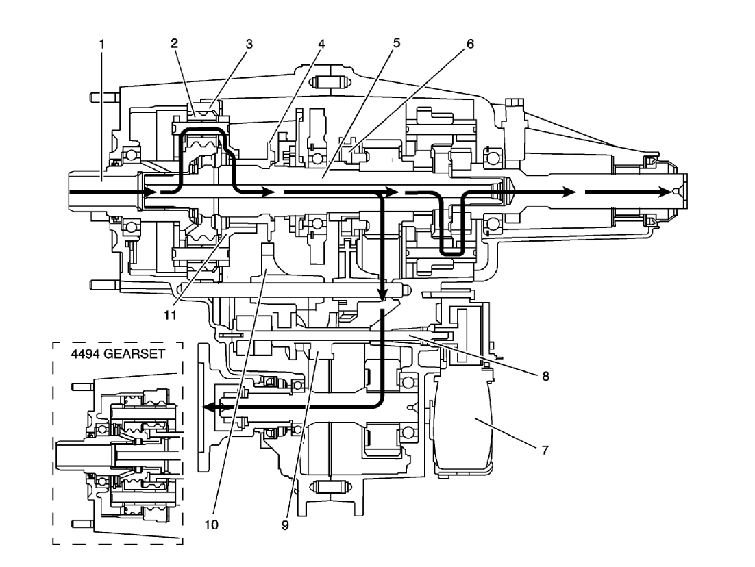

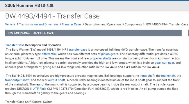

Hello again,

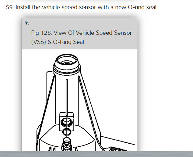

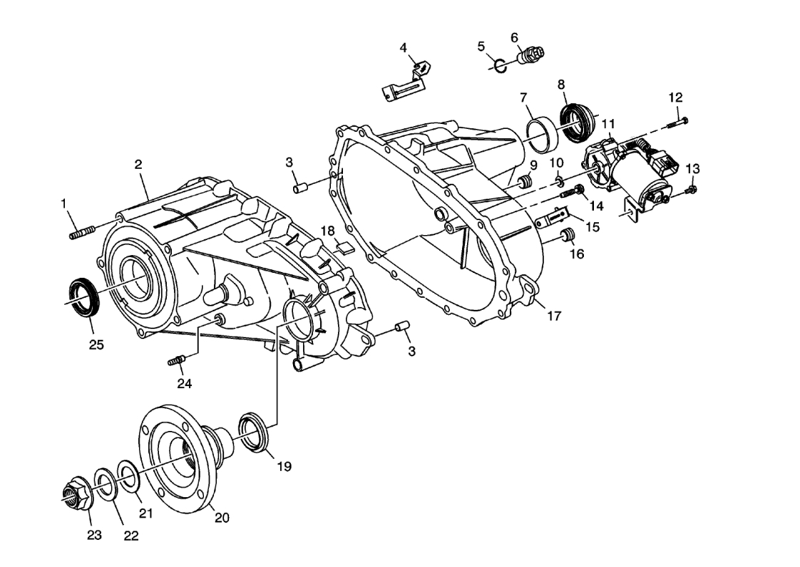

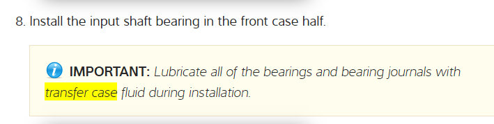

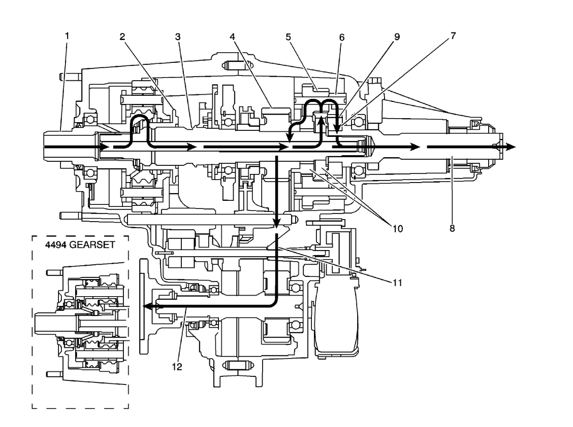

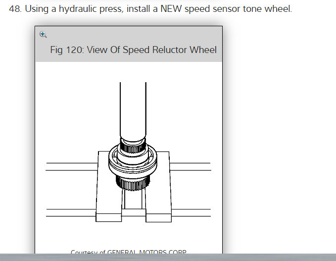

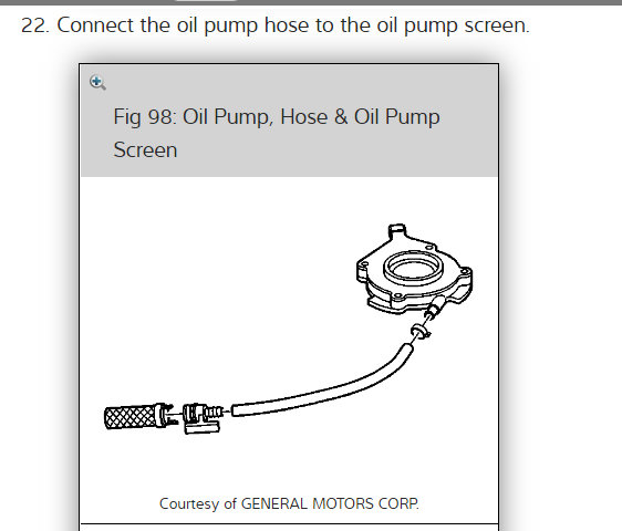

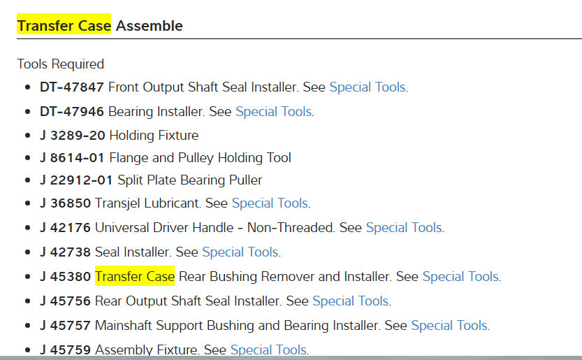

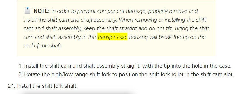

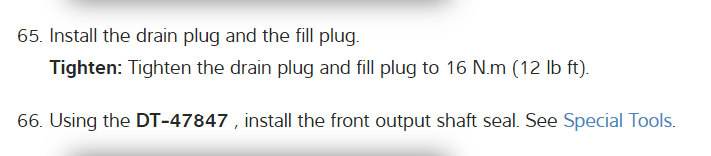

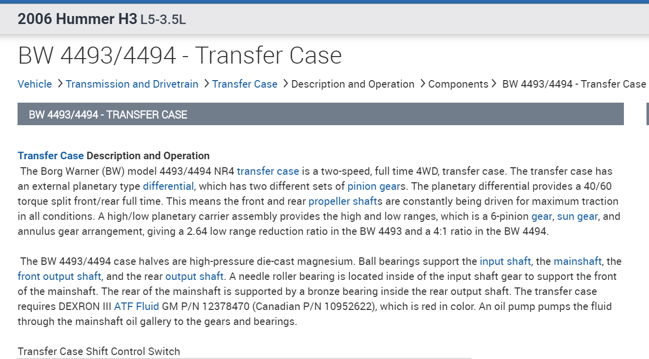

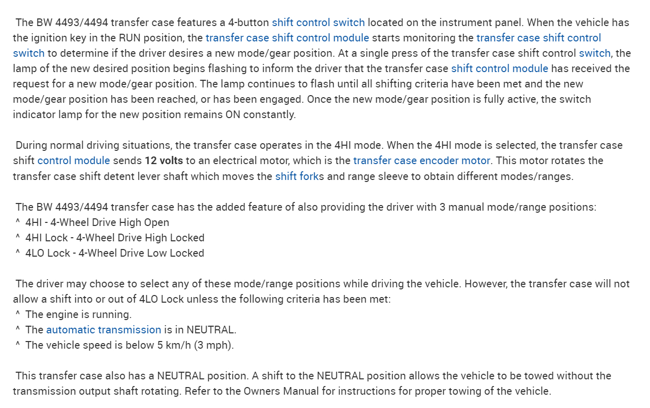

Okay, here is everything that there is to know about your vehicle's Transfer Case. The best part about the information that I included in the diagrams down below for you, is that this information isn't hype or speculation, but a description of how the component and related sub components work and work together from the vehicle manufacturer themselves. No guessing or misinformation here. Please go through this information and get back to us with what you find out.
Thanks,
Alex
2CarPros

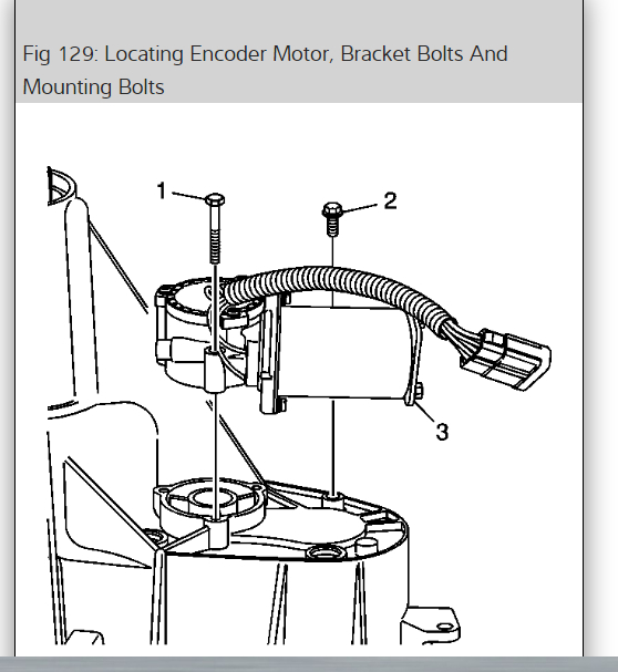

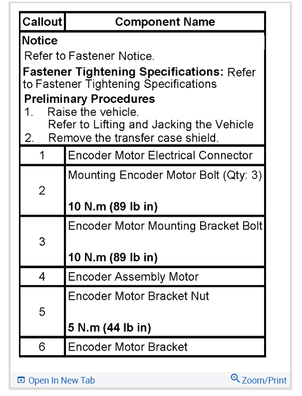

I have a risen question.

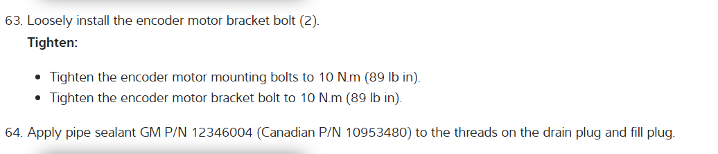

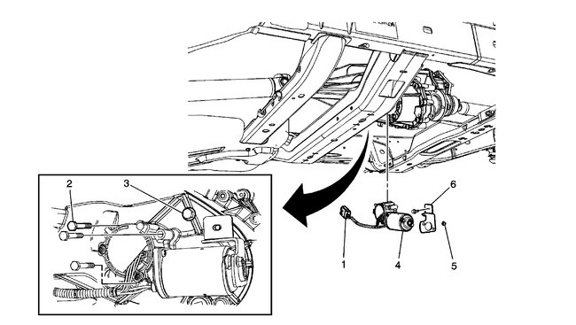

in case that I need to replace the encoder motor, what if it is in a different position than the T-Case?
can I connect it to the harness and start on the truck without to hook it up to the T-Case ?
BR
Jun 13, 2019 at 10:21 AM
Yes, you can match the encoder motor position before installing it. That way when installed you can use the switch to check it to the desired position.

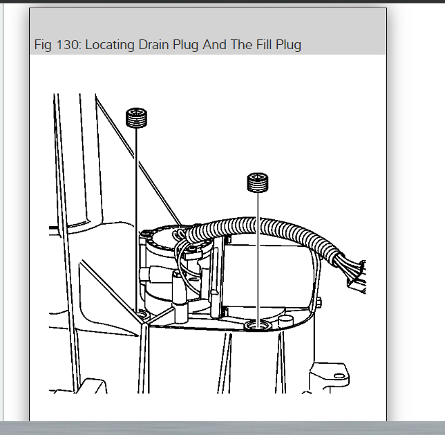

Two questions
Do I have to drain the TCase before the encoder replacement?

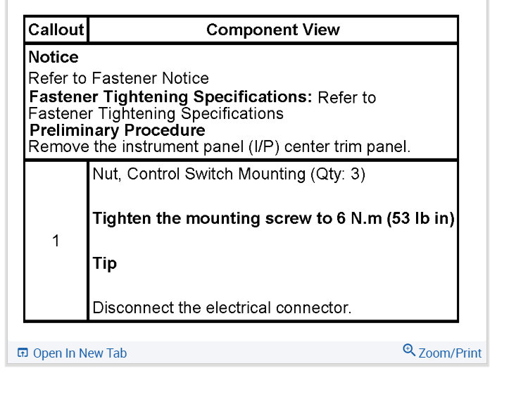

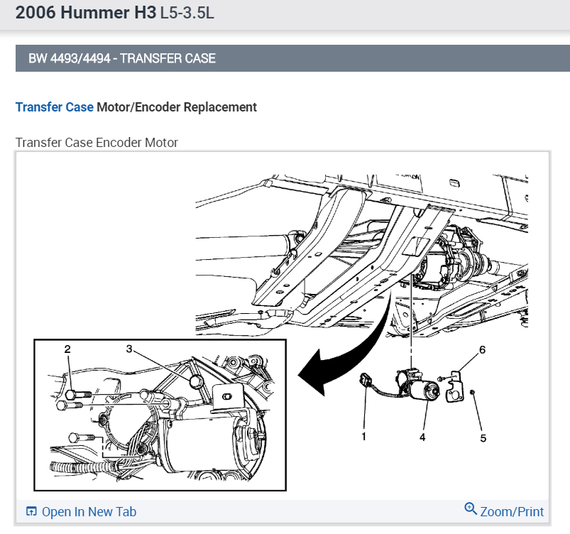

Jun 25, 2019 at 7:48 AM

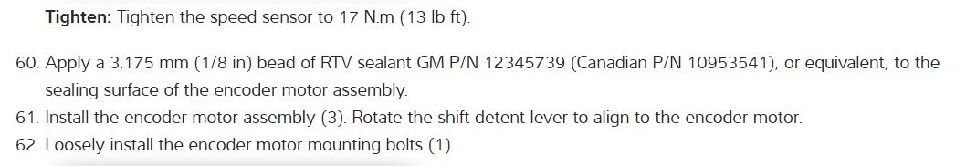

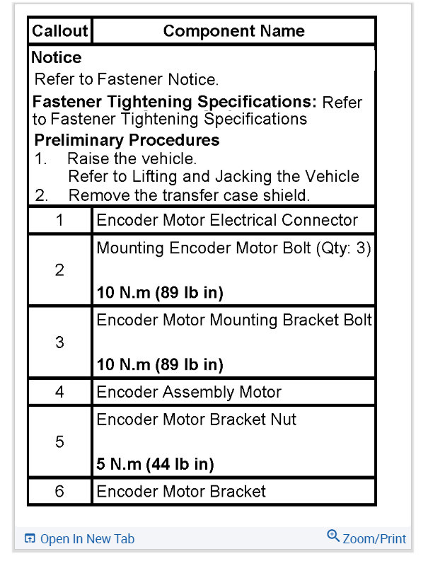

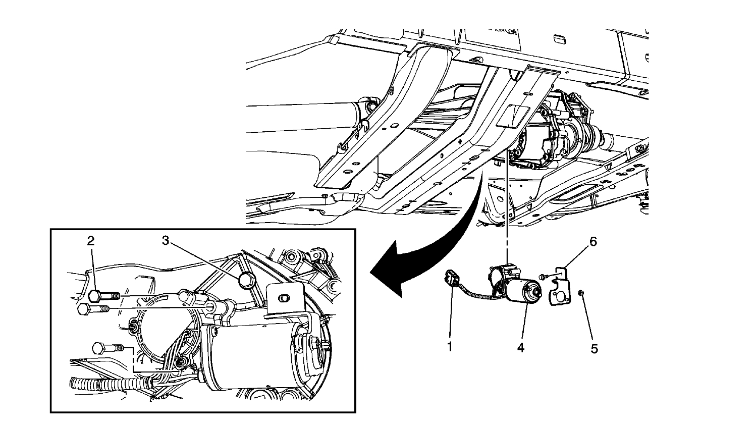

I don't think so. here are the instructions on how to replace the encoder I don't see any relearn notes. Check out the diagrams (below). Please let us know what happens.

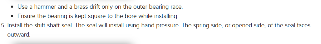

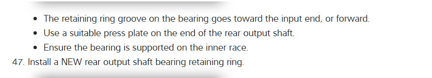

JULIOLOP
  • 18 POSTS

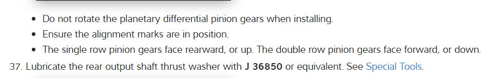

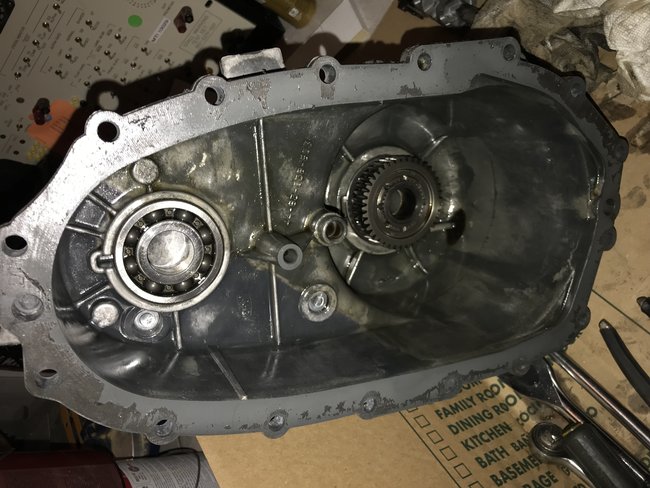

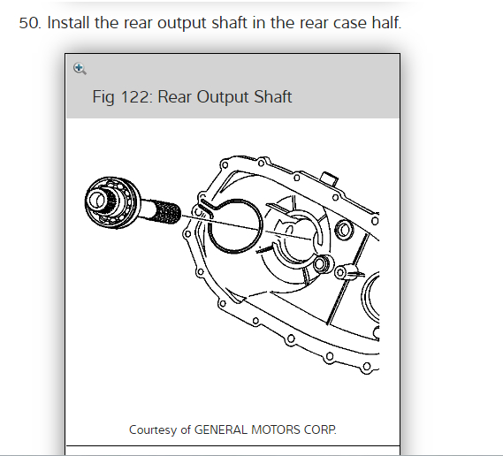

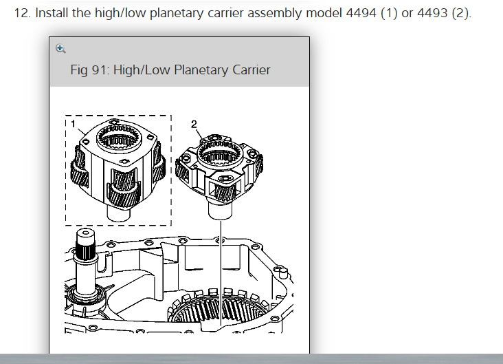

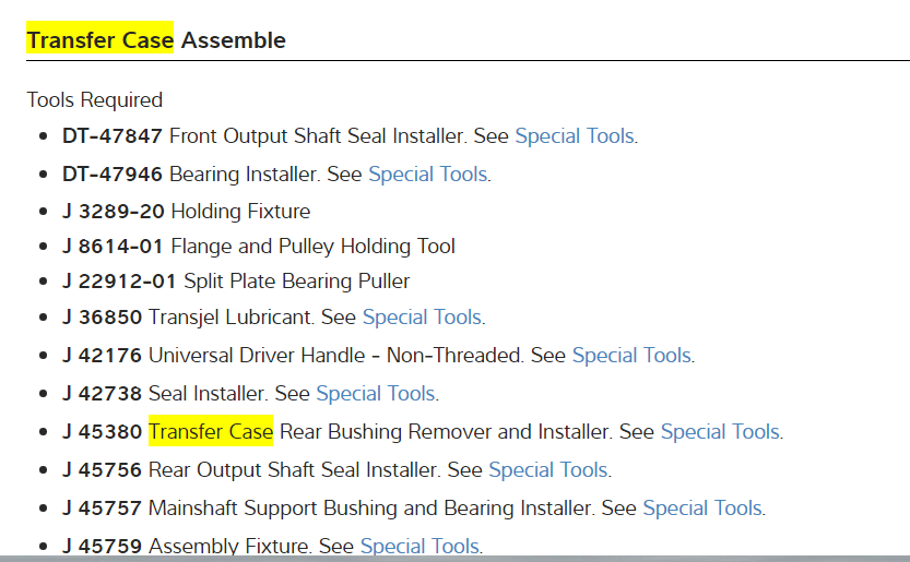

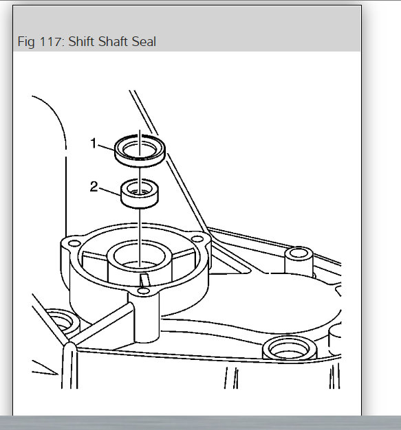

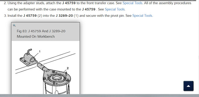

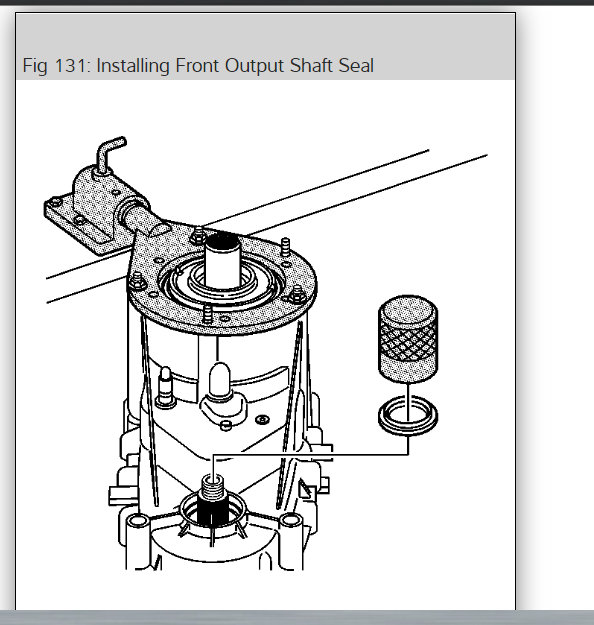

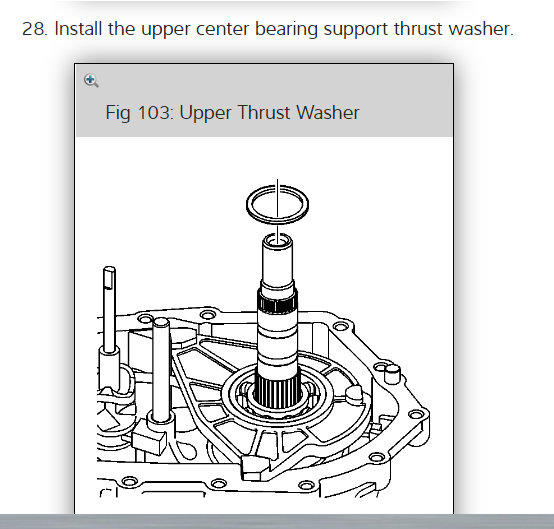

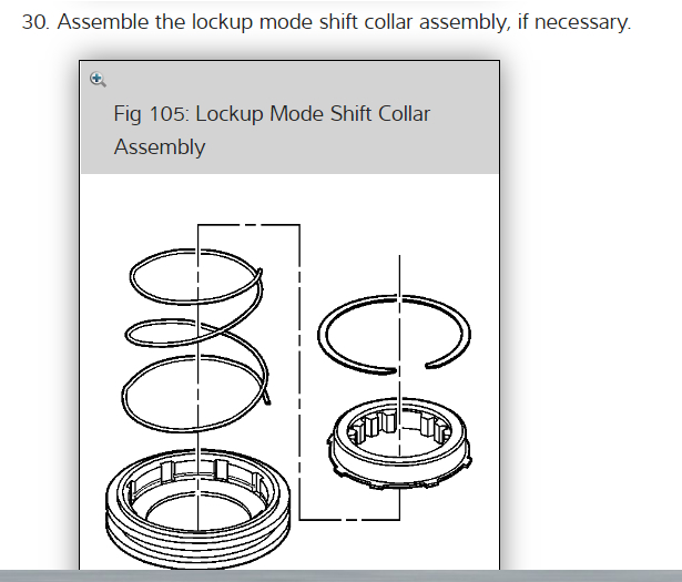

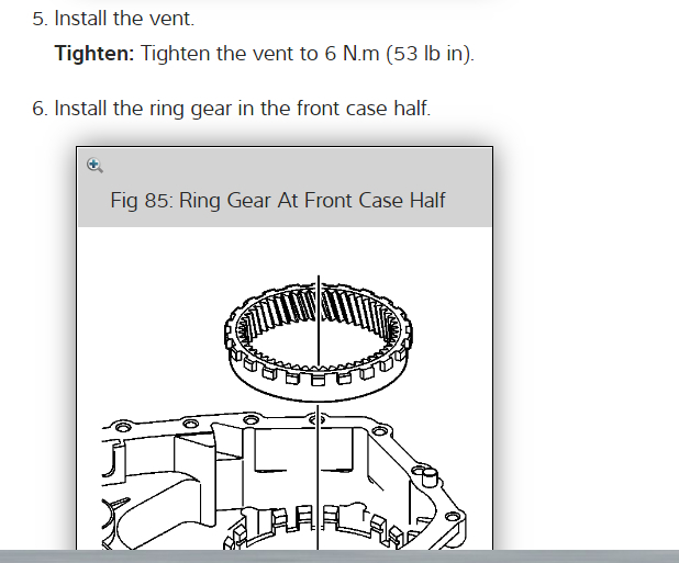

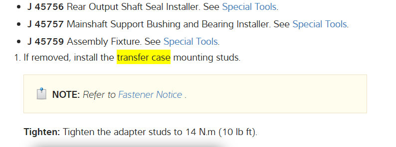

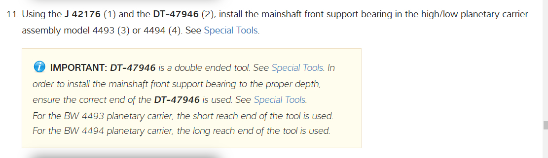

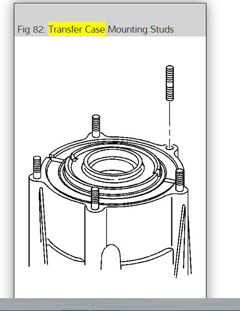

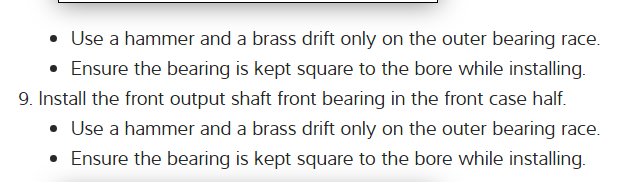

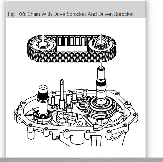

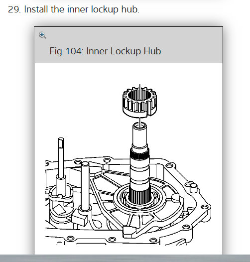

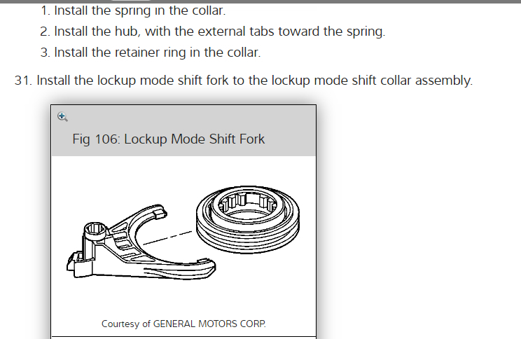

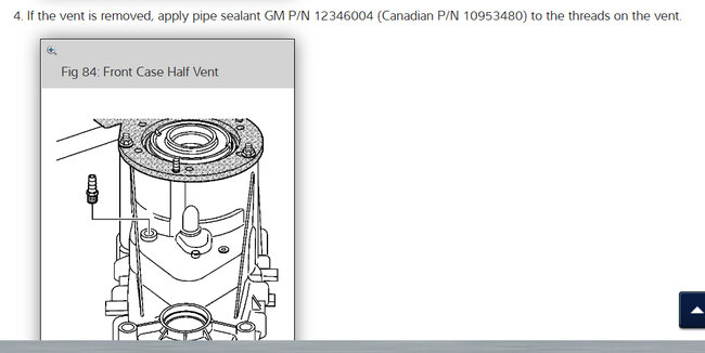

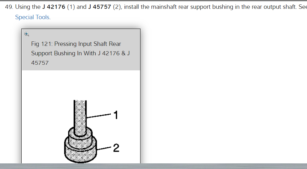

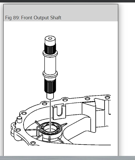

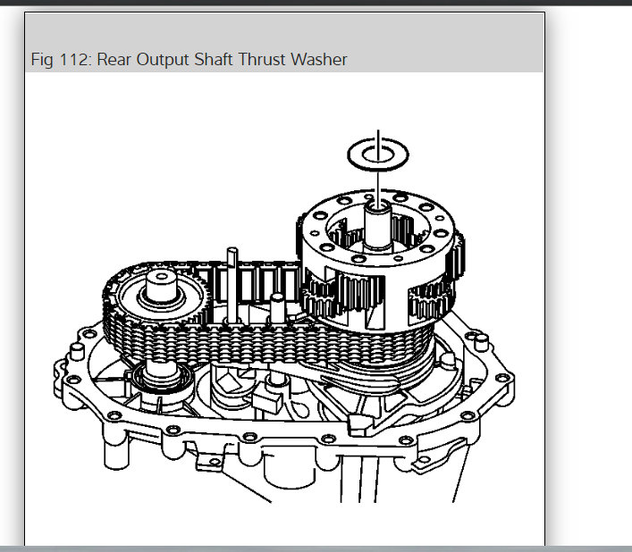

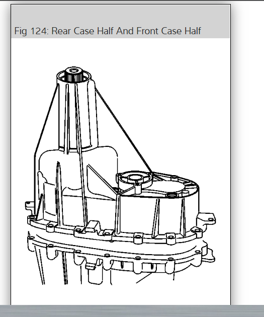

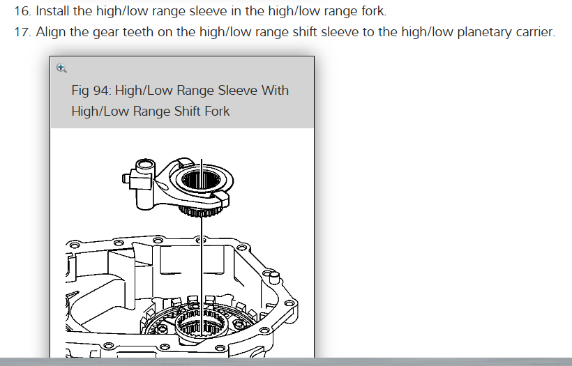

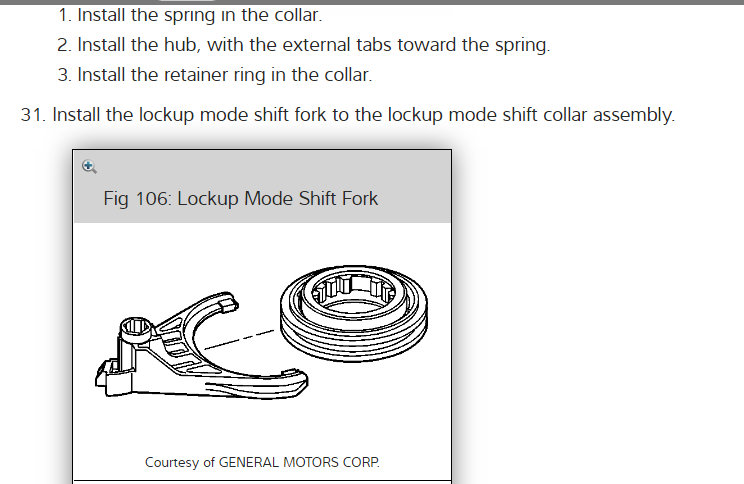

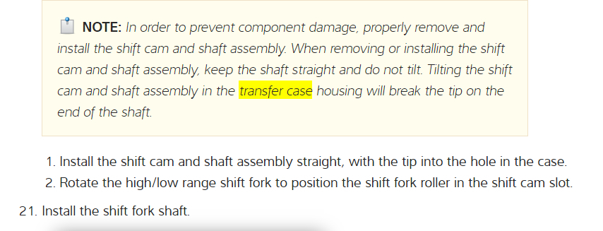

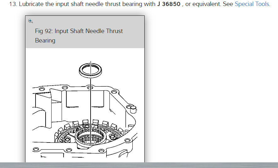

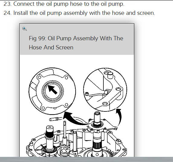

okay, transfer case down, open and verified defective plastic fork (replaced).
my concern now is how to put back the piece that move the fork, any suggestion or it is easy?
Jul 19, 2019 at 5:16 AM

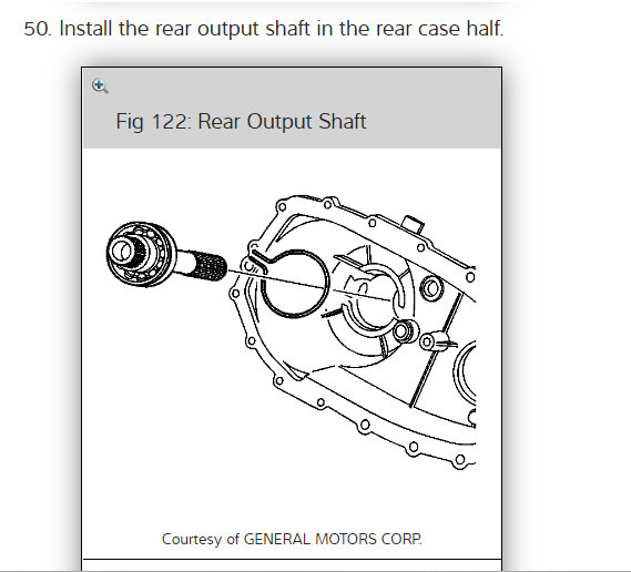

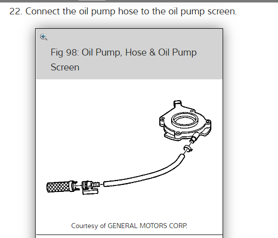

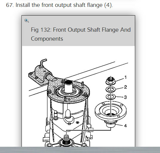

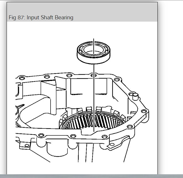

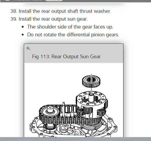

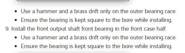

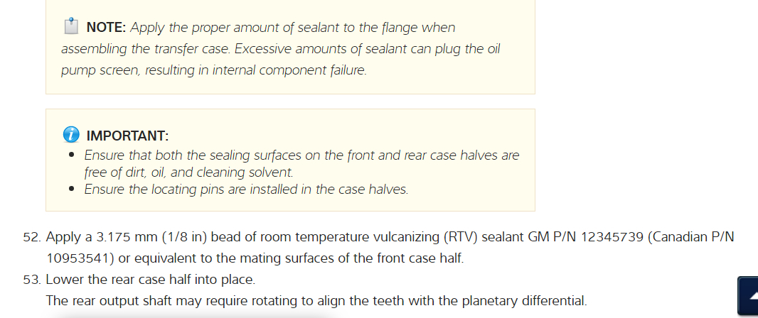

SCGRANTURISMO
  • 4,897 POSTS

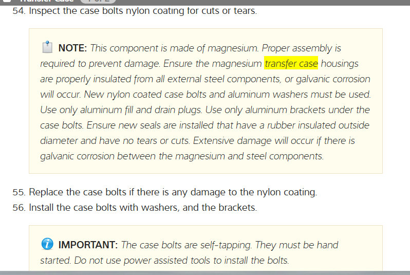

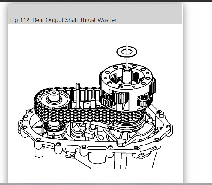

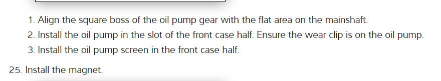

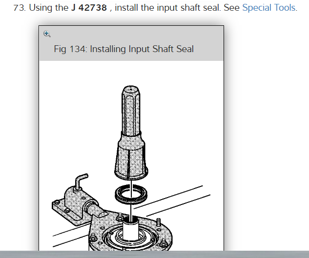

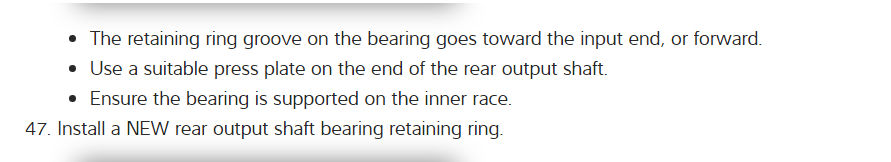

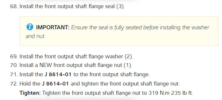

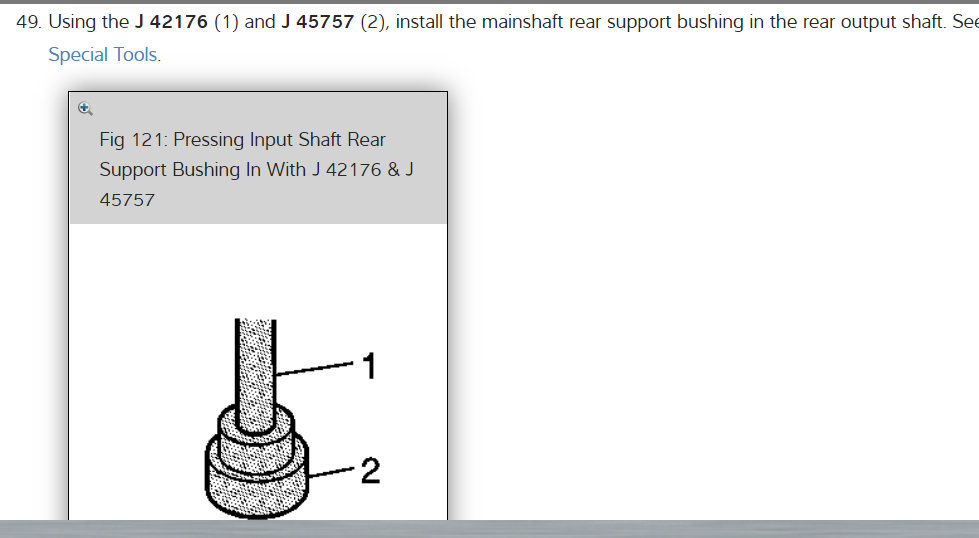

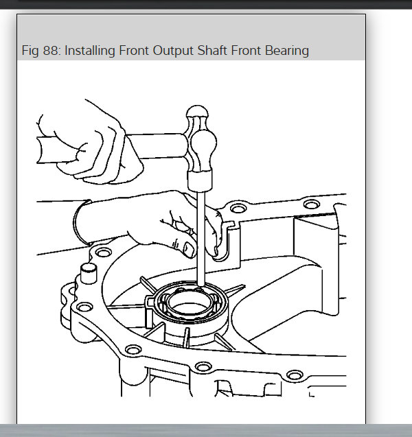

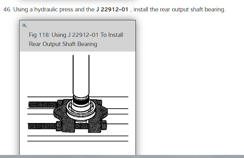

Hello again,

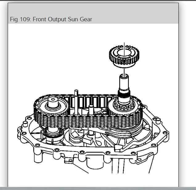

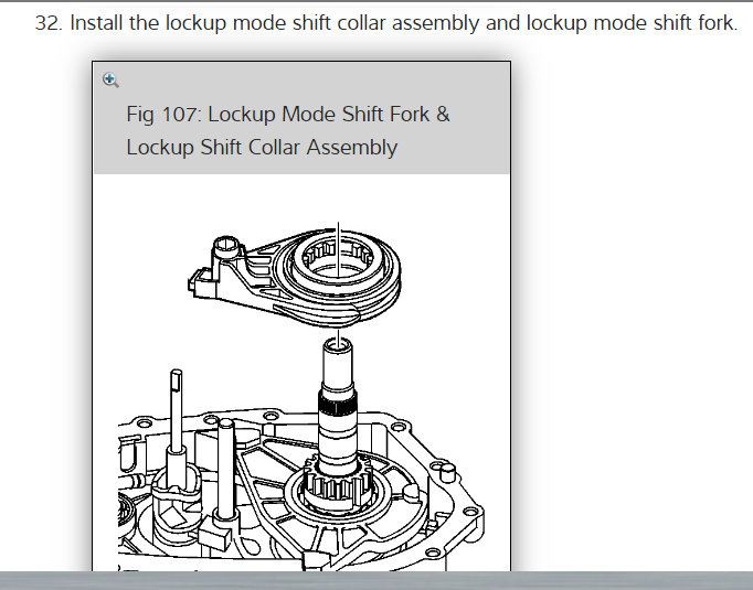

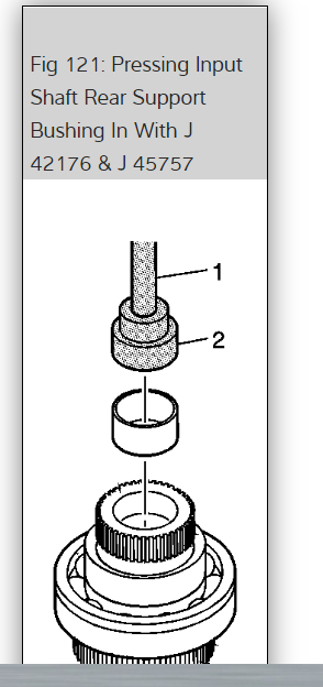

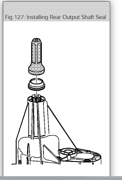

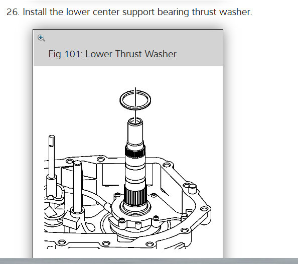

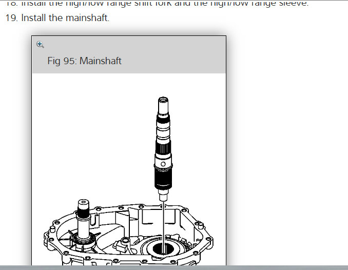

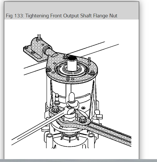

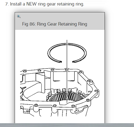

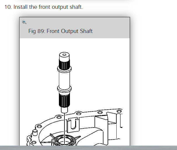

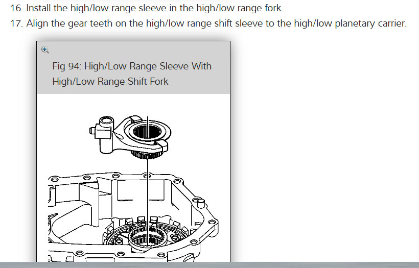

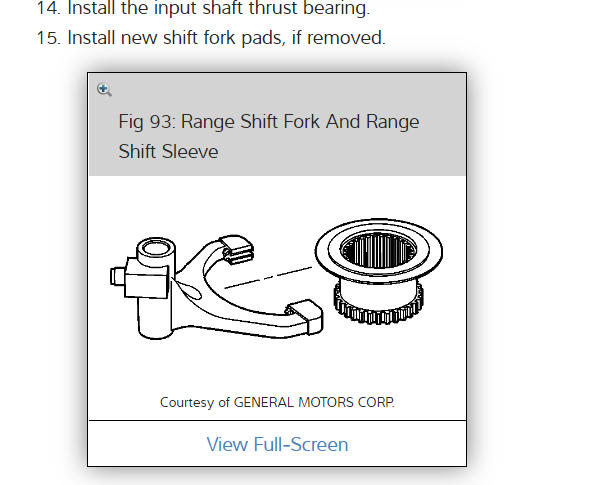

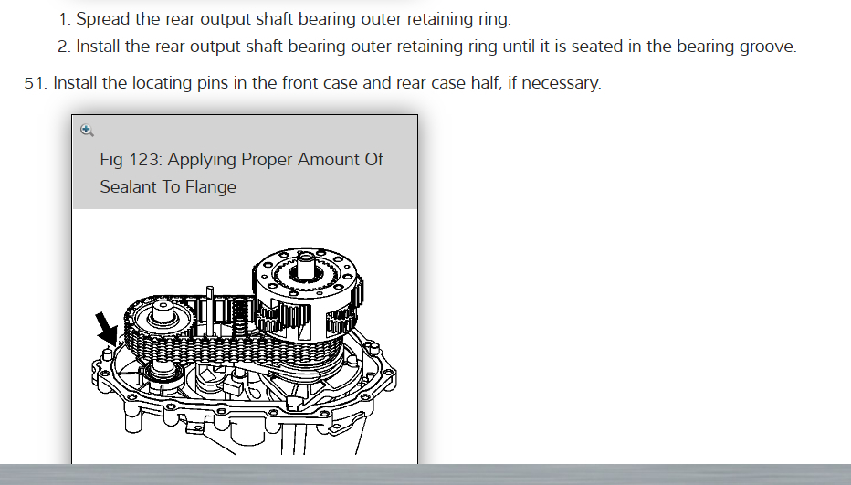

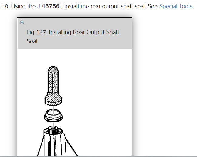

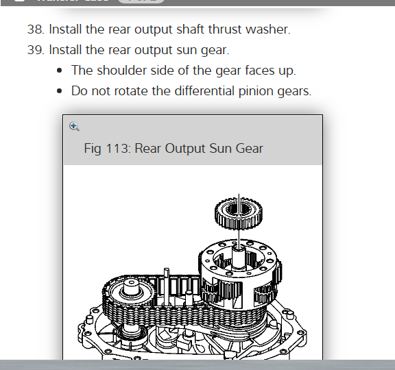

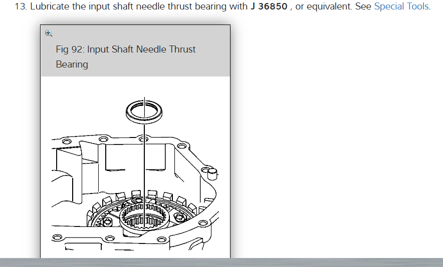

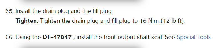

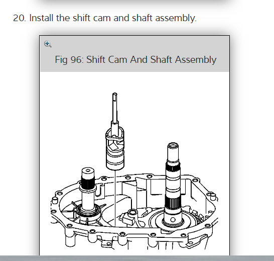

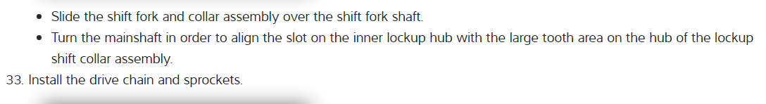

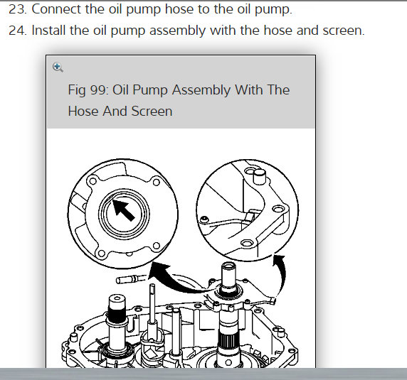

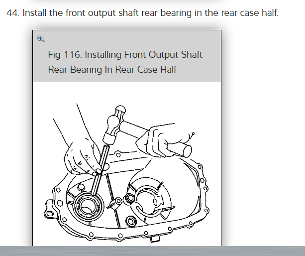

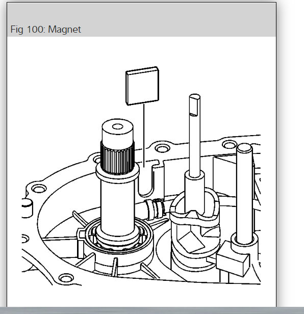

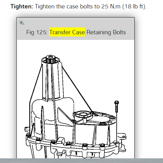

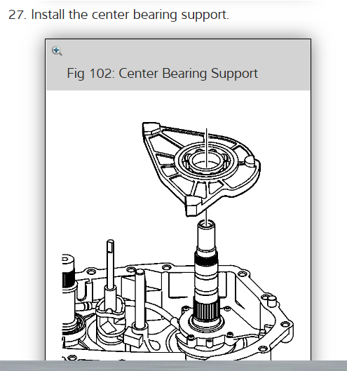

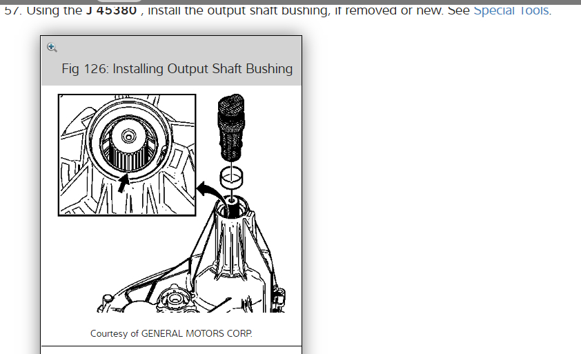

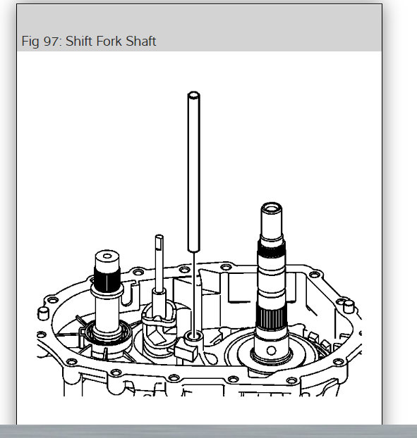

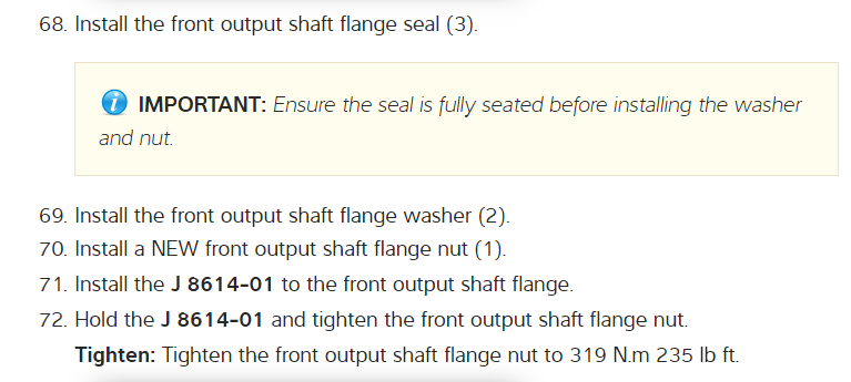

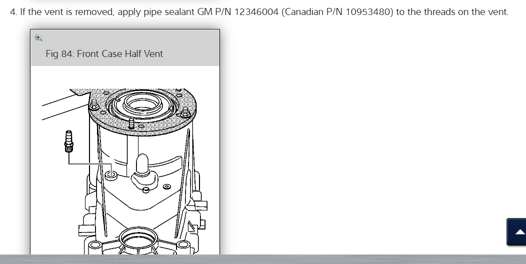

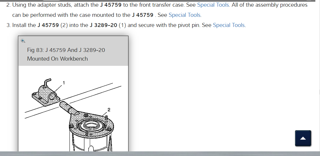

Okay, In the diagrams down below I have included the entire directions from the vehicle manufacturer for the assembly of your vehicle's transfer case. Please go through this guide and get back to us with how everything goes reassembling it.
Thanks,
Alex
2CarPros

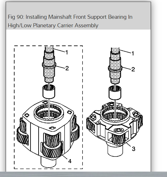

Jul 19, 2019 at 6:41 AM
JULIOLOP
  • 18 POSTS
Alex, thanks for your prompt answer.
do you have all this in just one PDF?

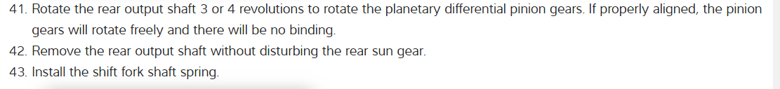

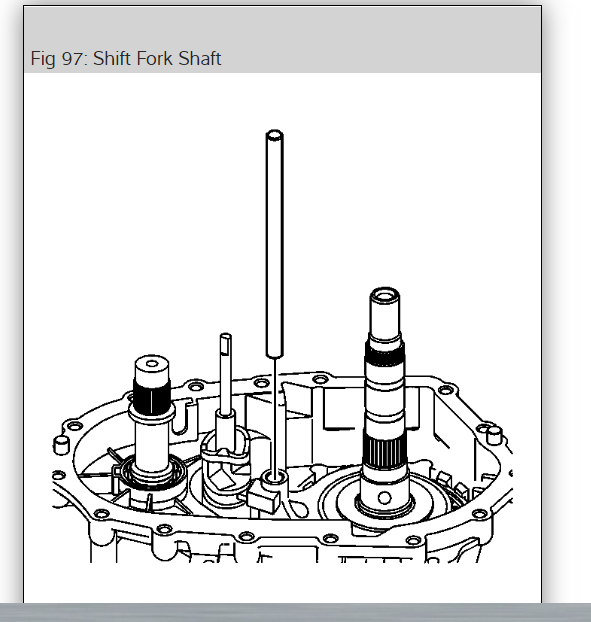

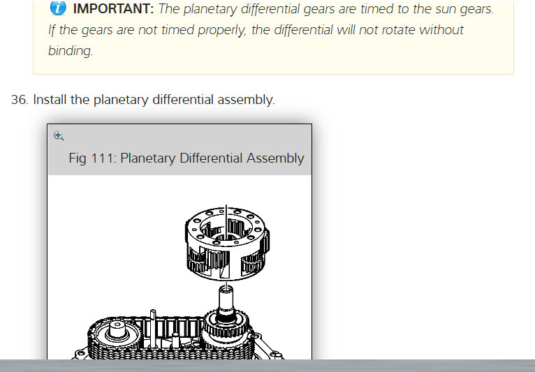

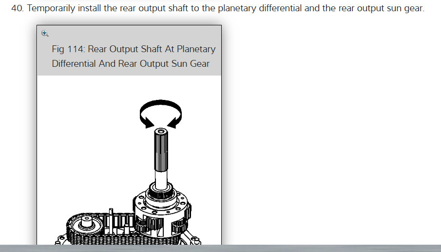

now I have several doubts.

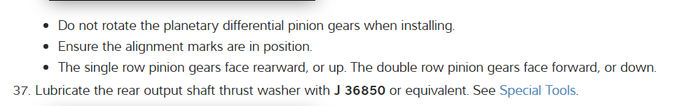

I can see nothing related to the shaft I asked, the one that is moved by the encoder, and in the planetary I only have marks in two gears, is it okay?
Jul 19, 2019 at 9:01 AM
sounds right can you upload a picture of what you are talking about?
Jul 22, 2019 at 11:19 AM

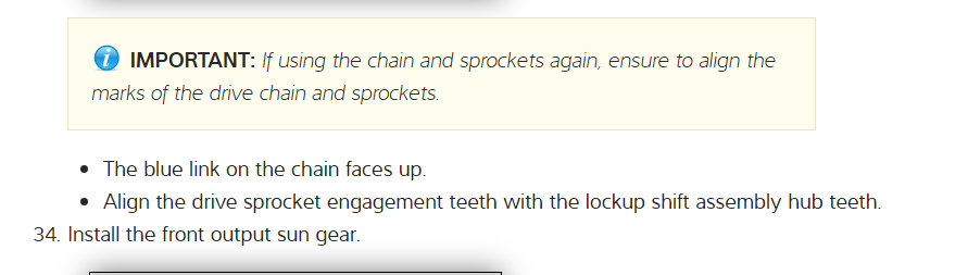

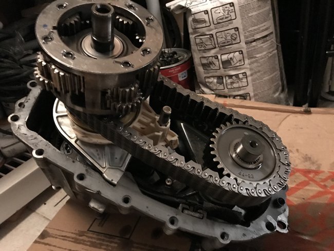

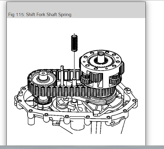

JULIOLOP
  • 18 POSTS

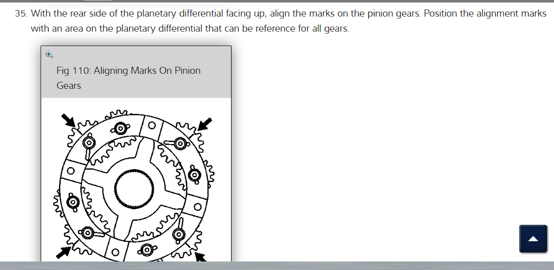

to place the sprocket inside that planetary gears assy you can see in the picture on top of the chain has been very difficult
following the manual you have marks in the four upper gears,
Jul 22, 2019 at 12:11 PM
Sorry, I am not sure what you are saying, there is no timing for these gears, can you be more specific, what is the problem ?
Jul 23, 2019 at 12:08 PM
JULIOLOP
  • 18 POSTS
Okay Ken,
Work is done and it looks okay.
