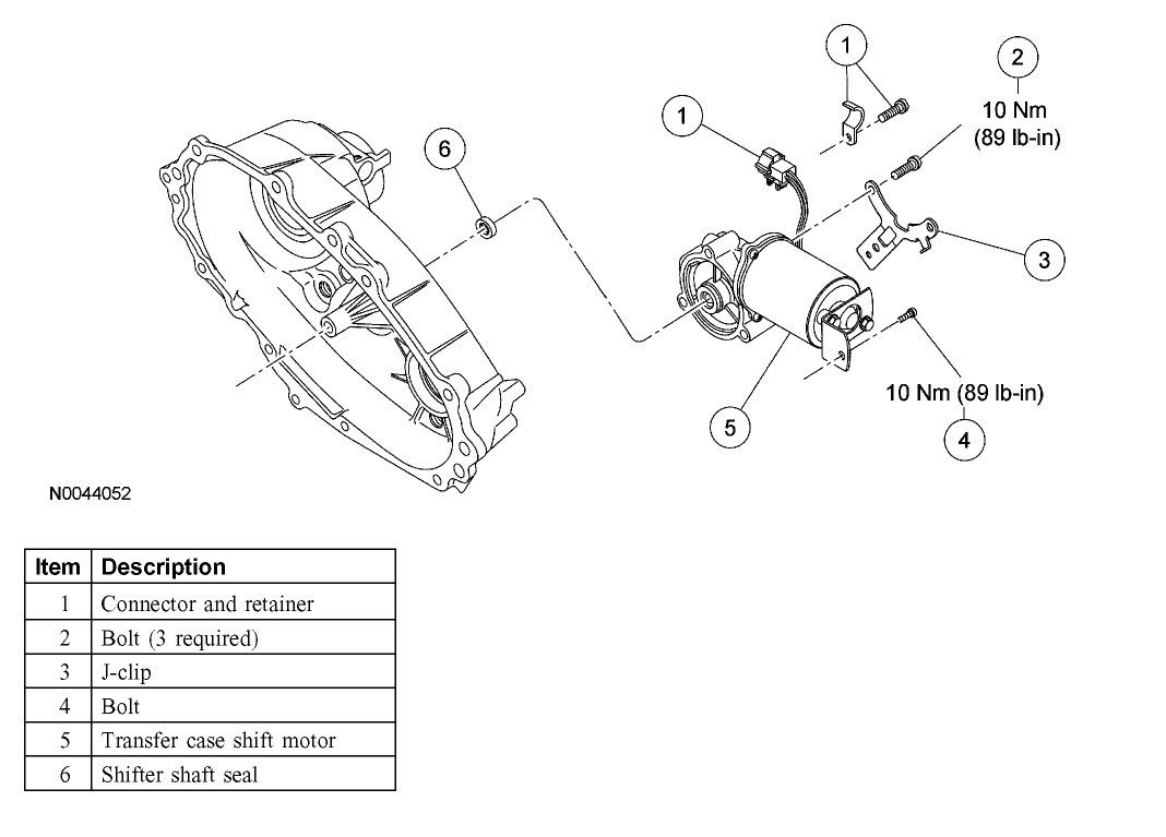

Four wheel low uses a different part of the actuator. I would start by replacing it because this part goes out sometimes. Below is a guide to help you see what to do. Also, if you could please take a quick video of the noise using your phone so we can hear and upload it to the site that would be great.
Nov 2, 2017 at 2:39 PM

Replacing the actuator fixed my 99 ranger, would sometimes to in 4 wheel or not. Hardest part was repinning the actuator plug, my actuator wires are split to two different plugs. But is quite doable.
