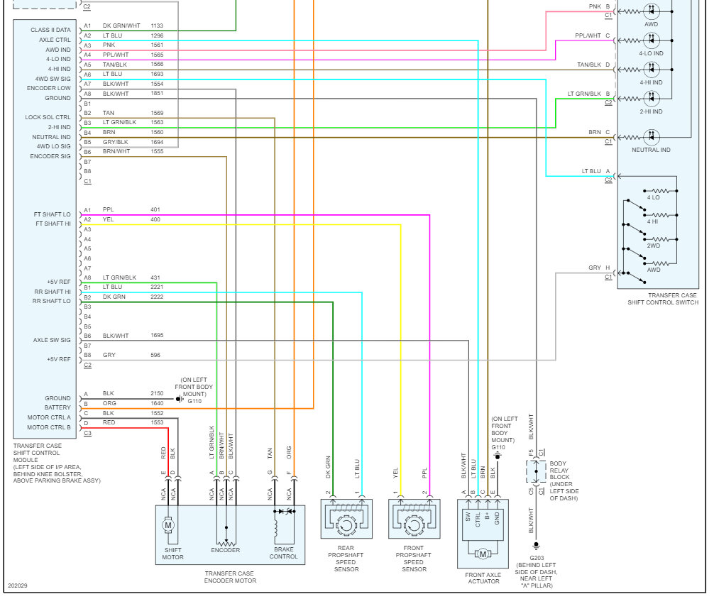

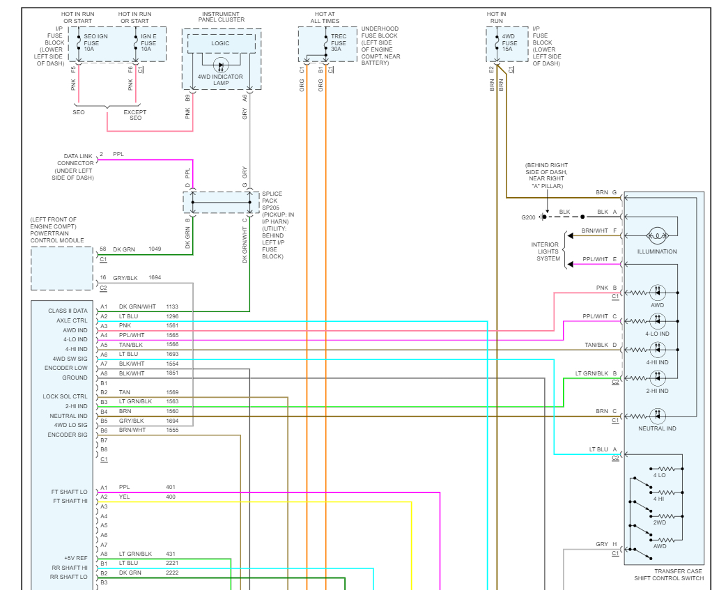

For years my truck will switch from 2wd to 4wh by itself but only when I'm braking (Periodically). It will not switch back unless I turn it off and restart it. I replaced the 4x4 dash switch. The 4wd works too. Again, it has been doing this for at least 7 years.
